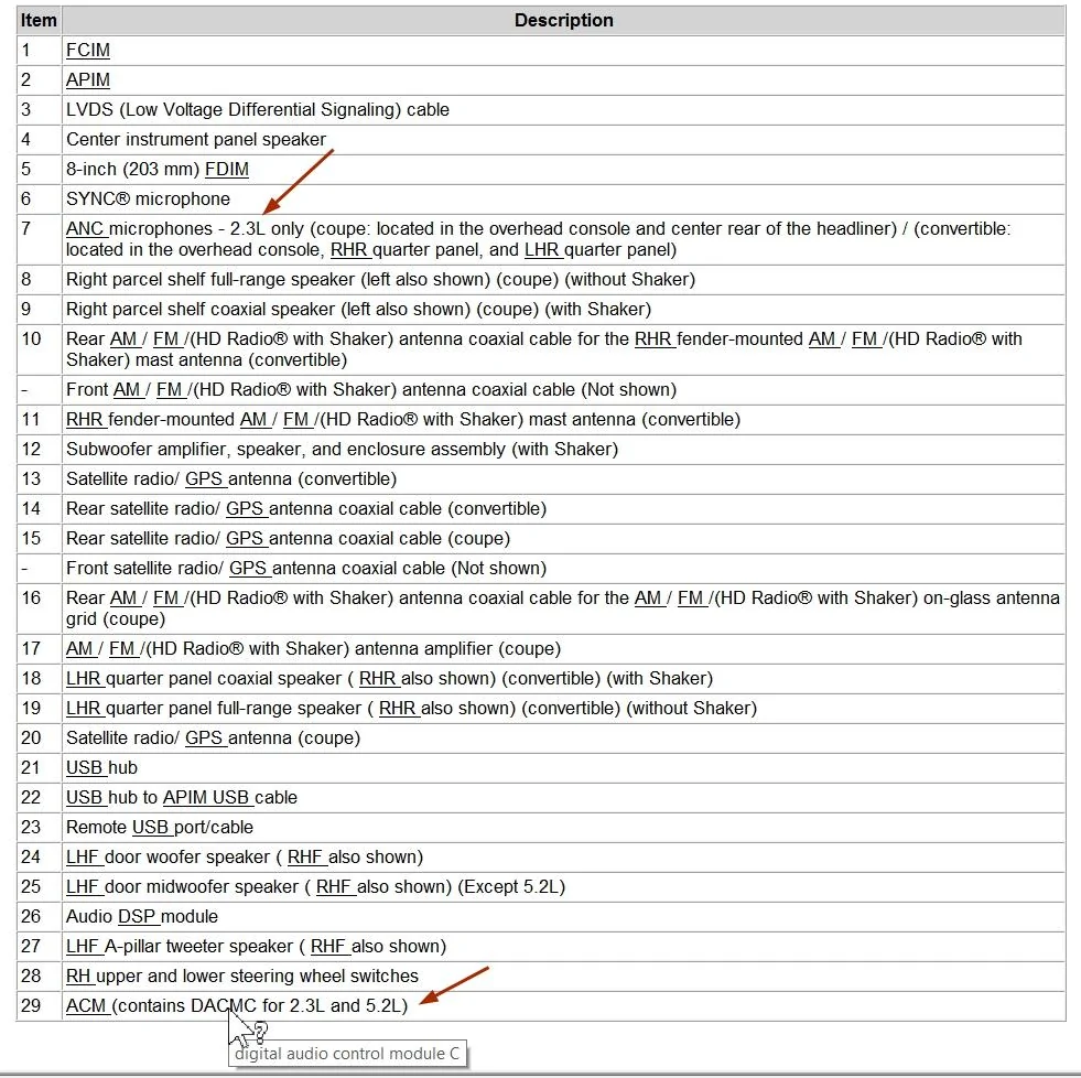

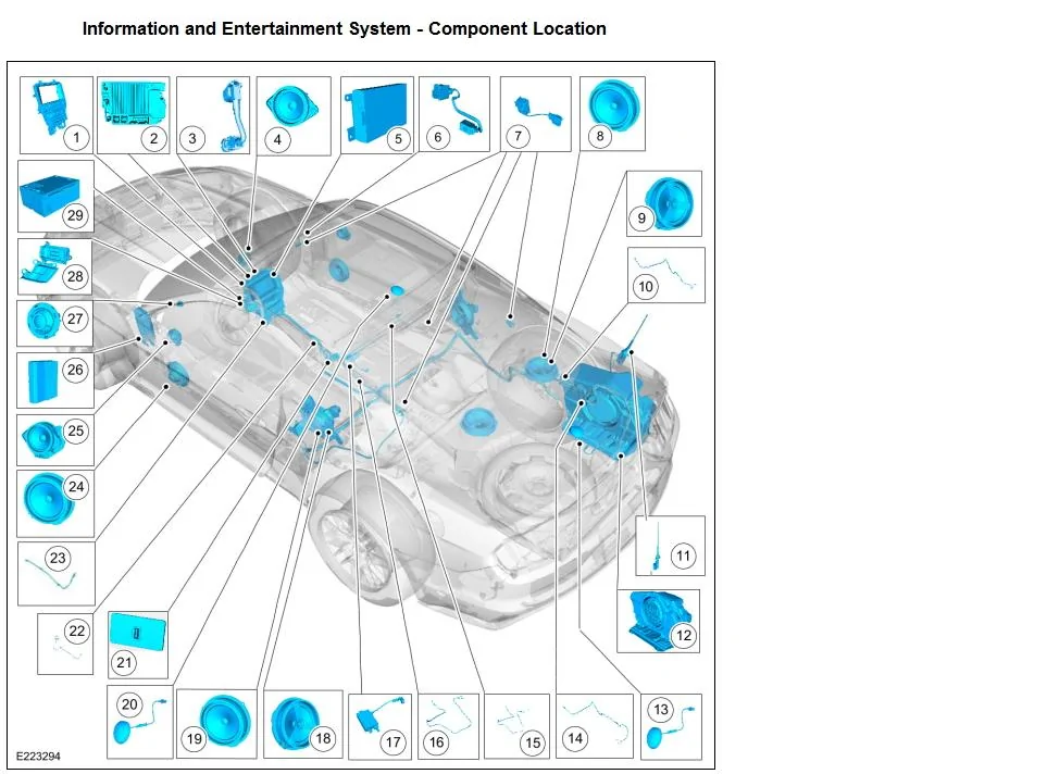

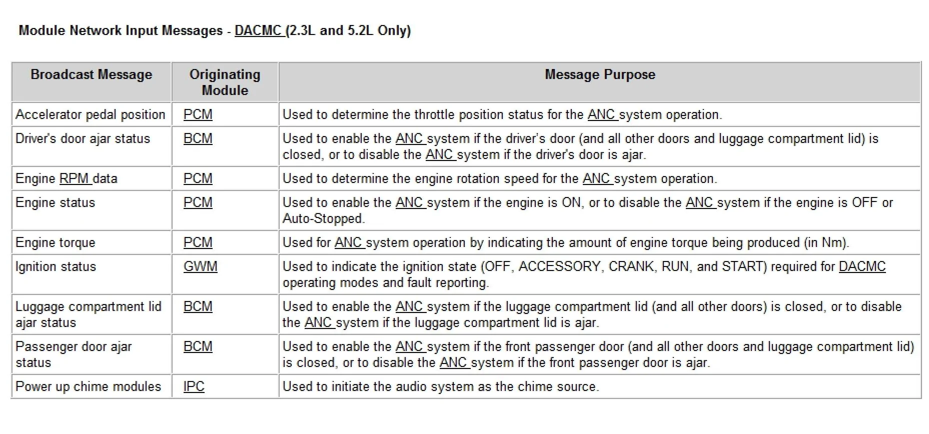

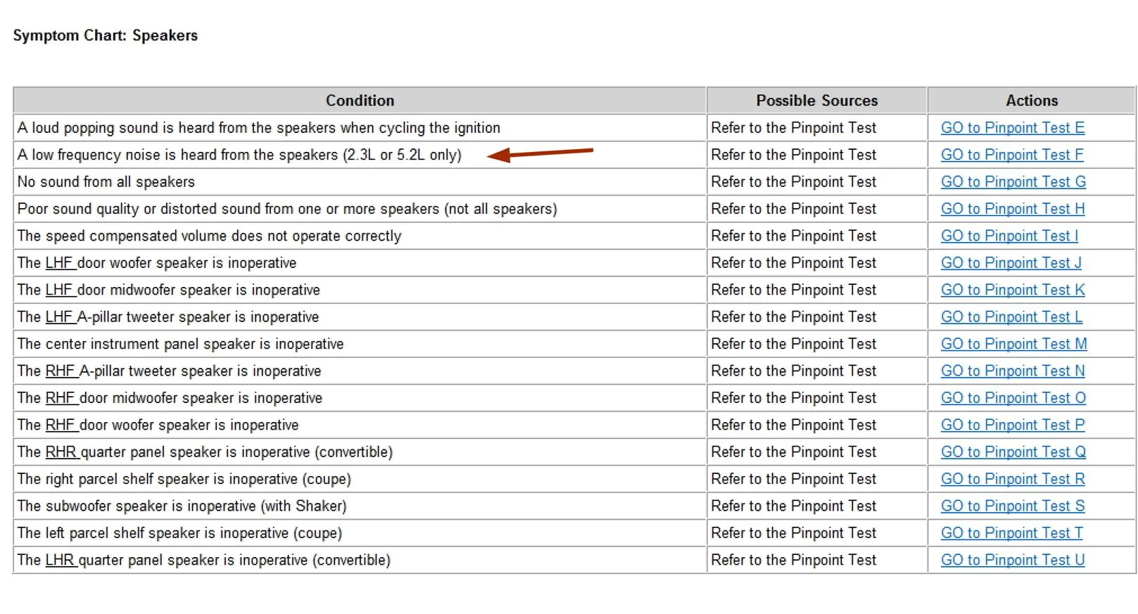

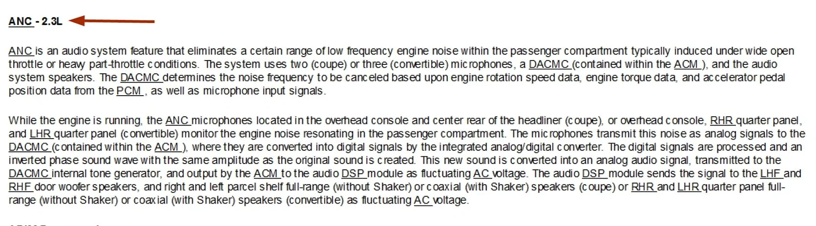

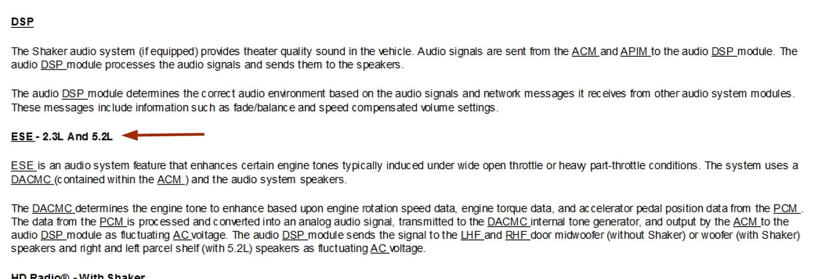

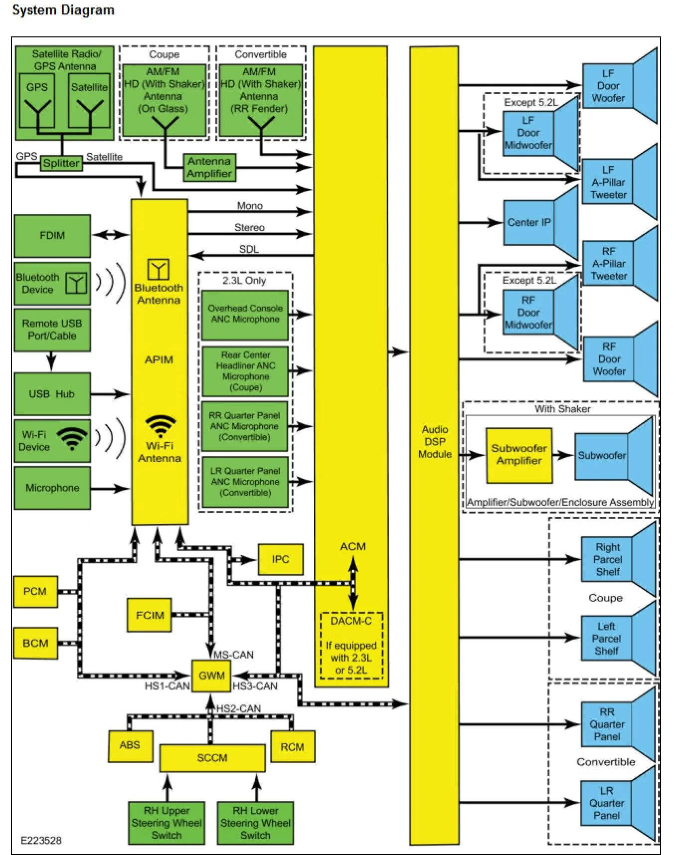

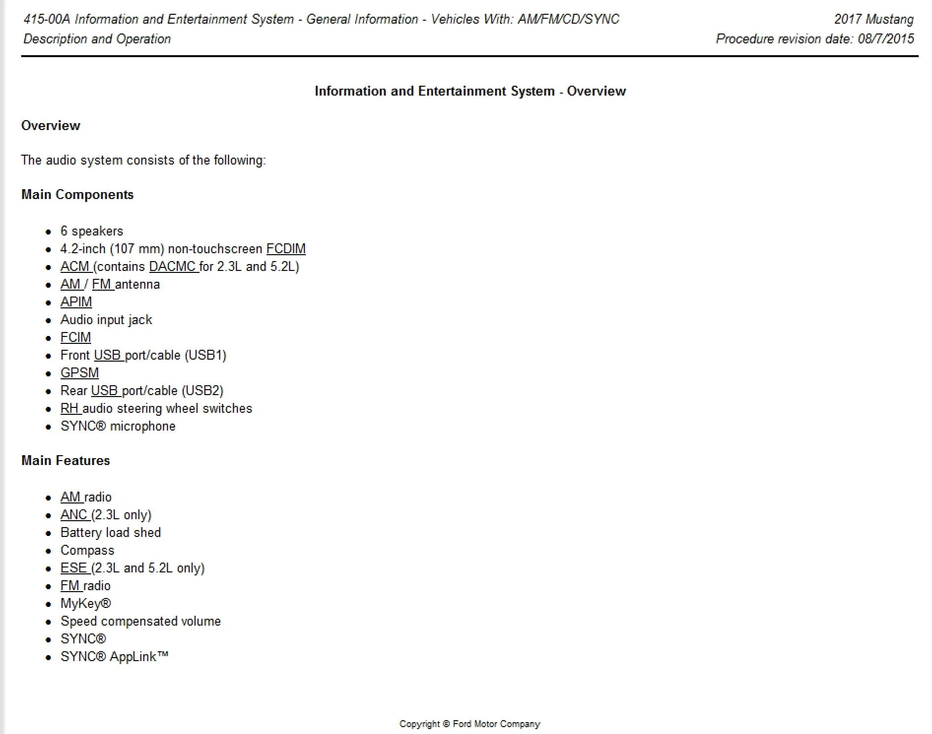

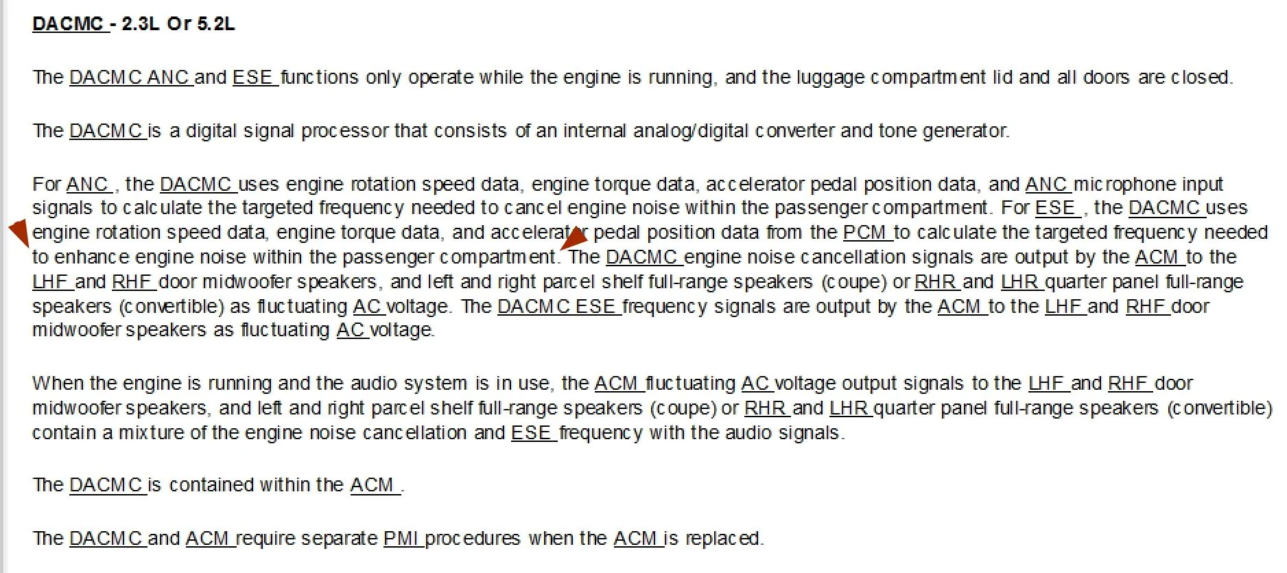

From the clips it turns out we have fake noise. The GT350 has it own unique version that no other mustang shares. After you view the clips is anybody sure we know what to shutoff?
Seems to me we need to disable the DACMC module which is in the PCM.
