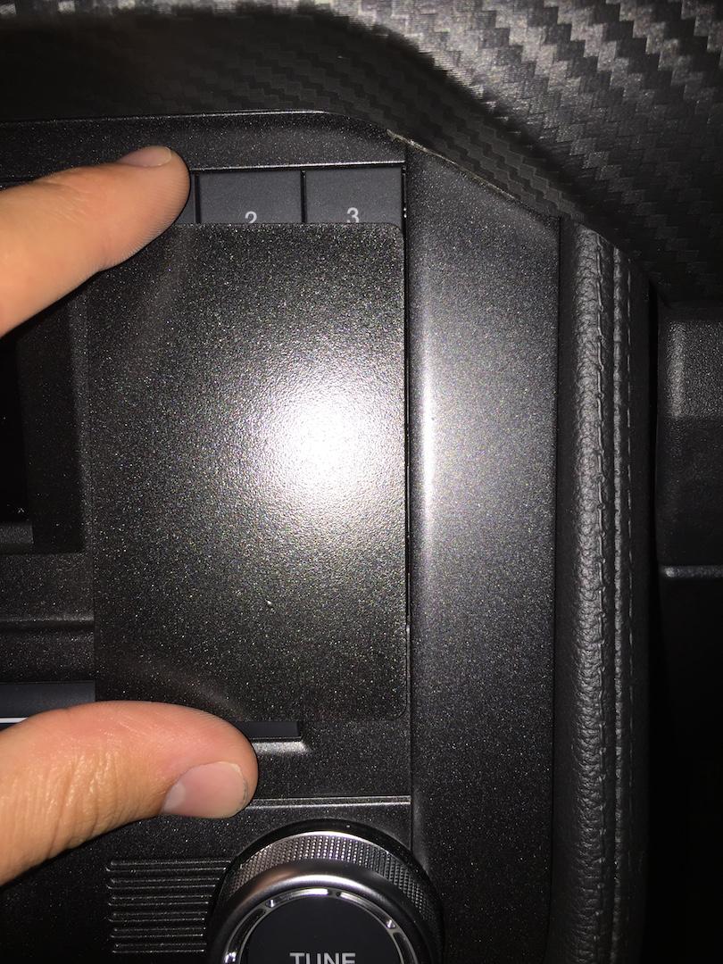

I believe I found the color for the bezel...

There is certainly room to place a 2 din unit where the factory 4.3" screen is mounted. The issue would come in the fact that on the back of the 4.3 screen bracket the sync module is mounted. You would need to relocated the sync module if you were keeping it. That shouldn't be much of an issue at all though. The center stack bezel is the major issue at hand.
I re-read the thread and saw you posted this, after all the research you've done does this still apply? If you remove the screen and sync module can you fit a DDIN stereo in it's place?

If it is a shallow 2din then yes. I don't see a full size 2 din with DVD player fitting though.
