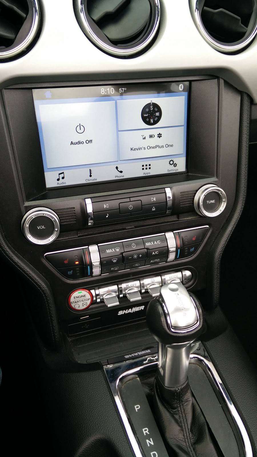

You’re working with this unit? And it has the the latest version? I had a 2016 that I updated and used the new hub from a Lincoln model and it worked. Are you plugging the phone directly into the new compatible USB block? Try an Apple/good cable. Do you see the option in sync settings for CarPlay?
https://www.ford.com/support/sync-maps-updates/

Yep. All the above. When I plug into the new hub (and I've tried two hubs) I get a warning of an incompatible USB Devise is plugged in. I even showed the dealer and they were baffled.
