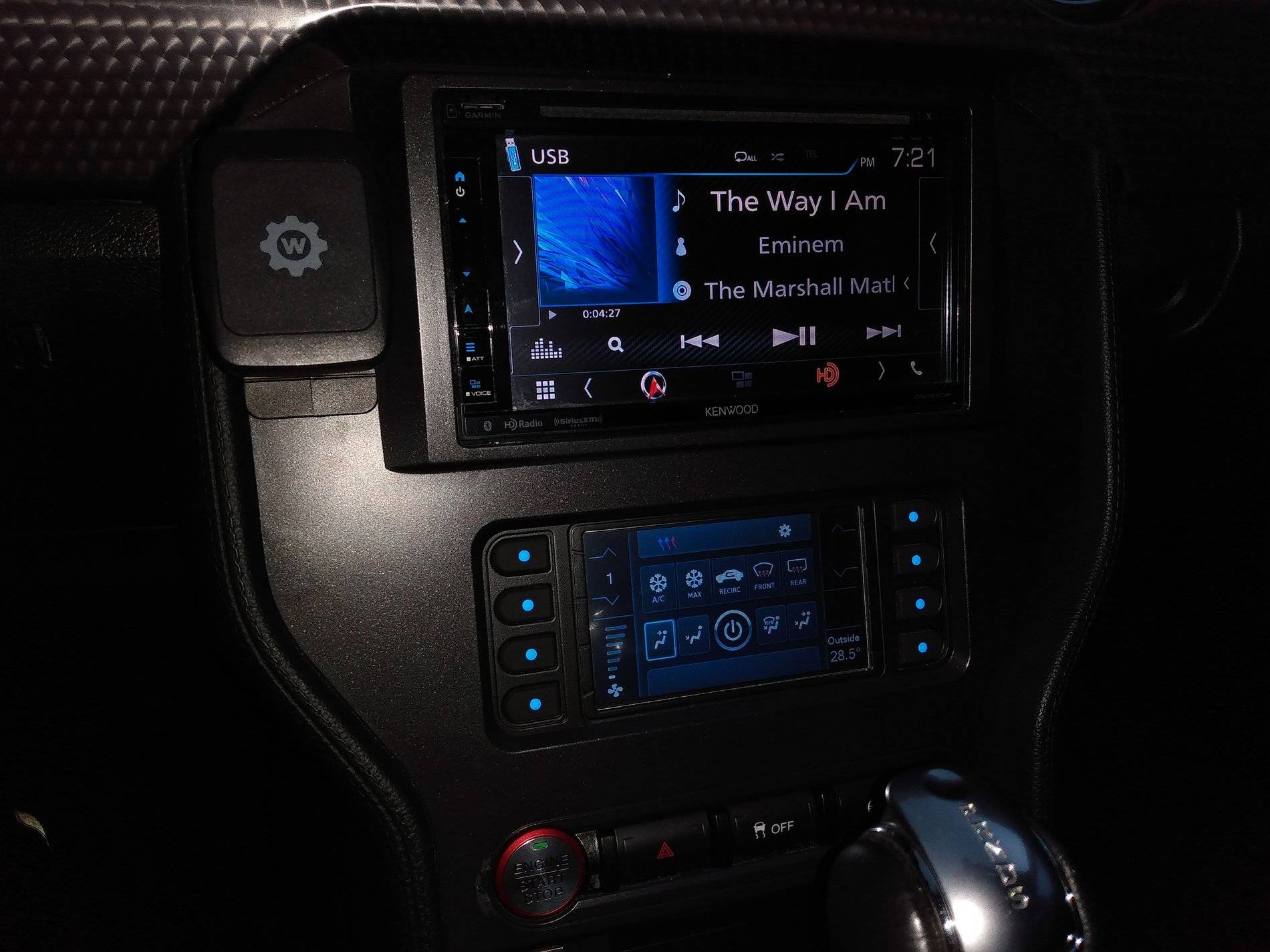

I've got the Kenwood NAV with the Metra turbo dash kit in my 2018 Mustang and they work good together. Kenwood unit has Android auto as well.

That looks very self made
