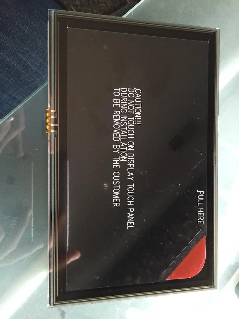

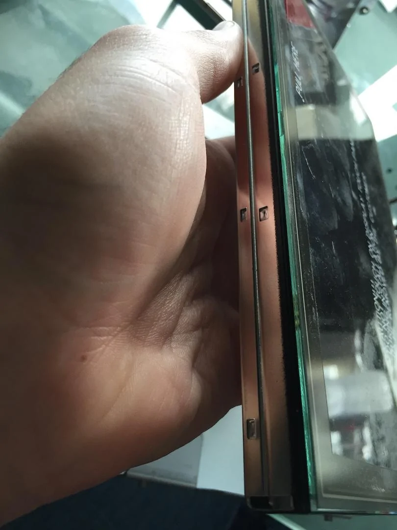

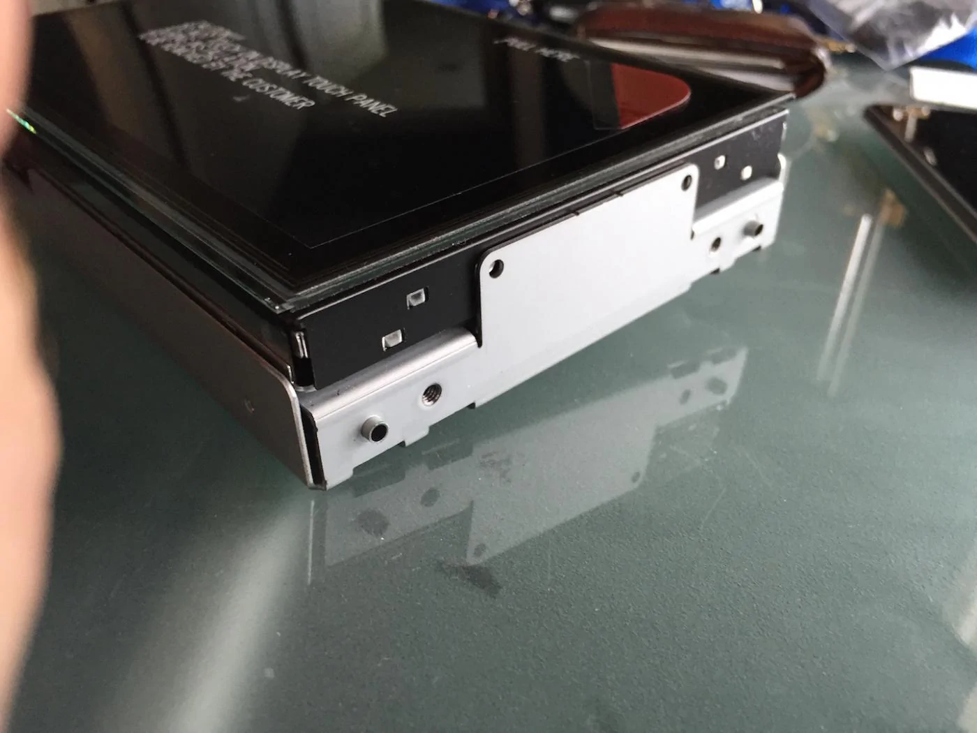

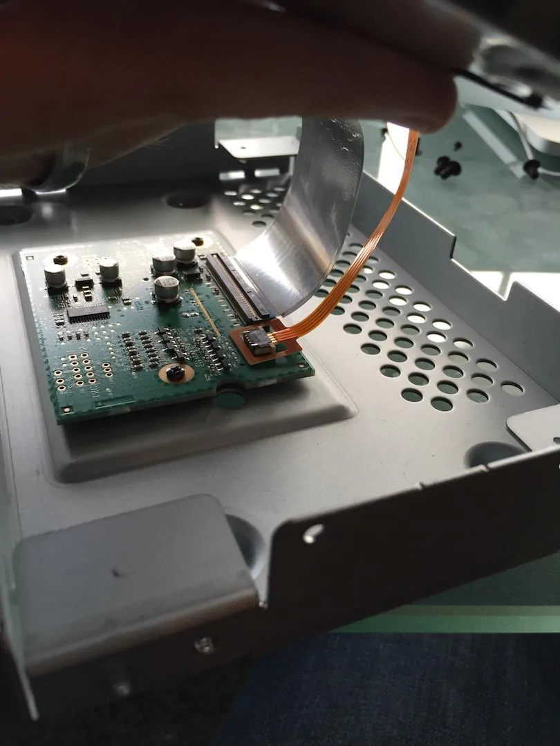

Well good news and bad news.... Good news is my screen arrived! And it can be dissembled to make the screen itself thinner. Problem is it is taller then what will fit... This means that the dash trim (with the 3 vents) will also have to be trimmed to accept the screen... There is a small chance though that there is enough depth between the trim and the circuit board to have it fit underneath Removing the requirement to cut the trim.. I am hoping this is the case...
Dimensions of screen (just LCD, Not entire metal case)
Height: 122mm
Width: 192mm
Depth: 19mm

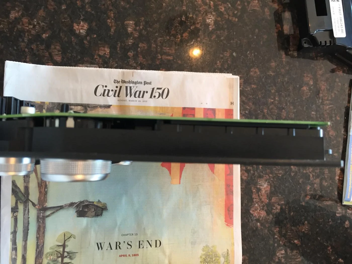

Hey aggieStang,
You have your OEM base bezel out of the car correct? could you do me a favor and measure the distance between the top of the bezel and the circuit board?
The area in this picture below.

Crisis averted I think!! Using a high tech :D paper depth gauge to fit between the space between the volume knob and center stack bezel I "think" the space between the circuit board and top of the bezel is 22mm. Just barely enough to fit the screen!! Need confirmation though with real measurements from a dissembled bezel.
This means that there will be no modification of the dash trim required.
