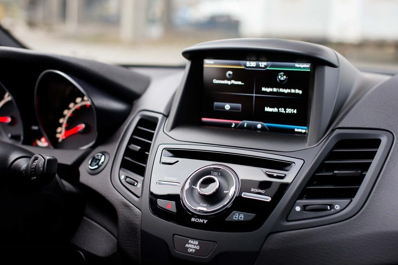

So it looks like the MFT in the Fiesta had this.

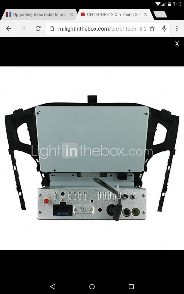

Question for you guys way more familiar with this than I am...
The pic is from the net buts its the upgrade for 2012- up Focus. Couldn't we just install this, since its separate units with probably just a rewire?
No climate controls, I know...not an issue.
Unsure about using or keeping Sync.
And would need a canbus, which comes with the system or available elsewhere.

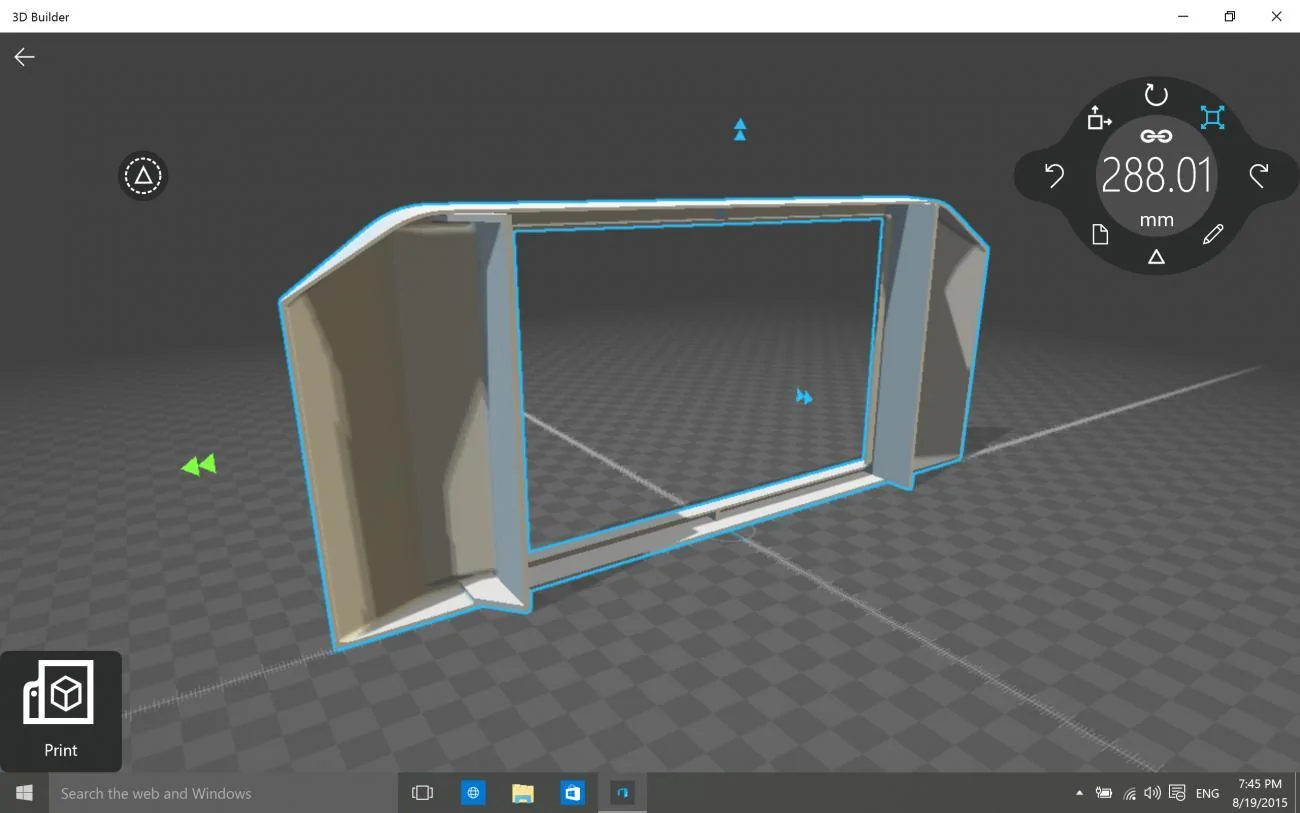

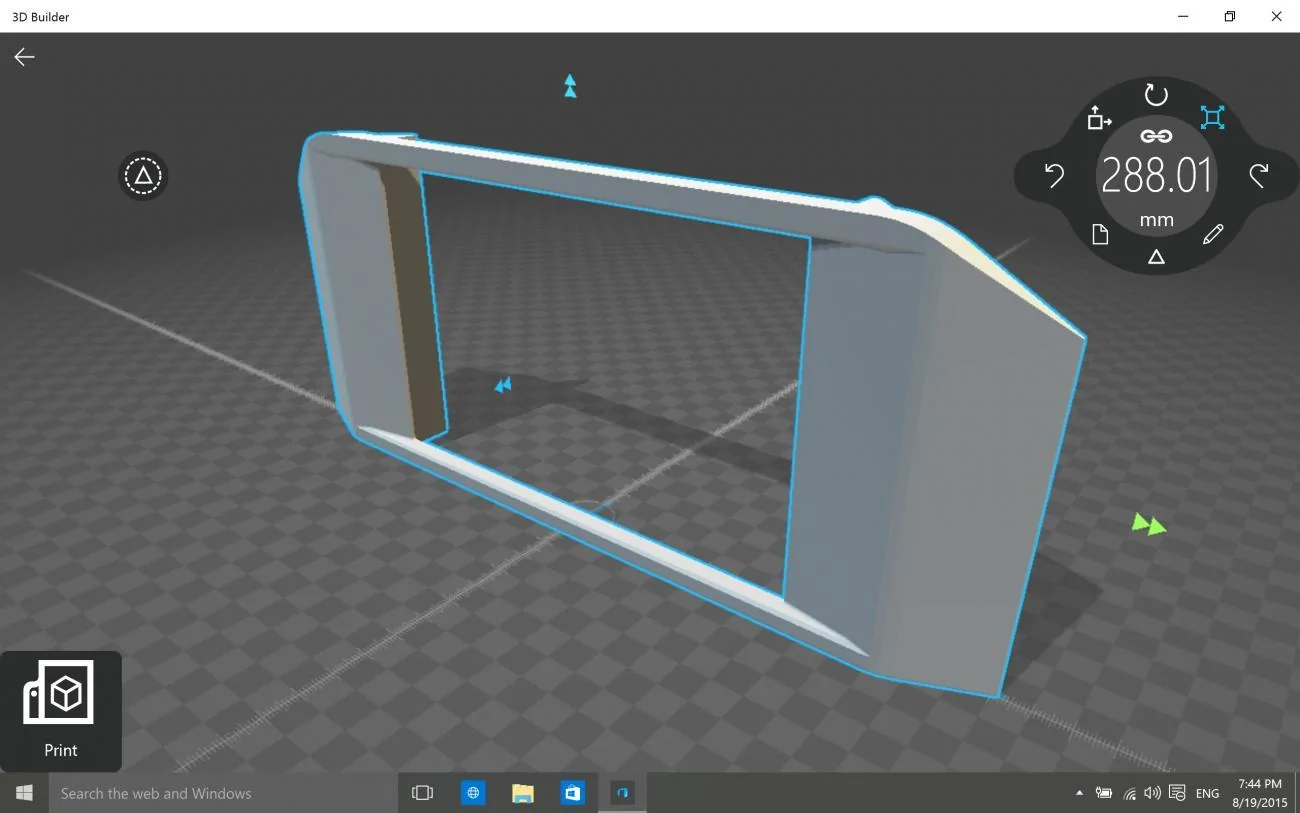

Got a bezel for the base model mocked up. It is not finished yet plus I need final dimensions from my screen which should be here tomorrow. From what I have been able to do (using my mother's Flex) this screen is gonna be one tight fit... I mean TIGHT.... But it should fit.
