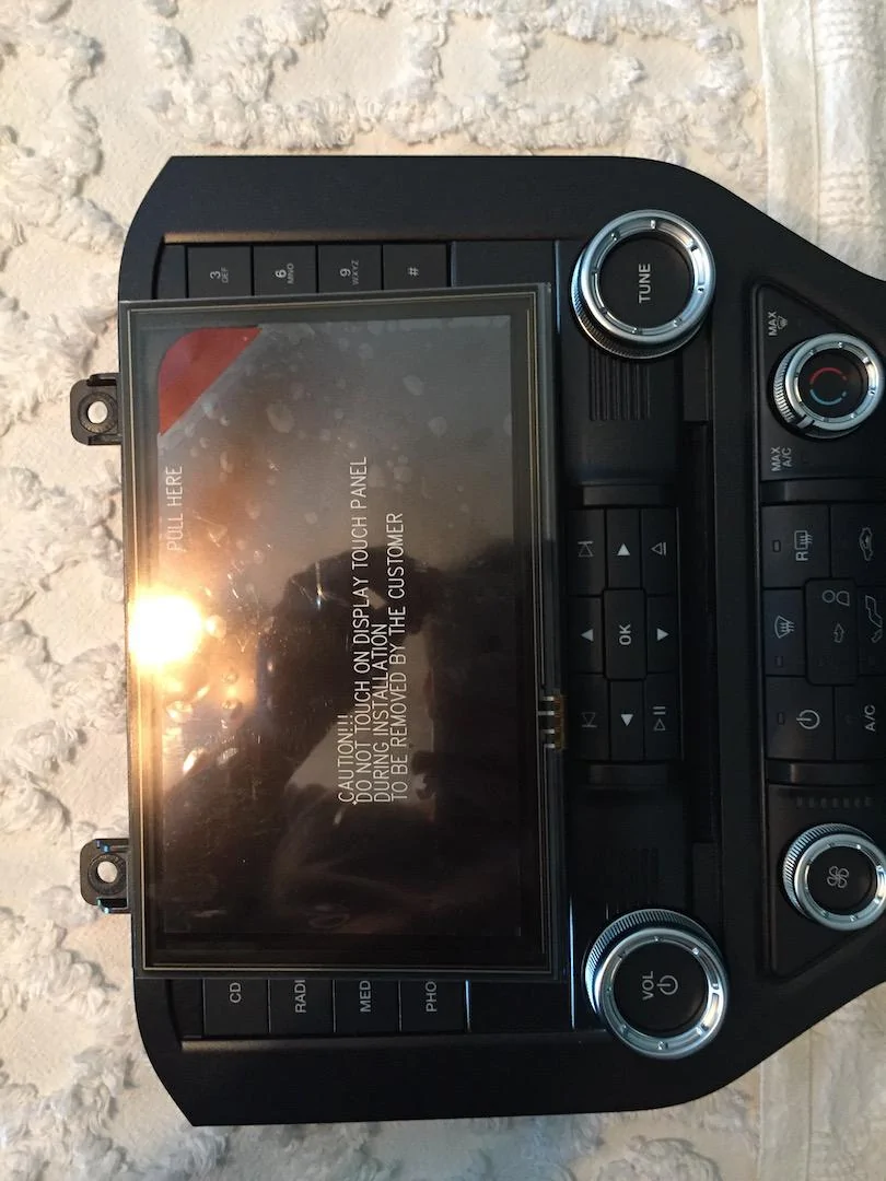

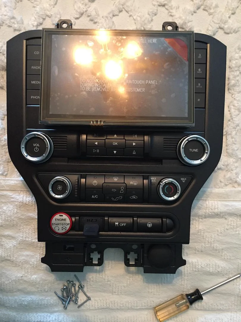

Just showing the general idea of where the screen is going in the bezel.

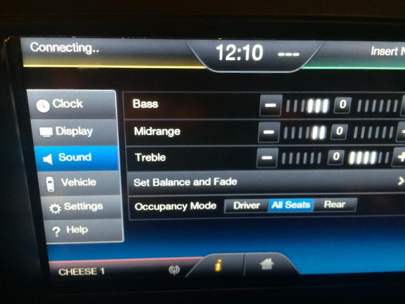

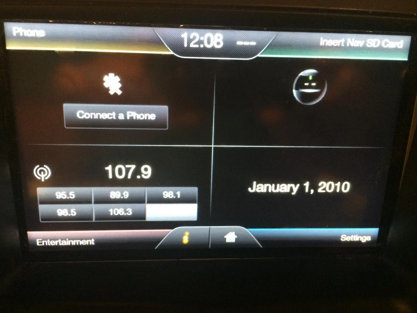

So an update guys! Been working with jmr061 on the programming side of the APIM. In just a few short hrs he made what I would like to call significant progress!! We think (need to install into a car to test) that he as solved the sound settings, steering wheel controls, and quite possibly the in motion issue. He also recoded the lower right quadrant to display the date instead of climate controls. He and I thought it best to just eliminate them. Some pics from his bench setup!

No clue... I do know though that it is not possible to touch the APIM programming with a normal VCM and OASIS. So if he is using a VCM then he has a custom method for doing this.

The date quadrant came from a fiesta MFT. Jmr would have to answer as to if it is possible.
