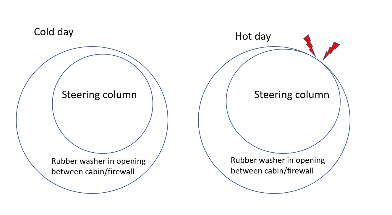

Hmm. I don't feel anything rubbing. What strikes me odd is when they have it on the lift with no stress on it, there is no noise. Once they put some stress on it, it makes the noise.
Same for me! On colder days if I just get out of the car the sound does seem to get better, which is why I kept thinking it was the suspension, until the stethoscope narrowed it down. However on a hot day the weight distribution doesn't seem to affect anything.
Also it is interesting, I think all of us have MY 2020s.
Also my thoughts on it being the subframe, or I guess the steering column itself being misaligned, this is what I was thinking visually; on cold times/days there's no rubbing/noise because it just eeks out within the opening. Then when things warm up and parts expand, the misalignment is revealed. Then again, this doesn't really explain why it only happens turning right. That's still the most bizarre part of this to me.

Ed,
Excellent analysis. Yes, I have a 2020 GT, California Special edition, automatic.
The reason the dealership replaced my EPS was I was also getting a clicking noise everytime I turned the steering wheel (hot or cold). They said it was coming from the EPS. When I picked the car up after it was replaced, I was surprised that the moan, whine, groan was still present. I also had to bring it back twice because the mechanic did not put one of the bolts in correctly in the subframe and the steering wheel was off-center by a few degrees. What a hassle! I contacted FORD customer service over the whole ordeal. They paid for my rent-a-car, one month car loan, and gave me a 5-year extended warranty. After all of this, I gave up fighting it.
Are you going to bring it in? May be the mechanic by you may have some insight. I already had it at three separate dealerships:(
