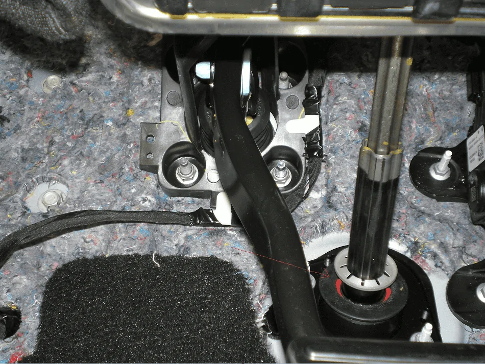

Does the groan y'all are experiencing sound like this?
Definitely gets worse in the heat; it was a sauna out there in the LA area today and it was a bit noisier.
A local performance shop already had me on the trail for the steering rack and my mechanic's stethoscope was able to pinpoint it a bit better.
For me it seems to be coming from this rubber part here (original photo courtesy of another forum member in a thread about the 2020 brake pedal bracket assembly recall.):
On it's own, if this is the case doesn't seem like a big deal. I'm more concerned that this means my front subframe, which supports the steering rack if I recall, is misaligned.
Wow! Yes, very similar. The warmer the car is and the rougher the surface, the louder it gets. I only hear it when it is in park and in slow, tight turns.
I'm not sure that your subframe is misaligned. It might be that part expands when it gets warm and rubs against the metal steering column.
