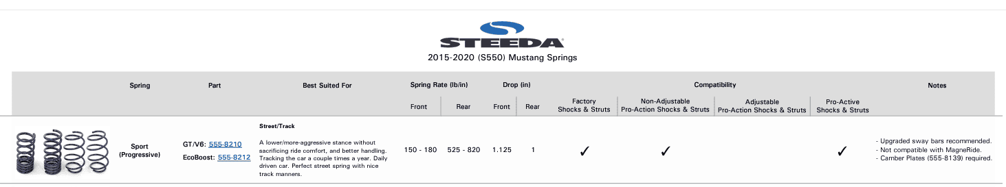

So, I have steeda version with progressive springs, I hear thumping noise on all four corners but only happens when I first drive, then it is fine. But my biggest problem is the ride quality when I hit a bump it just unsettles the car and gets some bounce as well. Does anyone have the same issue?
This should not be a characteristic of the Active Shocks & Struts with the progressive springs - we recommend the pair on our spring guide:
Please shoot me an email to [email protected] with your order number, make/model of your car & other performance parts & I will have our install team look into this.
I am sure we can get you squared away.
