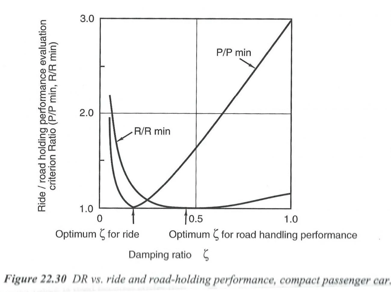

My guess would be that they don't offer quite enough damping for cases where best tire grip is demanded and ride quality does not matter. This is a 'percent critical damping' thing, and the short story is that a stiffer spring needs more damping just to stay at the same %critical damping than a softer spring does. Best grip comes at two or three times the %critical damping for best ride, so there are two separate factors each calling for greater damping.
This is only a typical critical damping graph, but it's good enough for illustration.
