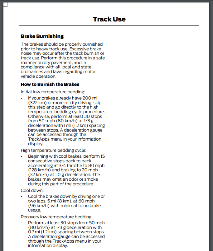

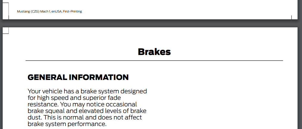

There is even something similar in your owners supplement :
WD :like:
I don't think I'd go quite as far as it does in the owners manual since you aren't taking it to the track. Like I said the 3 or so brake maneuvers I do when mine start squeaking takes care of it for a good 2-3 weeks before it starts happening again. 70-20 mph stops not super aggressive but harder braking and then I continue my drive either to/from work and the noise is gone :rockon: :like:
