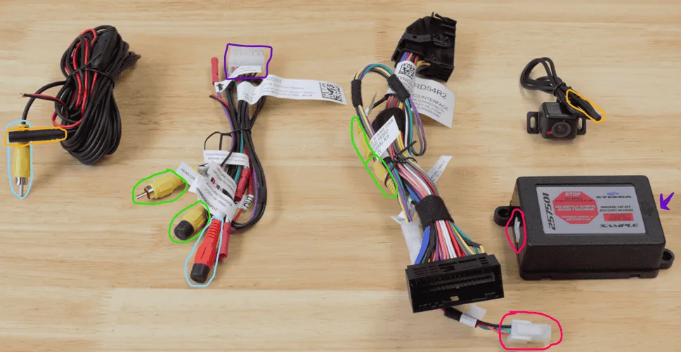

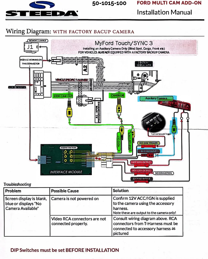

This is a part that was spec'd by our internal team to offer it through Steeda, this is what I can provide:
Both cameras will work, but you will have to unplug the backup camera RCA connector and connect it to the module to have the functionality of both cameras. The module allows you to switch between the two cameras. There is a modified harness included in the kit that will be used. The harness has all of the connections labeled.
I have highlighted the rear camera connections in green and the front camera connections in blue.

Thanks for the clarification and chiming in. Frankly the instlall seems pretty straight forward, although I find the instructions a bit messy.
