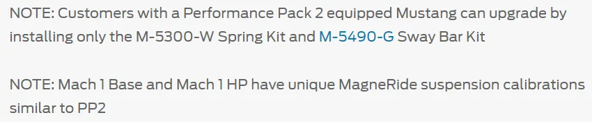

This kit has stiffer springs and sways than both the M1 & M1HP :
https://performanceparts.ford.com/part/M-9602-M
If I understand correctly, the VDM update that's included in the kit isn't required for PP2 cars (or M1 / M1HP) cars :
Maybe that's an option for you ?
