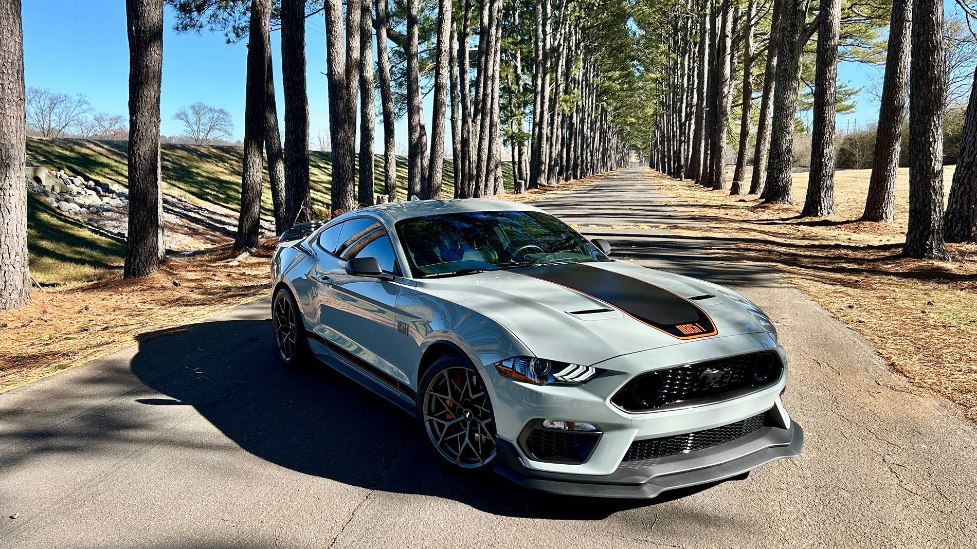

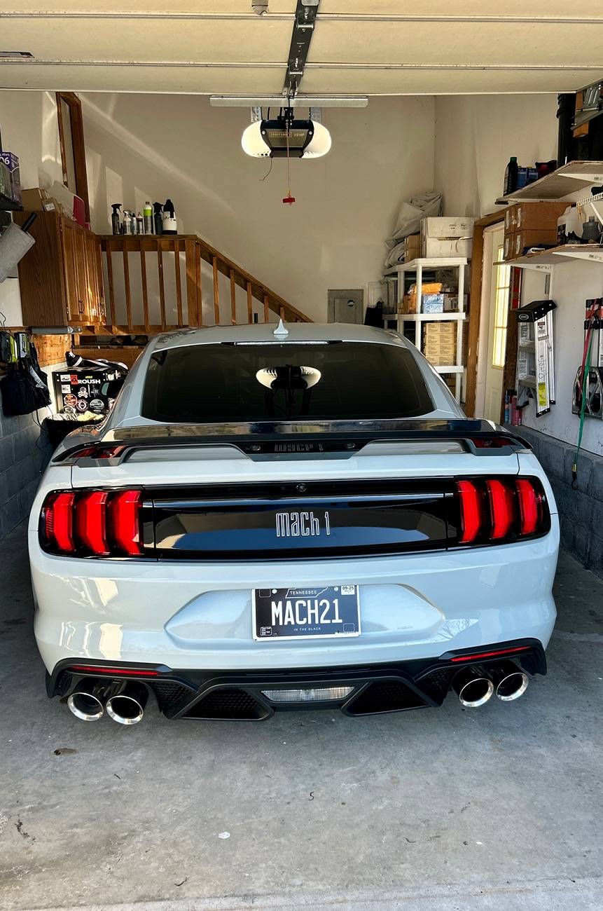

Fortunately mine was done when I bought it. I am switching the wing soon. The one on it now will be for sale soon if you don't have one of those yet. It's a Ford performance in gloss black. I have bought another one and having it painted this week.

Gorgeous looking Mach, exactly what im chasing. I do have the OEM wing and gurney flap but im sure you will have no issues selling it. Oh, I also got custom plates this year too. 23MCH1 is the best I could do, I am limited to 6 characters for veteran plates in NY.
