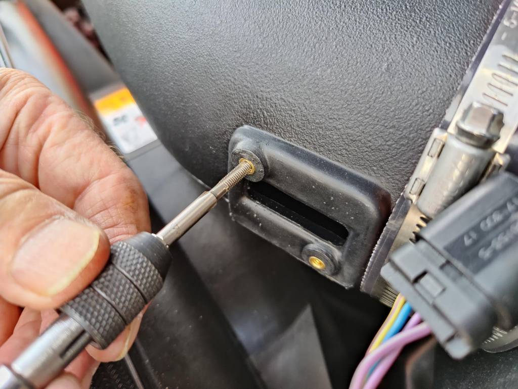

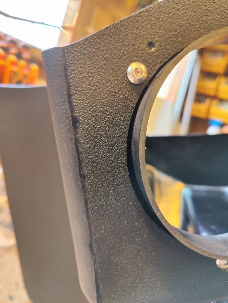

However my main gripe came when assembling the kit. The velocity stack fitment - the 3 holes just did not align. Not even close. I had to enlarge all 3 holes to allow it to match up. The main hole for the velocity stack is also poorly cut, I could have done a better job by hand.
The pièce de résistance - the MAF sensor holes on the intake pipe... which, were not threaded properly to accept the 2x small 4mm screws. When I first tried to scew them in I got 2-3 turns and then the screw would bind and start to screetch. Backed them out, and thankfully my dad had a die and tap set, so we tested the screws in the appropriate sized die and it threaded in fine. So went back to the holes on the intake pipe and threaded them again with the correct tap. Voila. They then scewed in successfully.

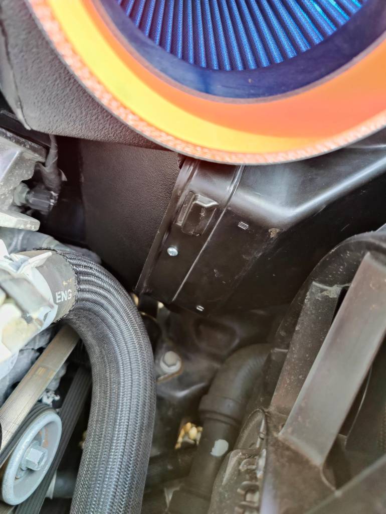

I also ended up having to put a self tapper into the air scoop where it joined the bottom of the Steeda airbox. Why? Because it would not engage the small tab on the airbox. It constantly popped off. Now we could argue that is a 50/50 issue. A poor air scoop design by Ford, but, perhaps Steeda can come up with a better way of clamping this to your airbox? It was impossible to fit the kit having it attached to the airbox. I ended up fitting the air scoop first to the front of the car, then the airbox, and then forcing them together before tightening the screw.
This isn't exactly a cheap kit, yet I've had to re-size the velocity stack holes as they were out by a country mile. Had to tap the two blind holes again because they were not finished. And had to secure the air intake scoop to the Steeda airbox.
