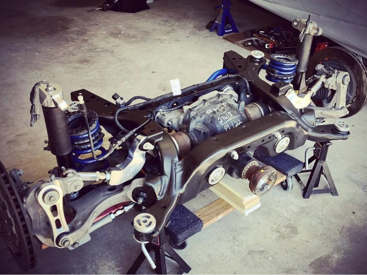

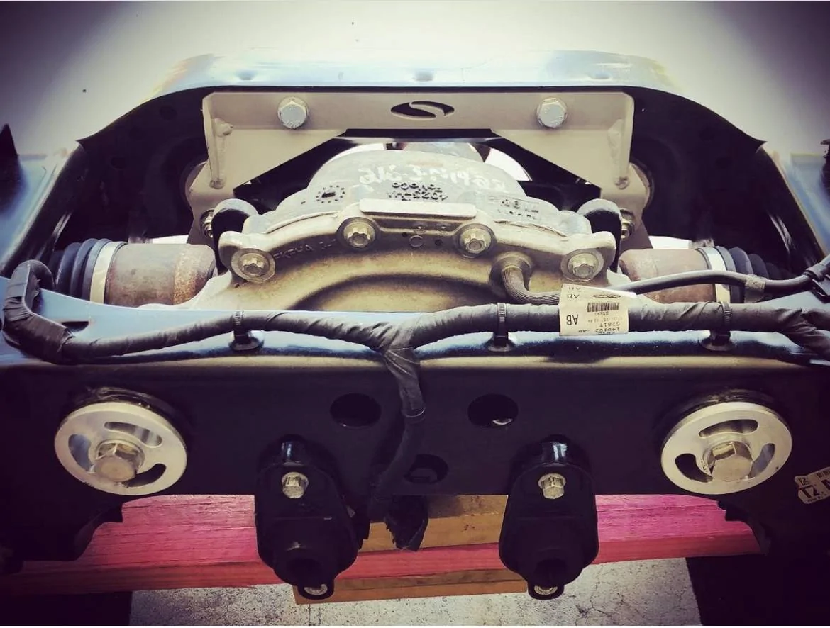

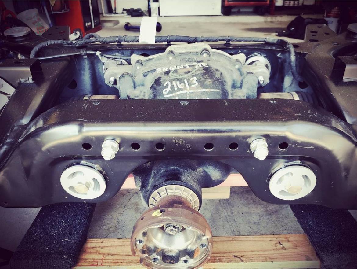

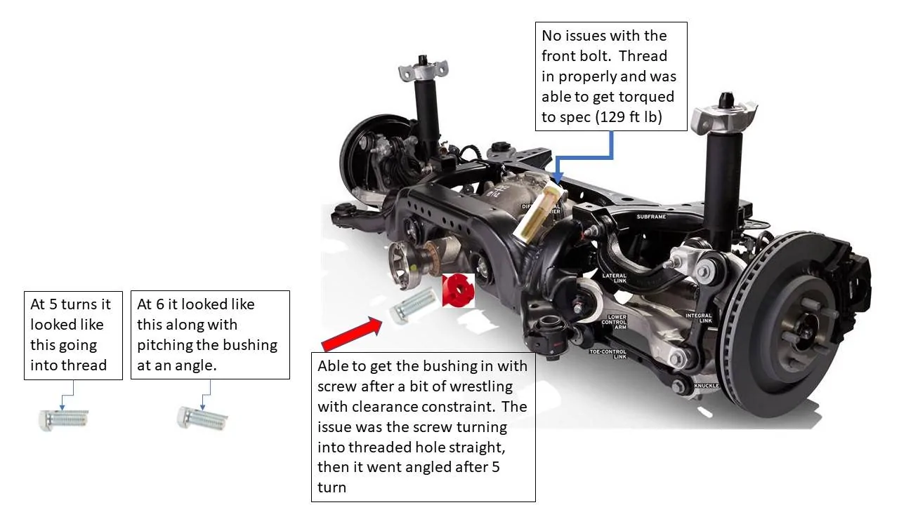

Hi all,
I attached a photo reference to make the story telling easy on what I experienced during my diff bushing install yesterday. The result at the end was having to reinsert the factory bolt minus the bushing. In short I got 3 out of 4. It was dark and this took way longer than expected using hand tools. The result with the 3 are incredible considering I have most of the other suspension mods added on (sub frame alignment sleeves, braces, billet inserts, rear sway, vertical arms). The 3 bushings removed the flex the diff had resulting in a light clunk during lights shifts or throttling on and off in traffic.
Case in point, hoping to get feedback on the following
A) Anyone else go through this?
B) Any opinion of running 3 vs. all 4 from a structural integrity or risk perspective?
Thanks everyone!
P.S. I did speak to Steeda (Thanks to Rod who was helpful) but confirmed they had not seen anything like this from their experience.
-Nick
Sounds like the bush insert was not in properly may have been wrong insert or needed turning to slip into bush.
Did you grease the insert. I know very fiddly job I dropped the whole sub frame to do mine. Having only 3 in might load up the bolts more. I've heard some have broken the bolts.
Especially if supercharged.

Hey Keefa....The bushing and bolt were fitted in...It was simply by turn 6 of the bolt the rotation of the bolt went into an angle pitch instead of straight through like my artistic pictures tried to replicate :) ....It seems I got enough direction and validation on what I suspected I may need to do. Thanks for being a great community!
