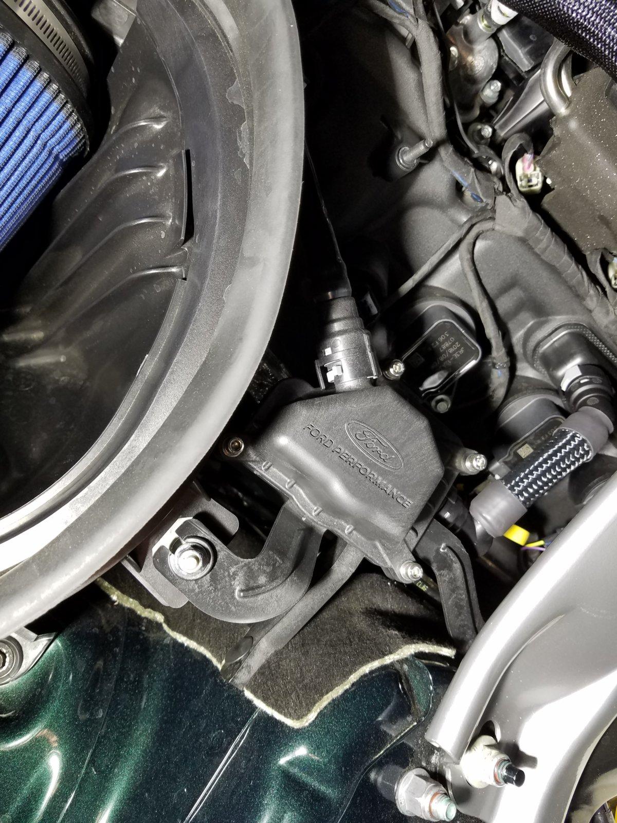

When I saw how much oil the passenger side catch can caught after only about a thousand miles I ordered a catch can for the driver's side. M-6766-A50S-Mustang Gt350 Oil Separator. Yep, I've heard they are optional as the passenger side of the engine seems to be the side that gets the most oil, but if the driver's side captures even 10% of that I think it will be worth it. The valve cover breather for the 5.2l in the gt350 is in a different location so the smaller of the molded breather tubes that comes in the kit won't fit. I used a small piece of 5/8" braided fuel hose that fit snug with 1" marine shrink wrap. The other side of the separator fits snug but will snap into place if you warm up the tube with a heat gun or hair dryer to soften it a bit.

They actually do make it specifically for the 18-19 mustang but in my case, I chose to use the existing one I had from the gt350 I use to own. The only difference was the mounting bracket for the catch can bracket wasn't made to work with the 18-19 mustangs so I ended up cable tying one side of the hose to the wiring assy over the valve cover just to keep it from moving as for the other side is a flex hose instead of buying another.

JLT has one but I don't recall seeing a FP one other than the one I installed. Since we have the gt350 intake it's a clean fit with only one hose needing tweaking.

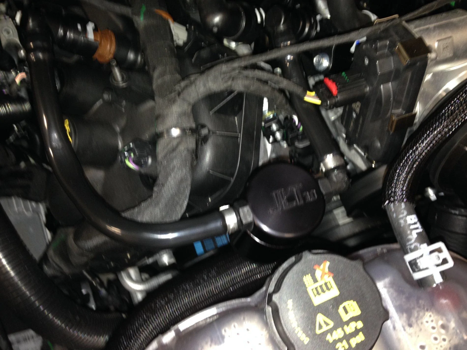

Have you checked how much oil you've caught on the driver side? I just installed the JLT on the driver side last night. Like you, I got concerned when I saw how much the passenger side collected in 2,000 miles (2.5 Tbsp.).

On the driver's side? That should only be an inlet for fresh, filtered air--you're getting that much?
Depends on how hard hes driving and how much track time he's had.
