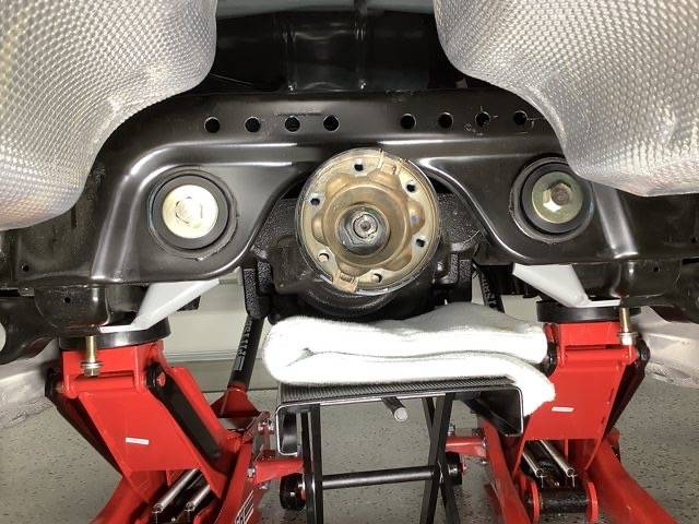

Hi all,
I attached a photo reference to make the story telling easy on what I experienced during my diff bushing install yesterday. The result at the end was having to reinsert the factory bolt minus the bushing. In short I got 3 out of 4. It was dark and this took way longer than expected using hand tools. The result with the 3 are incredible considering I have most of the other suspension mods added on (sub frame alignment sleeves, braces, billet inserts, rear sway, vertical arms). The 3 bushings removed the flex the diff had resulting in a light clunk during lights shifts or throttling on and off in traffic.
Case in point, hoping to get feedback on the following
A) Anyone else go through this?
B) Any opinion of running 3 vs. all 4 from a structural integrity or risk perspective?
Thanks everyone!
P.S. I did speak to Steeda (Thanks to Rod who was helpful) but confirmed they had not seen anything like this from their experience.
-Nick

I had the driveshaft out of the car when I did mine. I‘m assuming that anyone doing this with the driveshaft in the car will at least need to unbolt the center support bearing bracket for the driveshaft, in order to allow the ds to hang low enough to allow lowering the cradle to access the forward bushings. Yes/No?

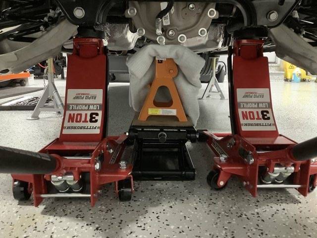

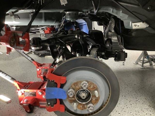

Did you drop the cradle to do the job? That’s what I did (using two floor jacks, a jack stand and scissor jack to support the snout on the differential) and didn’t have any trouble. I carefully lowered each side of the cradle a little at a time and kept the snout level at all times and then reversed the procedure to reinstall the cradle. This method allowed me easy access to torque all bolts.
It sounds like something may be in a bind on your car that’s causing the bolt to go in at an angle.

Hey bud! I had read your install in another thread or it may have been your original thread. You definitely went above and beyond for access ease. I didn't have enough equipment to pull this off, and bluntly may have lacked the patience. I went down the beaten path, and ripped up my hands working around drive shaft and mufflers. That said, I still made it work with enough space using a shallow socket to get my torque wrench in place to get it in spec. I'm starting to believe this was a pre-existing issue in the thread lining that having the original factory bolt threading all the way through from a side with no obstruction or constraint didn't allow the problem to materialize.
