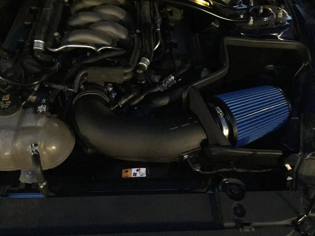

I got my JLT today. Next day shipping is pretty nice! Took me little more than an hour to install it, including disassembling the Steeda kit. The most difficult part was getting the air feed to fit the factory air duct in the grille, but once I did, I realized how flush it needed to be or should be. It also came with the new foam insert for the airbox.
I loaded up the tune and it fired right up like a champ, no codes or anything. It adjusted to the idle fairly quickly - within a few minutes. I took it out for a 10 minute test spin and all went well. Feels very smooth and no issues. The computer is still learning to it and the tune so I can't really do a fair comparison yet. But I'm happy thus far at least and all in all, not a bad way to spend a Friday evening off. Now I'm drinking a beer and about watch a movie.
