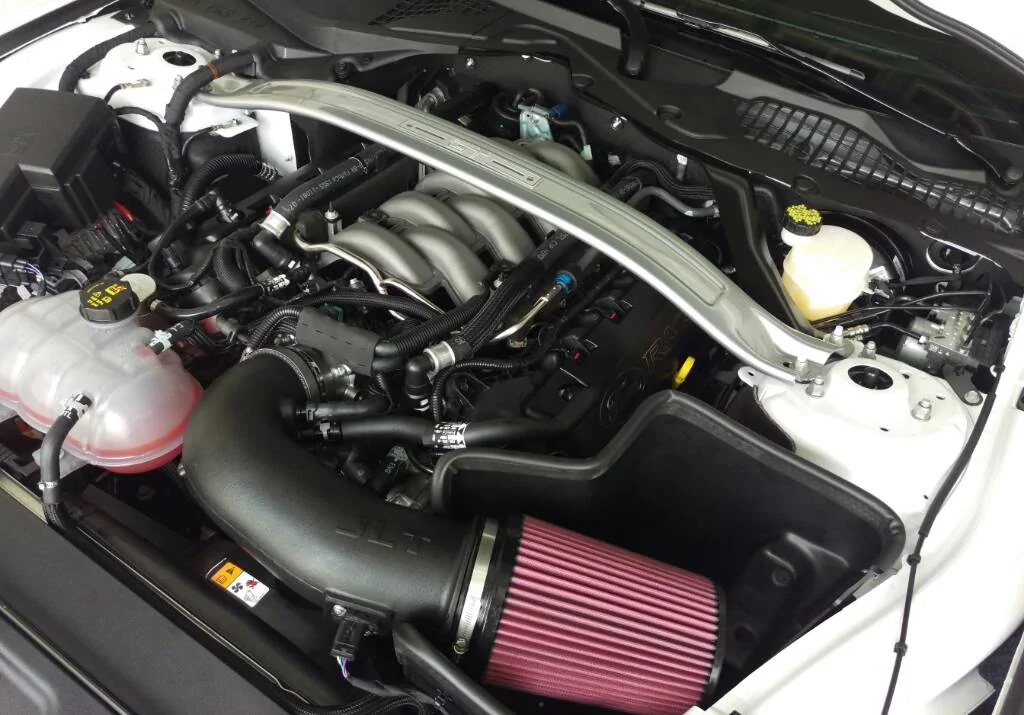

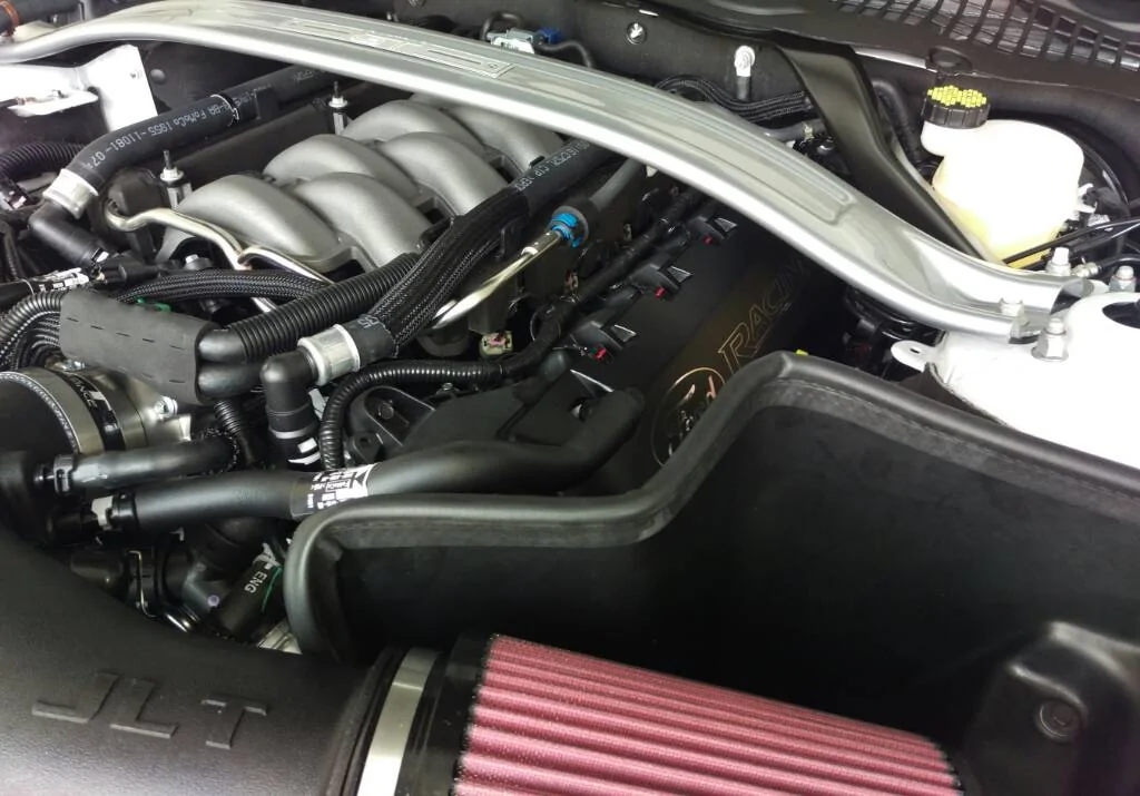

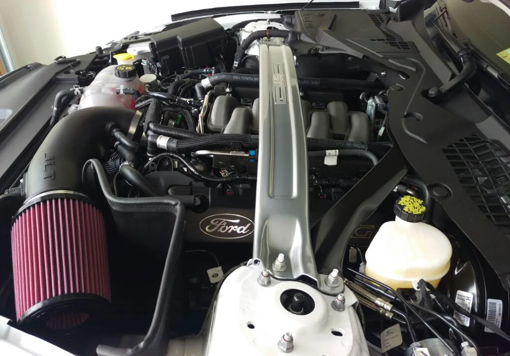

Got the JLT and installed with SCT X4 (thanks Hypermotive) and Lund tune loaded (thanks Beefcake and Lund)! Only performance mods so far. With no exhaust I must say the JLT sounds amazing. To bad once the Corsa Extreme gets ordered and installed I'll never hear it again. Very noticeable difference from the tune and intake in the performance and responsiveness and today was very hot and humid. I will say this about the people talking about increased intake air temps. I watched them before and after the intake install. It does appear a few degrees hotter than the stock air box but like others mentioned I feel the added power from the increase in air flow would out way the few degrees of intake temp at stop go traffic. Also I must mention comparing these intake temps on both stock and JLT are noticeably higher than my 2013 with Airaid MIT and Roush airbox by an average of 5-10 degrees. Haven't done any highway with the JLT yet but with my 13 setup I was always 1-2 degrees colder than ambient. I have yet to see the 15 colder than ambient while cruising FWIW

Thanks for posting, I'd imagine your IAT or ambient air gauge isn't 100% accurate on the 2013. It'd be impossible to get colder then ambient air as that's what it's getting fed! :)
Different grills on the vehicles will effect your airflow too, I'd recommend opening up the few honeycomb on the stock 2015 Grill that are blocked off. With our Lethal performance grill delete we see 3-4 over ambient at speed.

Yeah I had a CDC upper in my 13 and I'm sure it had a lot to do with it. As for the reason the temps were under ambient I have no clue. Guess maybe something could have been broken. But seemed to be accurate any other time. It was only ever 1-2 degrees colder on the highway about 70-80 mph.
