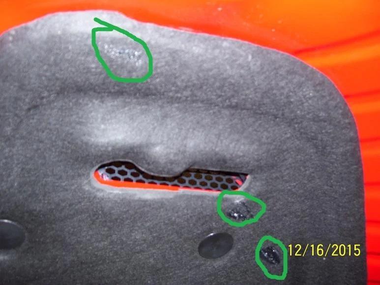

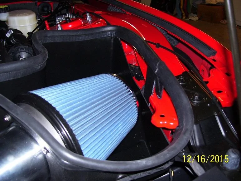

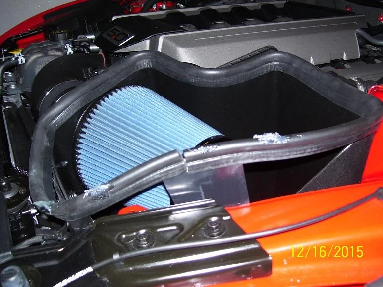

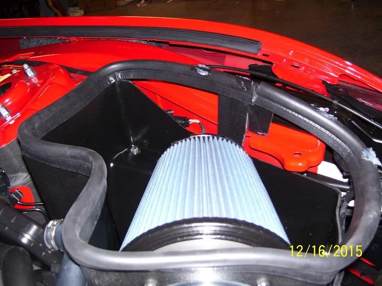

Knight5.0 I also sealed up around the velocity stack to the box. I had big gap at the top and bottom. Sent from my iPhone using Tapatalk[/QUOTE said:
There is also a very large gap in the front and drivers side that would help very much to close. Doing a different approach for sealing to hood, finally got the right distance to get the CIA to seal lightly against the hood the last pic the grease just touches the hood. I dabbed some along the seal, now I have to make the insert to raise it. This time of the year not much time but will get it done soon I hope.:thumbsup:
Could make some money selling this when its done. Looks promising

[MENTION=18602]Stang Racer[/MENTION] I'm very interested in what your final mod to get the CAI to seal better against the underside of the hood....from looking at your pictures looks like it will be a DIY'er. Keep us posted!
