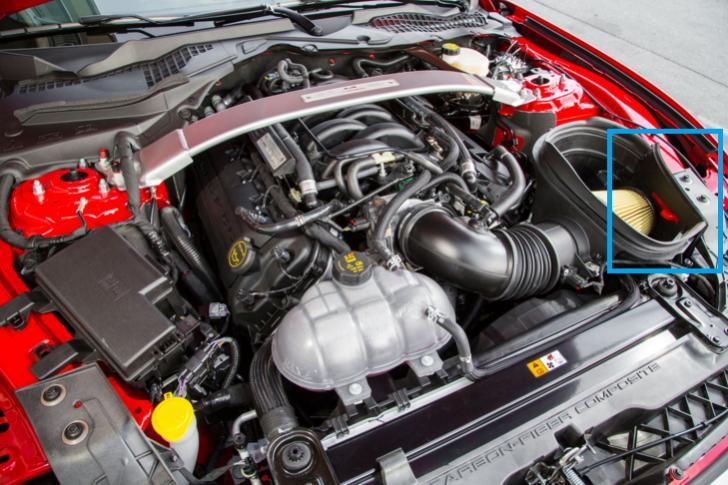

I was wrong about the gt350 intake! It looks like totally sealed, even from the right side as you can see in the picture.
Very nice that is exactly the problem area I am trying to seal off:headbang:
There is one problem in the gt350 intake though, if i m not mistaken, the vent is located in the front center of the hood not the sides as on the gt! How in the world, the hot air is going to escape between the intake and the hood?

If it's sealed against the hood there's no way for it to escape...so in theory the only air entering the intake should be through the snorkel mounted to the front grill.
Yup, it is assumed adiabatic conditions even sitting at idle, at stop or traffic, which is not going to be the case. If the car had a vent there though, it would be great!
Maybe we should actually try to seal the box completely to the vent instead of blocking it with a cover!
Stang Racer do you copy? :gossip:
