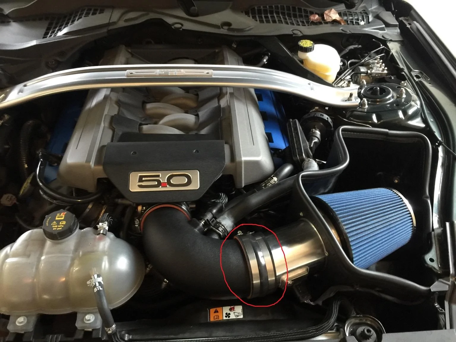

Installed it yesterday... putting the box had me frustrated because I couldn't get the rubber piece in the bumper to line up.

Have any of you had issue with fitment in the area circled below? I feel like the plastic piece isn't perfectly lined up with the aluminum tube the MAF sits in... It's hard to explain but it comes in at an angle.

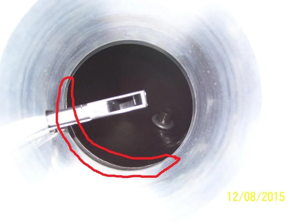

Question
This is a pic from inside the best I could get it to line up:shrug:
Question
http://i.imgur.com/7119fRw.jpg[img][/quote]
Yours looks a bit more tweaked then others that have installed. Maybe try with the boot at the tb and try adjusting there then try the the stack to the tube boot again.
This may help on the air duct to bumper
Post #536 & #539:thumbsup:
Question
That's why you have a silicone coupler; it doesn't have to line up perfectly (and doesn't).
Question
I had the same issue

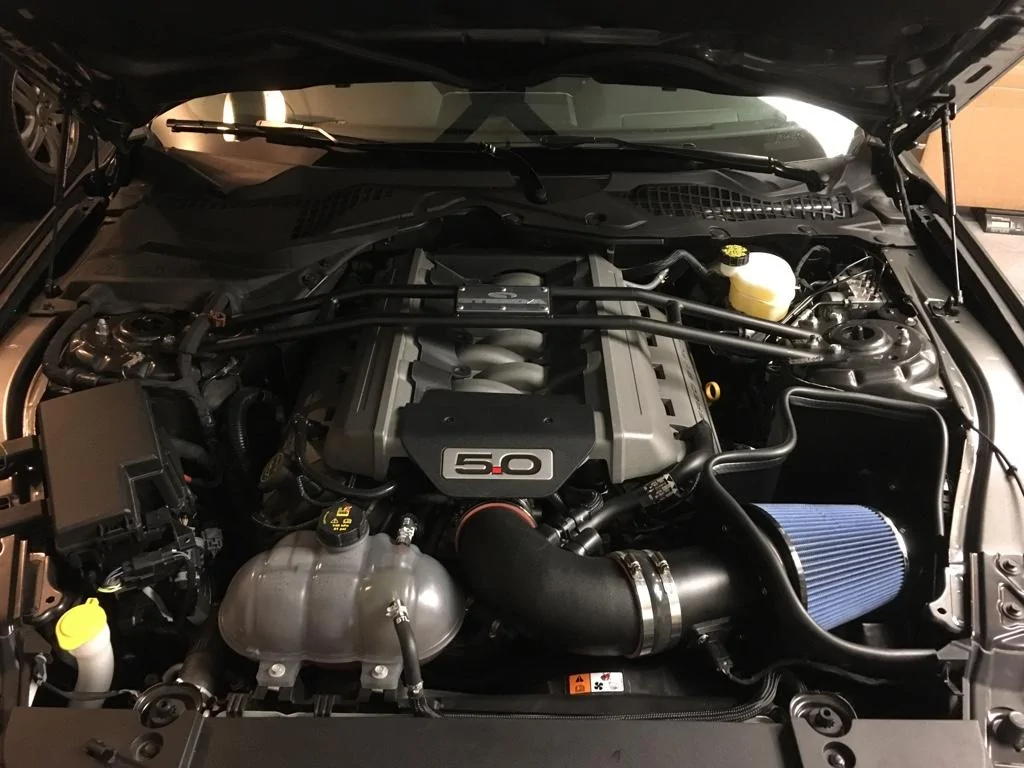

Plastidipped mine black before install.
Steeda did a great job on this intake.
