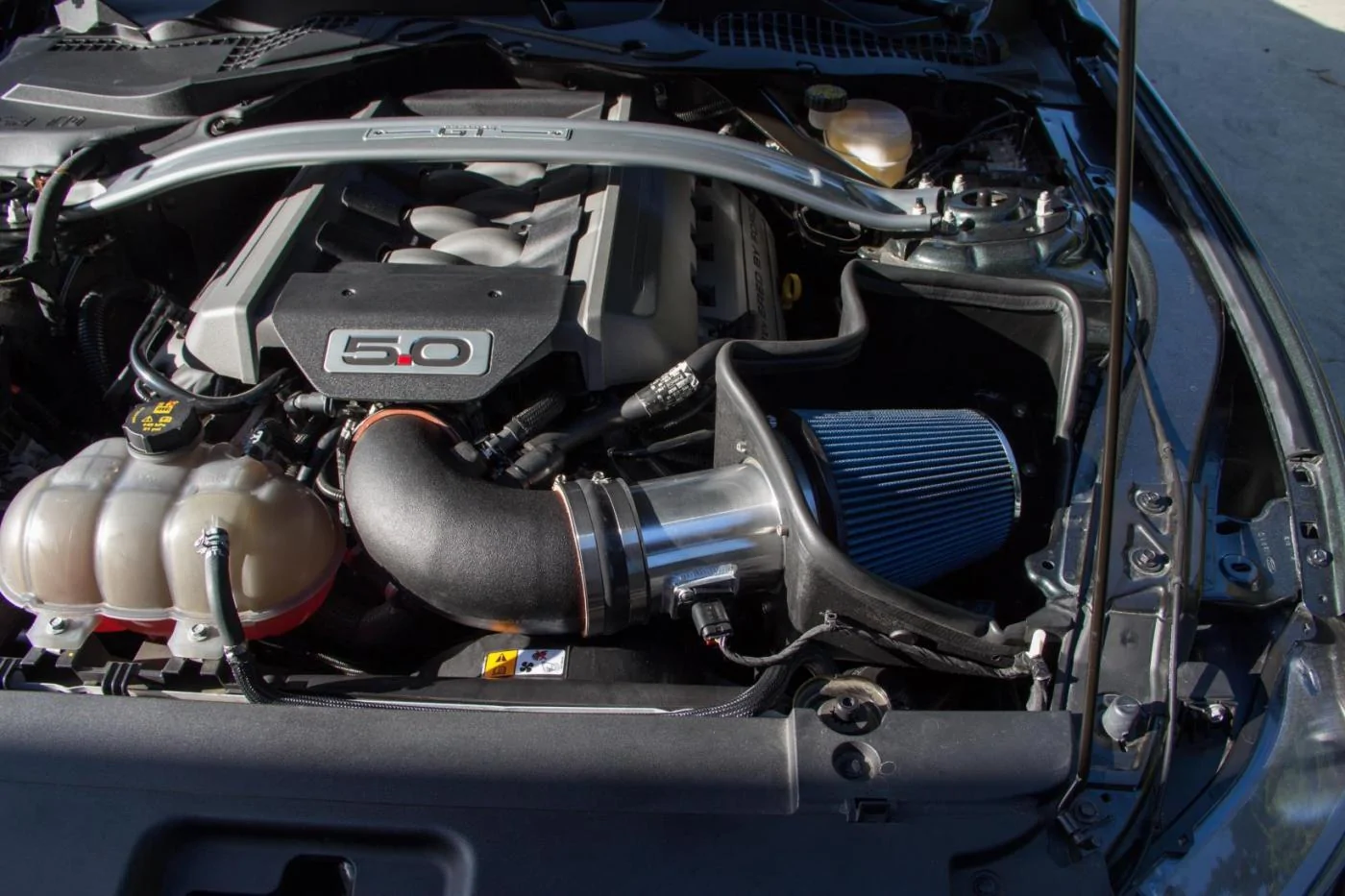

Good new everyone! As some of you know I had issues with the steeda box pushing my hood up at the driver front side. it's now fixed! Steeda got me a new box!
The new box helped! The slight bulge is gone on the front driver side! Also something about the new box in general. It went in without a fight compared to the 1st one.
It's going to be next to impossible to show this but the new one is BARELY shorter than the 1st one. there is a slight bulge you'll see like it wasn't cut evenly across on the first one right at the left corner in the pic. the 2nd box is a flat straight cut at the top at that corner. I believe that is what was throwing everything off. I mean i measured it on both and the old box is slightly taller at that corner as I expected. It's such a small difference it's ridiculous but I guess after then putting the seal on top of it, it just made it even taller.
thanks to steeda and [MENTION=10893]David@Steeda[/MENTION] for getting me a new box promptly!
new one:
old:
I need a favor, can you check the screw halls for the MAF if they reach all the way to the inner diameter of the restrictor or the stack?
I used the original screws for the MAF housing, they were longer but i wonder where they stopped after the engagement! Thanks so much!

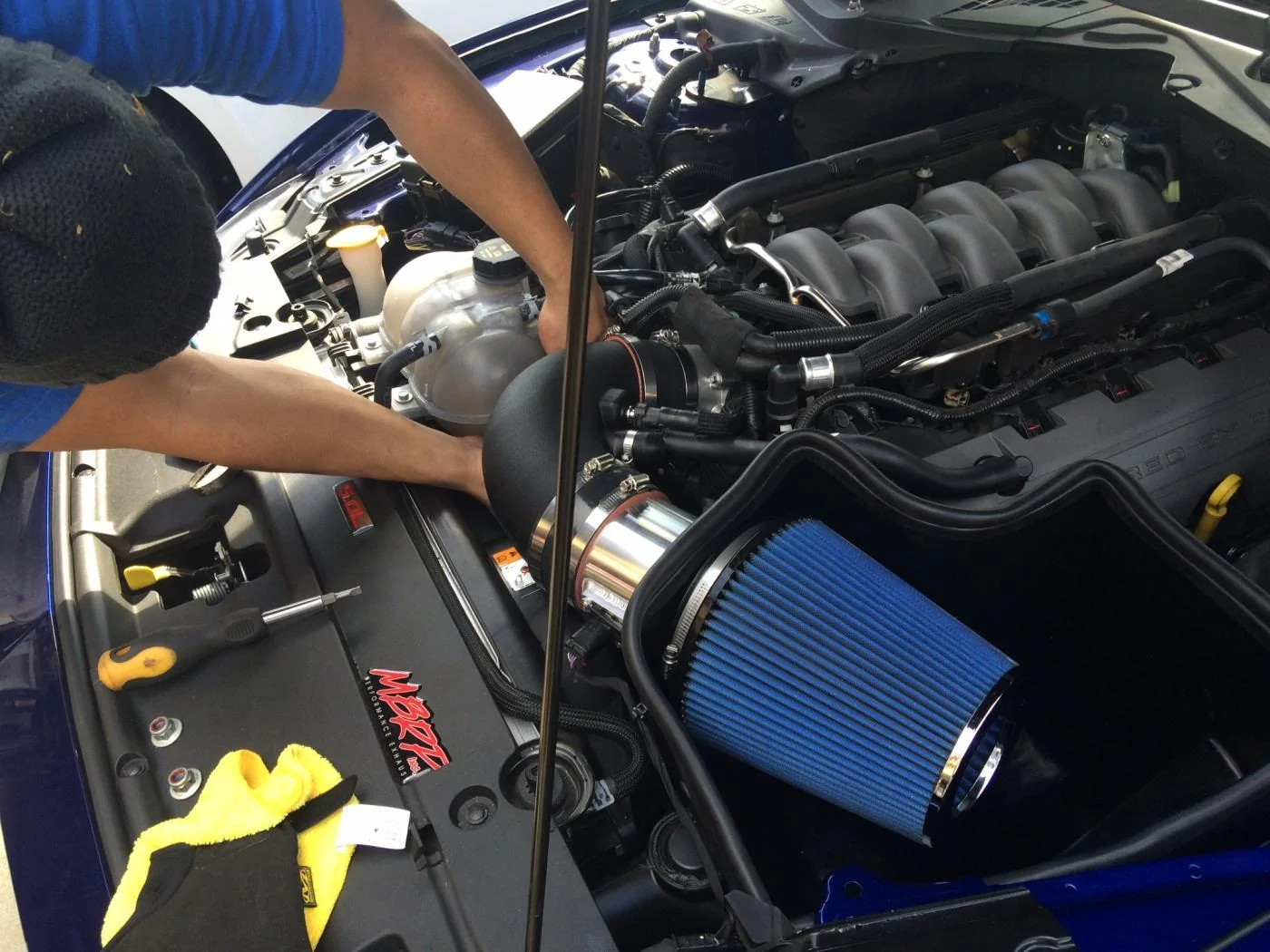

Thanks to [MENTION=11520]Blitz[/MENTION] for the install today. There were zero problems with the install & Lund tune via the nGauge. The butt-o-meter definitely could sense additional h/p. Going thru all gears I can feel the increase in power. Also installed the even flo thermostat, CHT are reading lower than before. Like others have stated if in stop-n-go traffic the temp will rise a bit. If moving my CHT is around 195-200-ish.
We opened up the grill a bit w/a dremel to increase airflow as well. Overall I'm very satisfied with the seat-of-the-pants performance. [MENTION=10893]David@Steeda[/MENTION].
