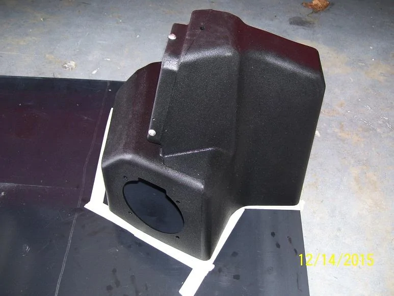

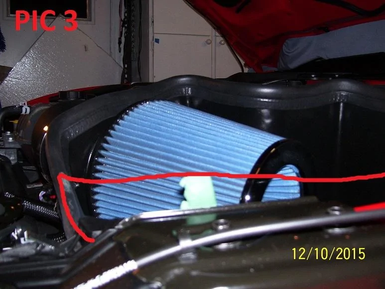

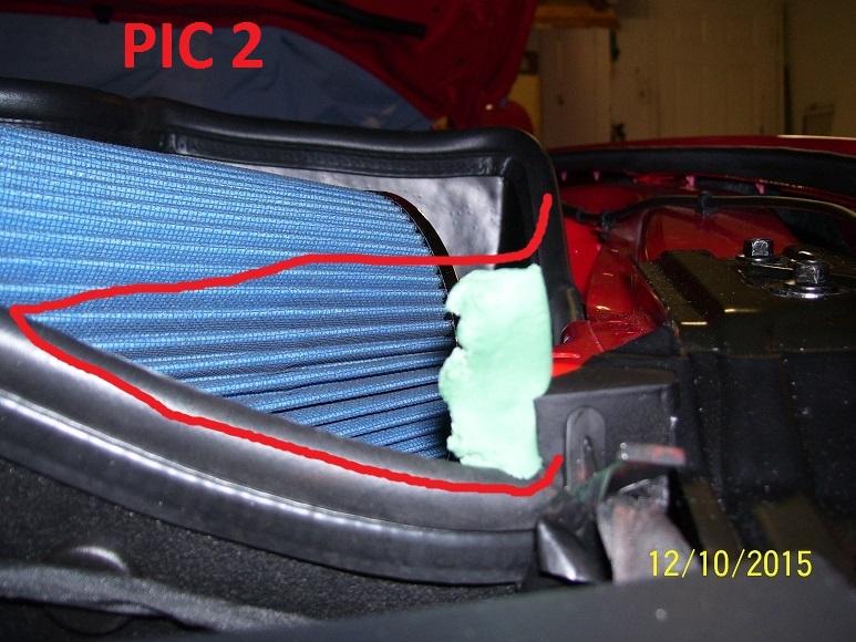

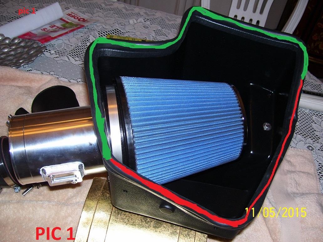

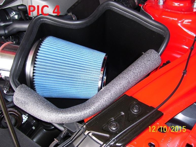

Air Gap at top
Just posting to help with people that race I am not trying to ruffle any feathers. I also purchased the Steeda CAI and a great piece, I have been using Steeda parts since the fox body day`s for decades:hail: and still have the fox body! If you only do Dyno this will not help because the hood will be open problem solved.I used a inspection camera to look at the seal with the hood close because of IAT . Pic 1 Green seals great but the Red has a very large gap in front and side.
Pic 2 is molding clay at front and also in Pic 3 showing the gap.
Pic 4 Tried to fill the gap as a quick fix but not eye appealing or tall enough but did help. Next move I will be doing a ABS molded top to seal off, will give update on top seal:thumbsup:
Just trying to help with the people that race..I am a long time (old) Steeda Fan!

Poppacapp, The large gap with hood closed allows very hot under hood air to be sucked in instead of through the air duct in pics I posted. Sealing this area will be somewhat of a challenge but well worth it:thumbsup:

I agree.. I can see this helping. My main point is I did not see any power gains with the no-tune version. This intake would most likely perform very well with a tune, power wise.
