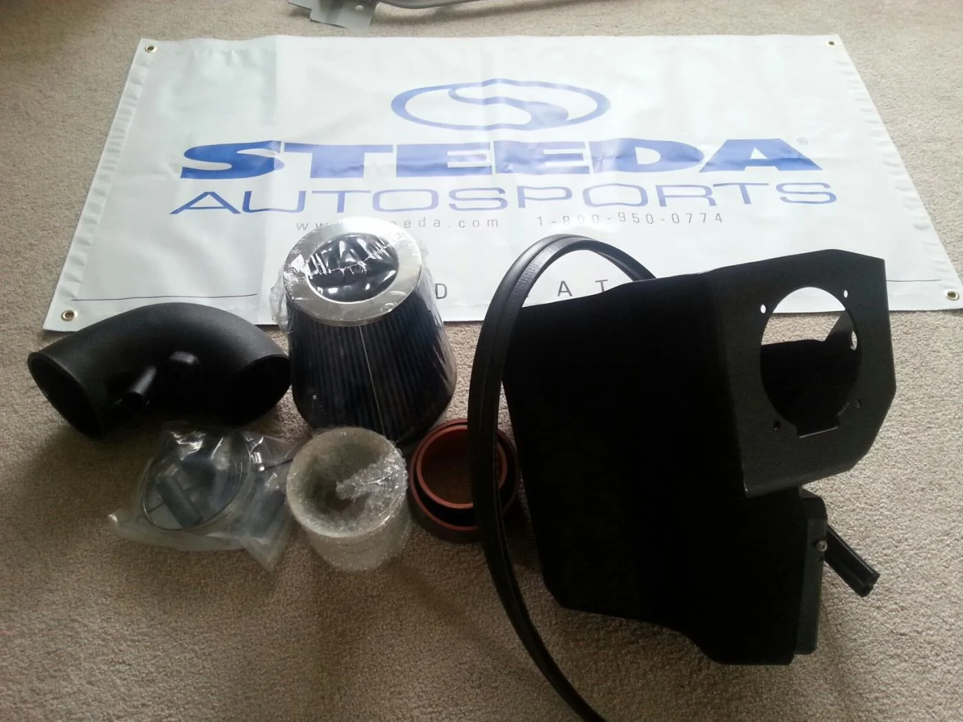

Steeda CAI Review and Install Notes:
Sasuketr
Aug 16, 2014
61
2,548
355
Chicago,IL
2015 Ingot Silver GTPP
I had the seal on in less than 2 minutes, where are you guys running into trouble on it? The biggest pain of the install for me was using a handsaw to get the resonator thing off the intake piece you reuse. Overall, I couldn't believe how simple the install was.
Handsaw took me 1 minute lol. The seal problem was the groove inside, it was not even, i had to open it up with a flat head screw driver. The corners especially was so hard to get it in.

Any issues with the filter getting wet?
Not really. You can see in the pics I posted some minor discoloration near the front on the filter; this was after running a hose right into the hood vent. The majority of the water went in front of the filter and drains out the bottom of the box. Being an oil based filter helps even more with repelling water.
Evolvd
Evolvd
Instigator
Jan 19, 2015
186
6,882
5,895
Northwest Florida
Brian
2021 Shelby GT500
The front of the box holds a small amount of water but doesn't touch the filter. The rest drains out the bottom of the box.
