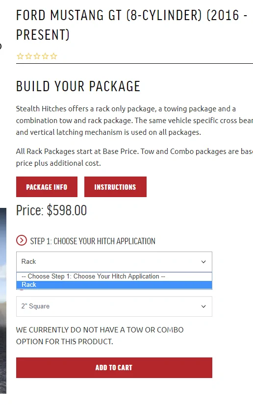

This is the current ordering page for a 2016+ Mustang. While the tow option has gone away, there are two distinct PDFs for installing tow and rack hitches.
