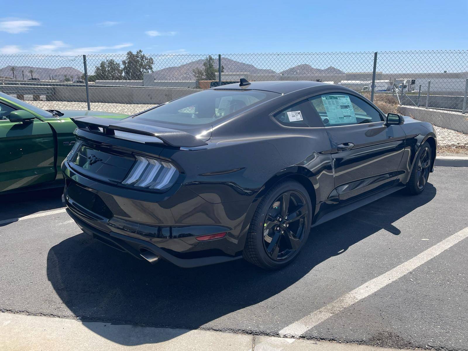

Hello everyone!
I am a brand new Mustang owner for just under two weeks now. I have never owned a Mustang before and I don't think I have stopped smiling while driving it since I picked it up.
My question is for anyone that might also have the Stealth Edition, or has seen the Stealth edition in person. Everything that the package lists I seem to have. The black wheels, the black pony badges, the clear taillights. The one thing I see listed on the package that I can't see to figure out are the door sill plates. Ford's website shows that they should be "stealth lighted sill plates". I am not seeing that at all. When I open the doors they don't seem to light up at all.
I have an appointment scheduled with the dealership to take a look at it, but they are saying it is going to be three weeks before I can get it. I just wanted to double check that I wasn't missing something obvious about how to turn them on. I feel like I am still finding buttons and switches I missed.
Does anyone know if the stealth sill plates should still be illuminated like all of the other sill plates with the premium package? I tried to look online for pictures or videos of someone showing it off, but I have only been able to find a few stock photos that don't show them lit.
Thank you in advanced for any information that can be provided! I have attached a few photos to show what the plates look like if that helps.

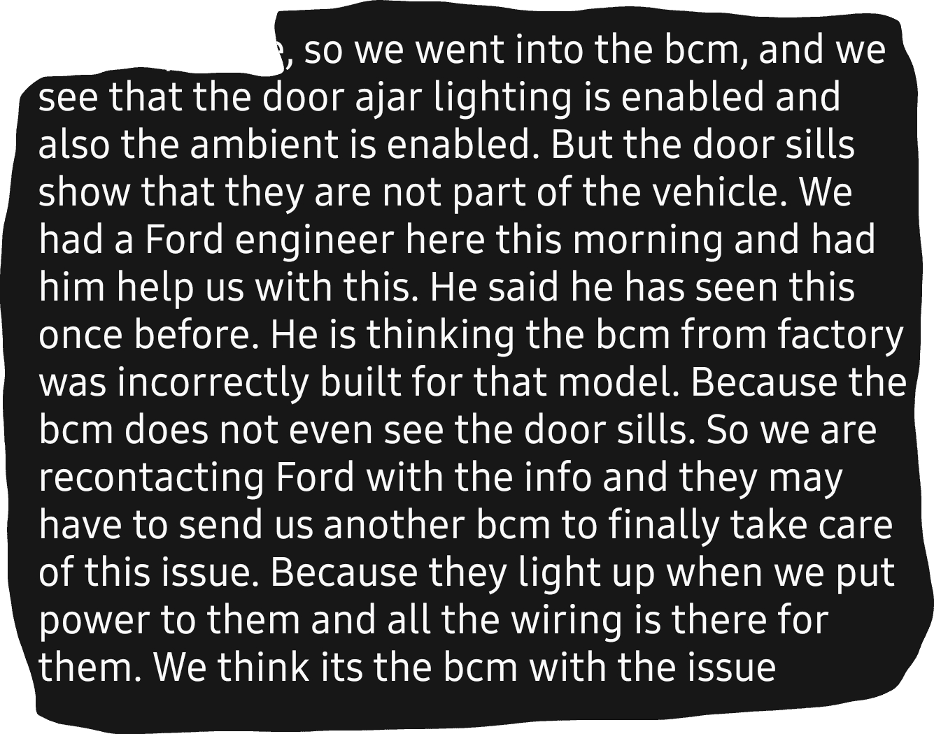

Well updates from my mechanic: Now they will try to do an ambient lighting calibration that is available within the BCM. Don't really know what that means (reset?), I am trying to keep up with them but they lost me already. lol
