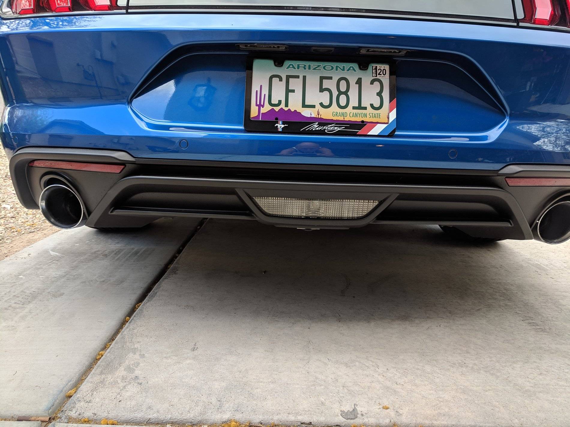

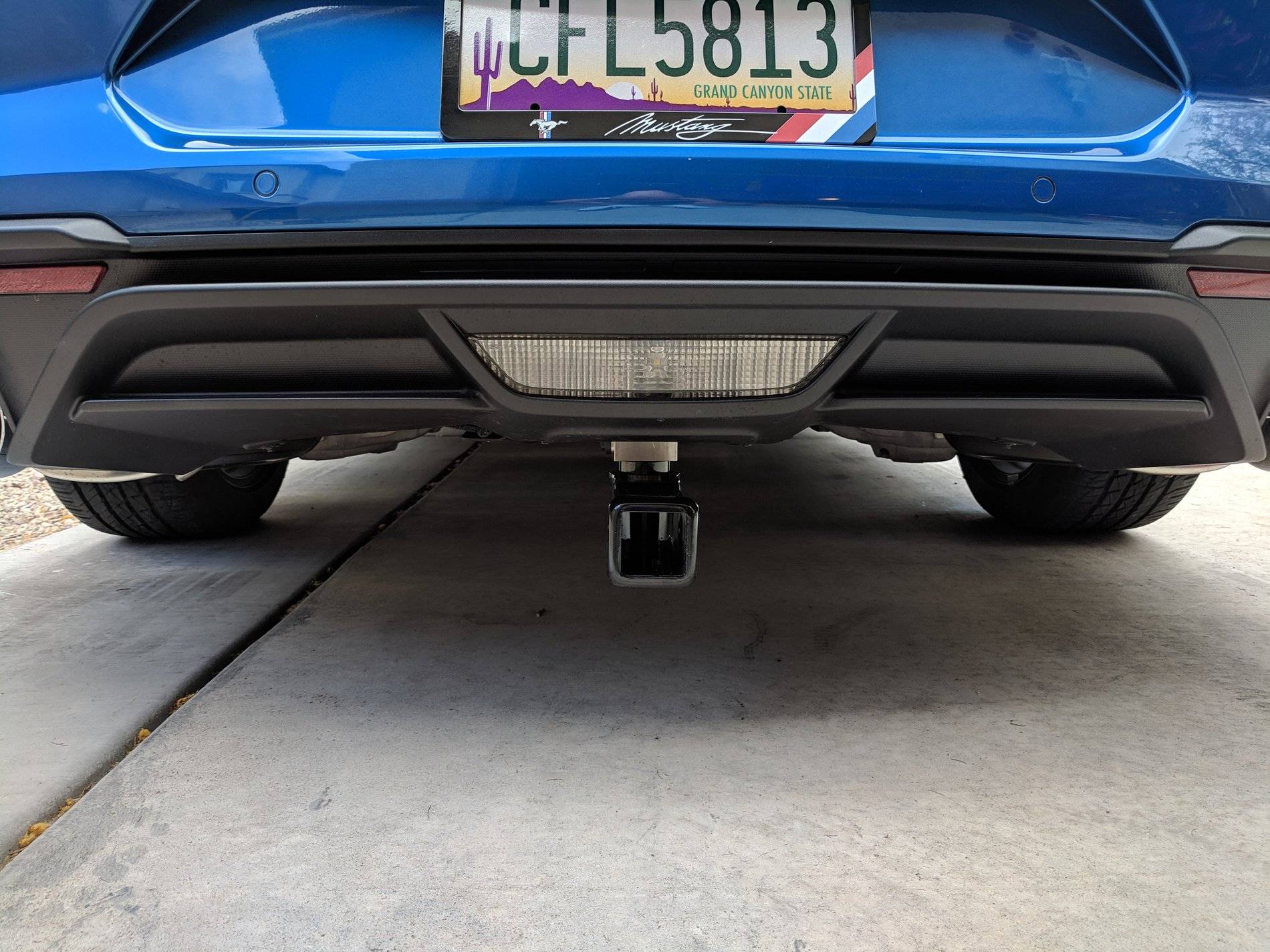

Can anybody provide a measurement of the clearance from the ground to the bottom of the hitch with the receiver installed? I'm curious about approach angles/ scraping on the driveway on a 2018 GT stock. I'm interested in attaching a Thule T2 Pro XT 2 bike hitch mount bike rack to a stealth hitch. The Thule rack tapers upward from its attachment point to the hitch, so I think the hitch receiver would be the lowest point of the setup. Thanks!
I'll have to check, but I do know that it scrapes with the receiver installed on my driveway. I have to park on the street to install the receiver and my bike rack. The pix show the receiver attached in the second one.
