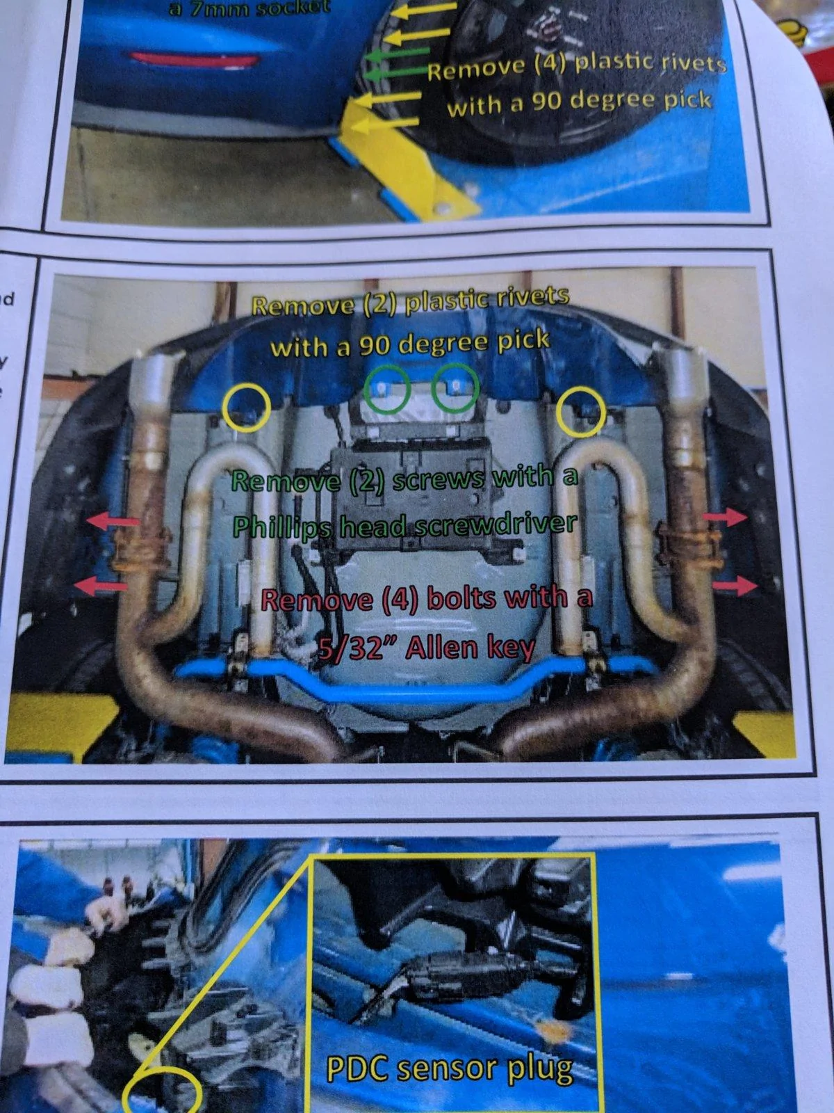

Ok, so what is with this wacky exhaust setup on this Mustang? This is from the installation sheet. What's with those weird extra looping pipes?????
Those are called J pipes and it is a Solo Performance exhaust. J pipes are 1/4 wave resonators that remove drone in targeted frequency ranges.
Thanks! Learn something new every day :)

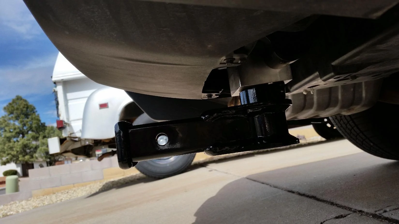

I finally installed mine. Installation was a huge PITA, though I managed to get everything back together without breaking anything. I'm a little disappointed how low the hitch is. The receiver is easily 1.5" below the diffuser. My back rack nearly scraped pulling into my driveway.

More pictures. How long does it to install or remove the "bridge" piece?

I don't have any more pictures right now. It took me about 6 hours to install and re-assemble everything. I'm not sure which piece you are referring to.
Mine has been sitting in my garage since I got it. I need to stop being so lazy.
Did you remove the bumper, per the instructions, or were you able to get it on another way?
I removed the diffuser and one bracket that the diffuser connects to near the reverse light. I'm not sure if it is any easier than removing the entire bumper, but I was concerned about breaking the bumper. I'd have to check again to see if it is absolutely necessary to remove the diffuser or the bumper.
I also wound up removing the entire cat back exhaust. You have to drop the exhaust anyways. It is not much more work to remove it entirely, assuming your clamps are not seized. I think the whole installation would have gone much quicker if I pulled the exhaust in the beginning.

That is my car. That is a Solo Performance Mach XV catback. Those loop pipes are there to cancel out drone -- and it must work because there's zero drone.
Before y'all start being asses, go to the beginning of this thread when I explained my car was the test mule. I have the very first Stealth Hitch prototype still. And it's for sale in the Atlanta area. :)

So a normal hitch has the ugly exposed hitch, which you then slide the receiver hitch into.
The stealth hitch has a hidden hitch, that takes the (exposed) L shaped receiver, that the receiver hitch slides into. IF the L shaped bridge is a huge pain to install and remove, then you might be tempted to just leave it in place. At which point the stealth hitch would become just a very expensive regular hitch.

I misunderstood your original question. I was referring to installation of the entire hitch to the vehicle. The L shaped receiver is very easy to install and remove. There is a handle on the side that you rotate to remove the receiver. To install, you just push it into the block and it automatically latches.
