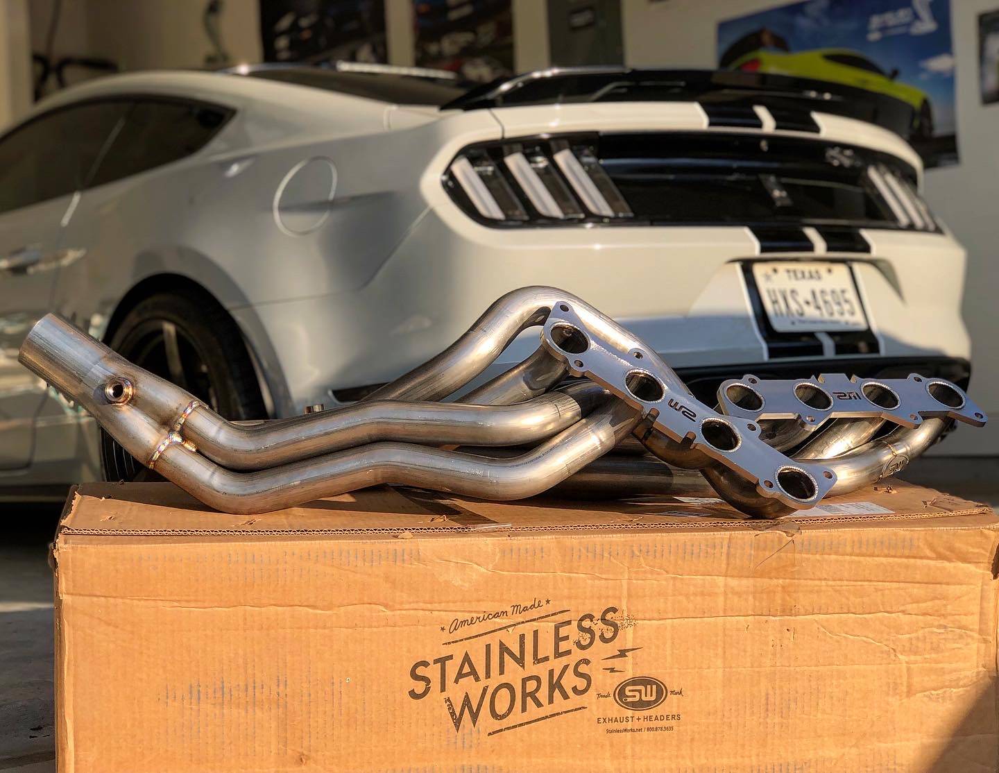

Hey folks! I'm planning to finally step up to a set of long-tube headers this year and am starting to do research into each brand to decide which ones to get. I've ruled out Kooks as I've seen several reports of cracking at the welds. Therefore I've narrowed it down to Stainless Works and American Racing. I'm wanting to get whichever is the best (price is secondary). I was dead set on ARH for the longest time but I've heard of several people (mostly those that track regularly) having issues with the ARH hitting/rubbing. I haven't heard of anyone having clearance issues with SW. After looking at them closely, it appears the SW is in fact a slightly different design to the ARH. Are there any issues that I'm not aware of with the SW? Which do you guys recommend and why?

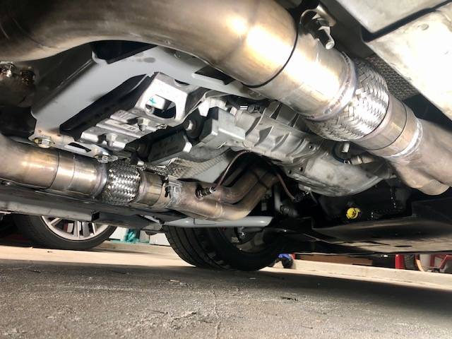

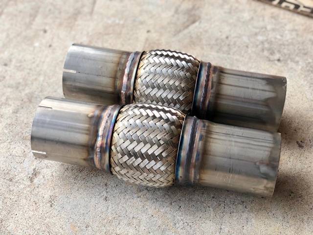

I've ran 30k miles through my Stainless Work system, and so far no cracking. I had researched quite a bit myself and couldn't find any info on consumers having issues. I did add flex joints to the off-road pipes to ease the stress on the header for longevity. I noticed most aftermarket LTH brands do not offer this and IMO is needed for our vibrating motors, along with vibration dampers.

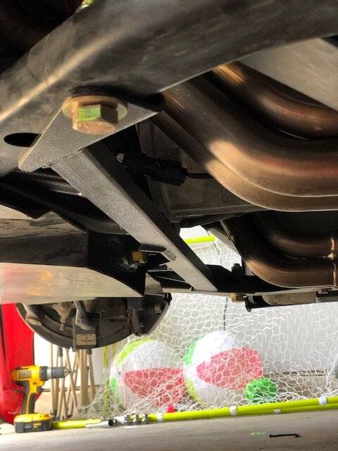

The only item I can say I've had issues with is adding lower G-Trac bars. Im not sure how other brand LTH's sit when they come down to the collector, but this one seems to be in the way of all Steeda G-trac bar offerings. BMR produces a 4-point & 2-point bar that sits closer towards the oil pan and so far is the only one that seems to clear the SW Headers. This isn't a big deal to me, as I prefer to have a quality LTH over a tie-bar I can have modified if need be......but something to point out is all.

Where did you get the flex pipes? I'd like o pick up a set for myself.
