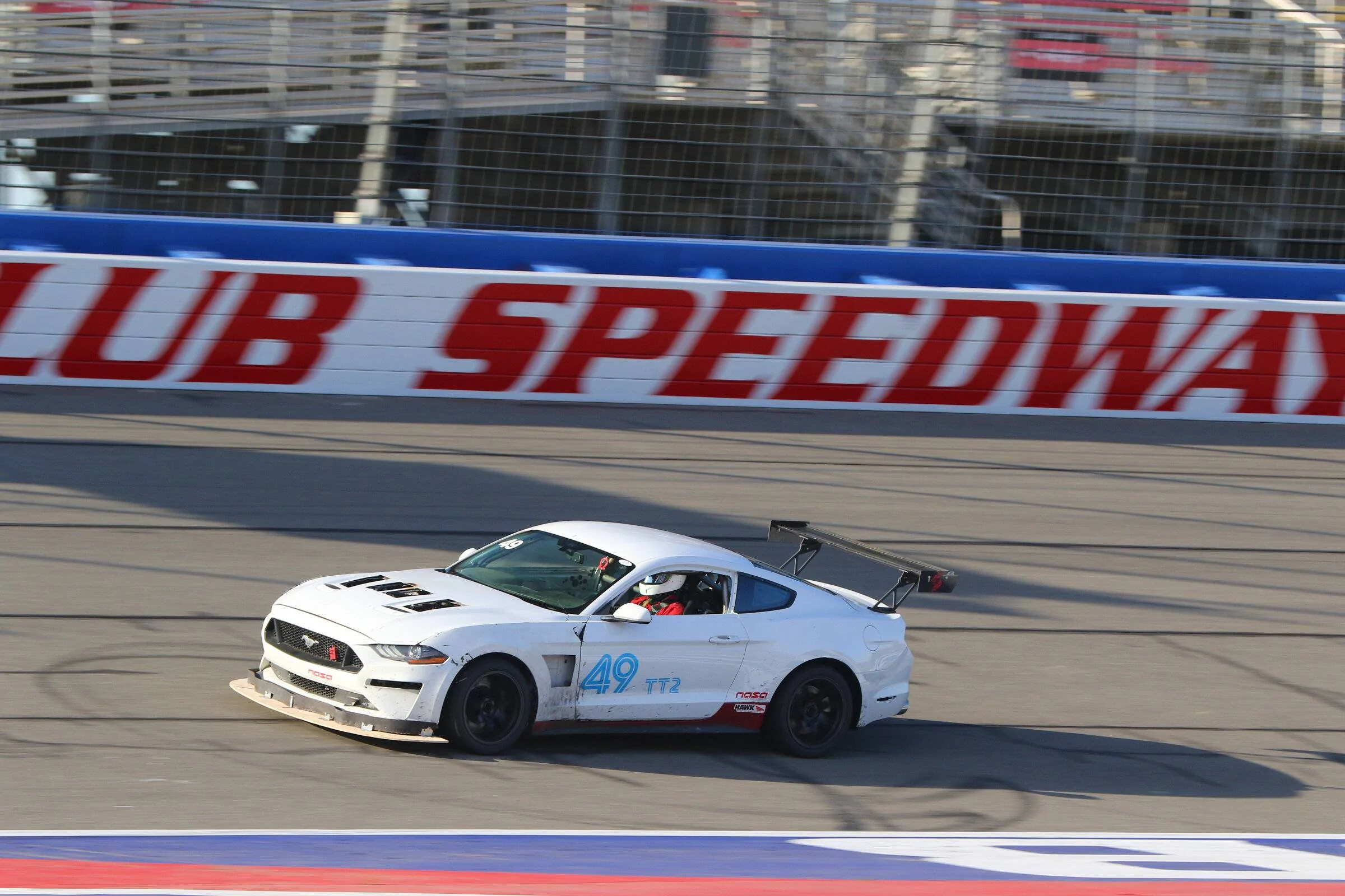

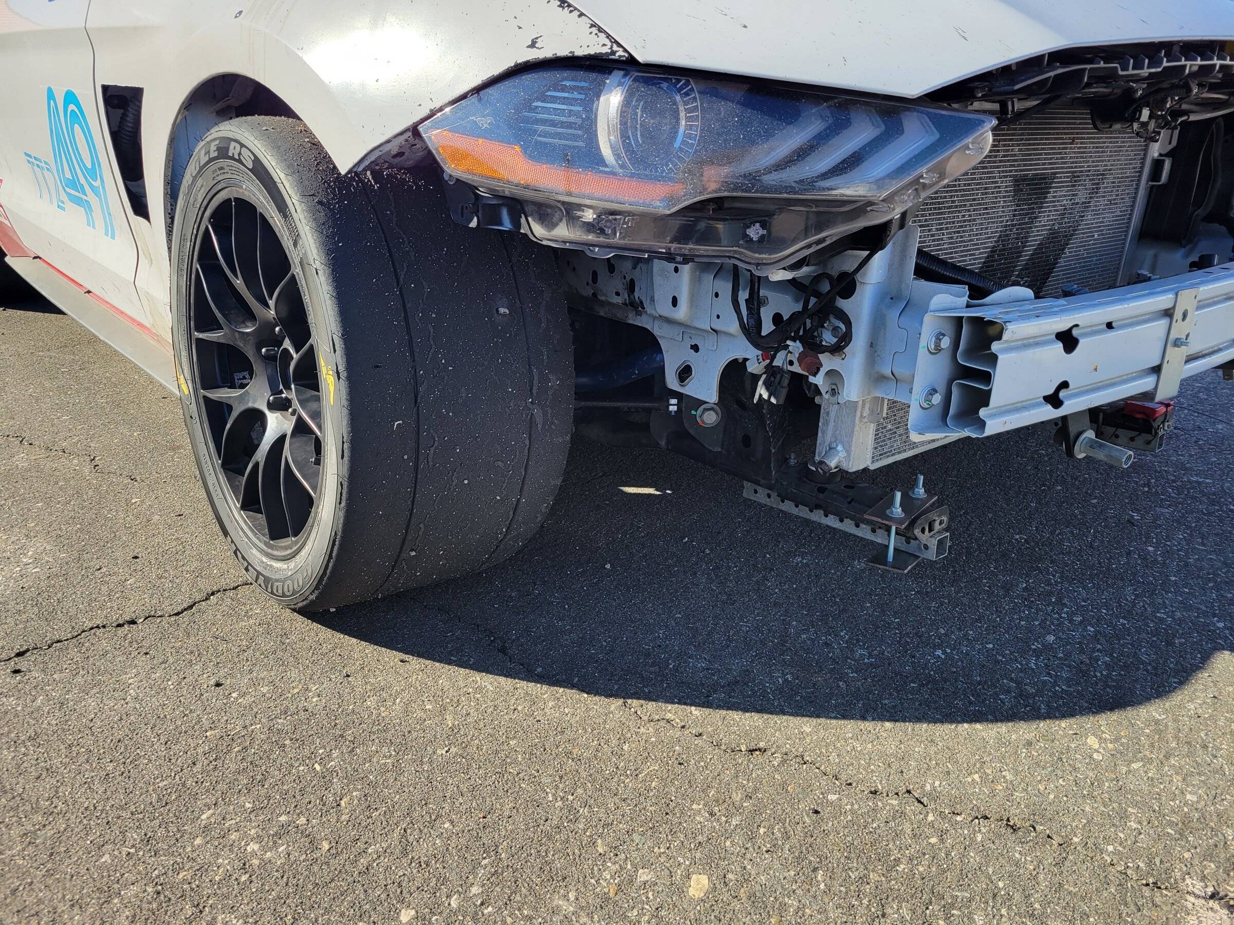

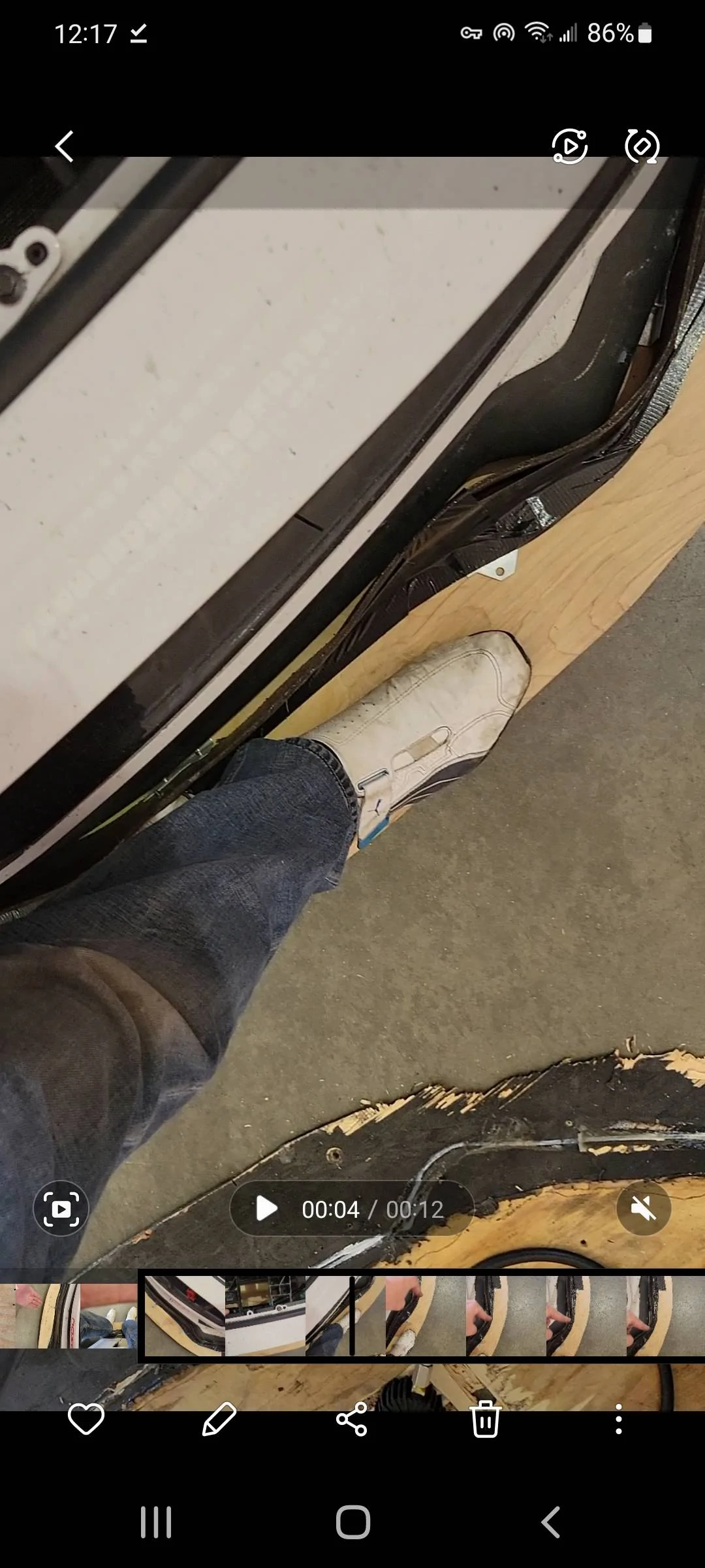

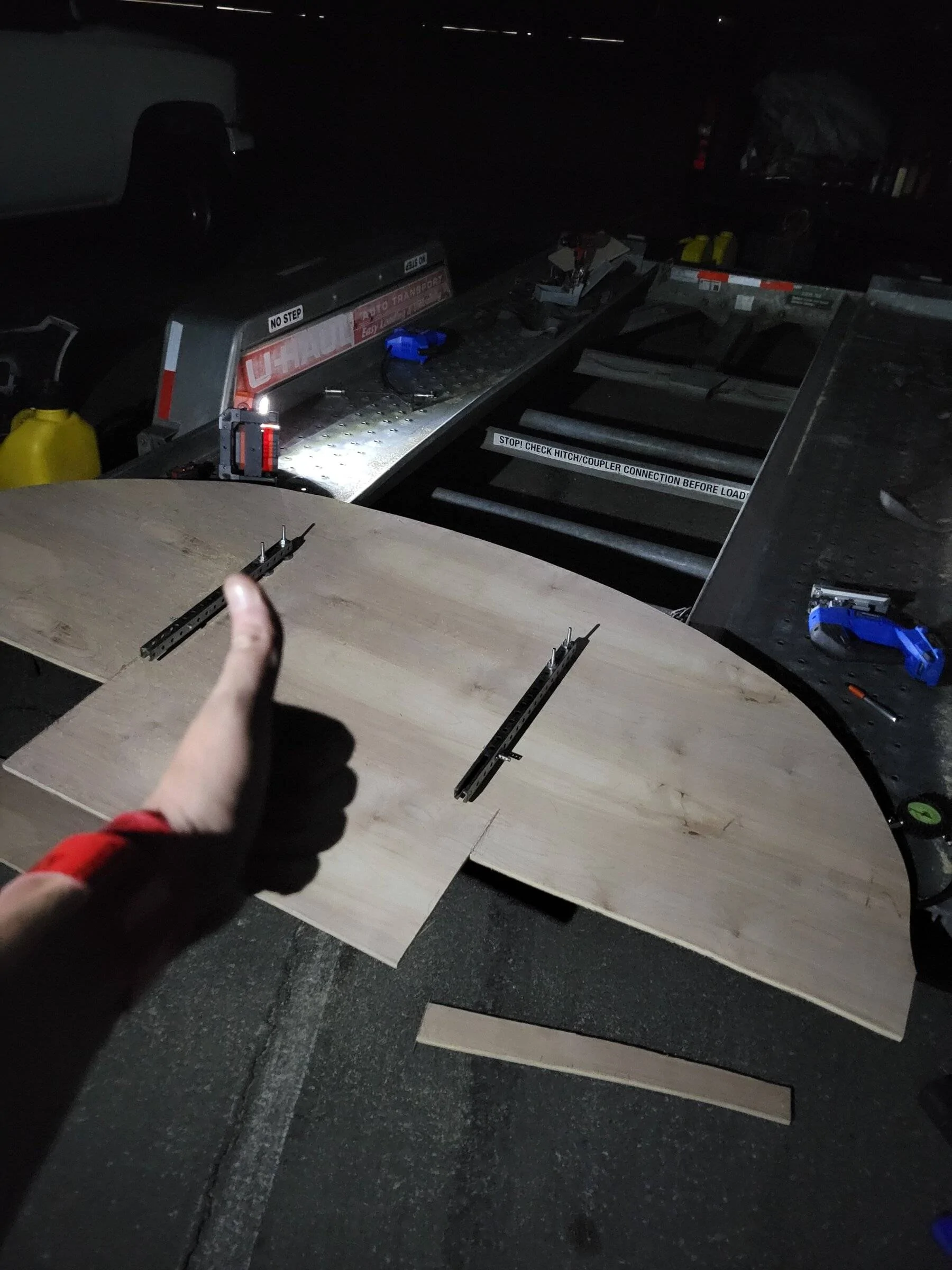

I'm not going to lie, Ale has put in some hours on his design. My design is so easy that an idiot like me can do it. Ended up snapping my old splitter this weekend, after almost a full year of abuse, and a quick trip to the hardware store pretty much had it all rectified in about an hour, and for a whopping $68.
I was using 15/32" ply, but switched to 1/2" birch this weekend, 4'x8' board, so much nicer, so much stronger and smoother, I didn't scrape it, but I assume if I did, it won't splinter, it'll somewhat sand itself down.
To secure it, I use signpost 1" and 1 1/4" squared tubes, the bigger ones hanging underneath the radiator support arms, smaller one on the board itself. To help clear things, I use spacers to give it just a little more separation and on the back of the main support tube, I've got a long 5/16" bolt dropping through, acting as a stopper. I've canoed off some the squared holes on the splitter side, so that it'll line up perfectly, sliding into position, and then just throw a dowel rod/pin so that it won't slide out. I can take the splitter off and on in ... what, 15 seconds?
Of late, I've added some 36" steel bars underneath to stiffen it up, making a box, and in a rush, I didn't even care to drill for the carbon splitter rods, but I'll probably add those back on this week. Other than that, the only other things you need are something to help build a fence, so that air won't get between your splitter and bumper, and I went with the garden edging vinyl stuff that goes between concrete walkways and grass, some L brackets, some wood screws, duct tape, and some caulking and caulking gun. I've got a new bumper, so I didn't do the caulk part knowing I'll take it back up this weekend and reposition it to fit that one as well.
Is it ugly? Perhaps.
Is it functional? Most Def.
Is there a perfect one? Probably not.
But don't underestimate the effect aero can have to your high speed handling when you get the balance just right. I pulled the 3rd best time of the day and reeled in cars with 300+ hp more than I did, and I'm just e85 and longtubes. This was solid to the 160 that I was able to click off at the end of the straight, and it holds my 220# standing right on the nose just fine. Most important, make it you, make it fun.

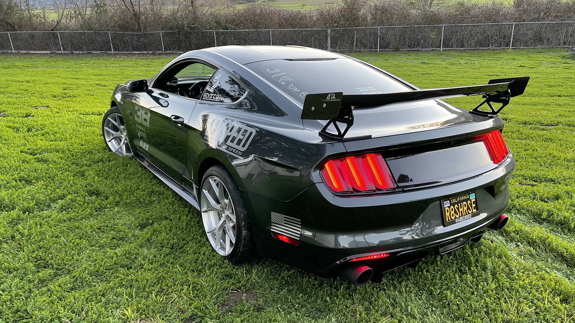

I'm considering the APR spoiler with struts. How was the installation and are you happy with it?
2morrow
DesignR/DriveR/RiceEatR
Nov 15, 2015
58
6,497
6,113
NorCal Bay Area
Todd
'16 Mustang GTPP
Very happy with it, works perfectly for my needs.
peep the install here.
