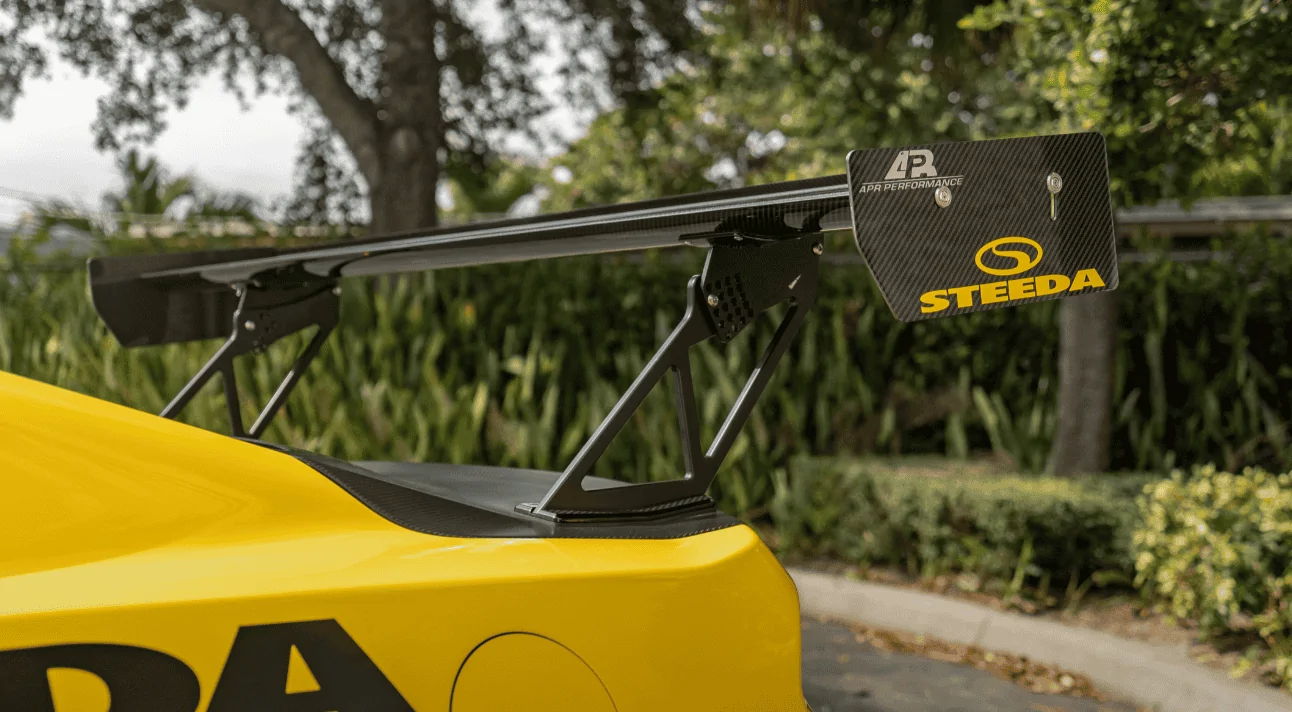

Occasionally I push the car, and I can't have a spoiler blow up on me at 160+.
I want it to provide some actual downforce too.
I also want something that is a little flashy, but not too over the top.
Any recommendations would be a big help!
Hey OP, a couple answers to your questions below.
1. If you do 160 in this car the spoiler is the least of your issues. F/R bumper will likely blow off before the spoiler. Don't even get me started on the hood float lol.
2. Actual downforce=money. For many reasons. Also, if you put downforce on the rear you'll definitely want more in the front.
3. Super subjective. I would use the search option and find the spoiler thread and start there.
4. I went with an APR unit because I need actual downforce, APR uses CFD to get their data and it's adjustable depending on what track i'm at.
Good luck!
Good luck!

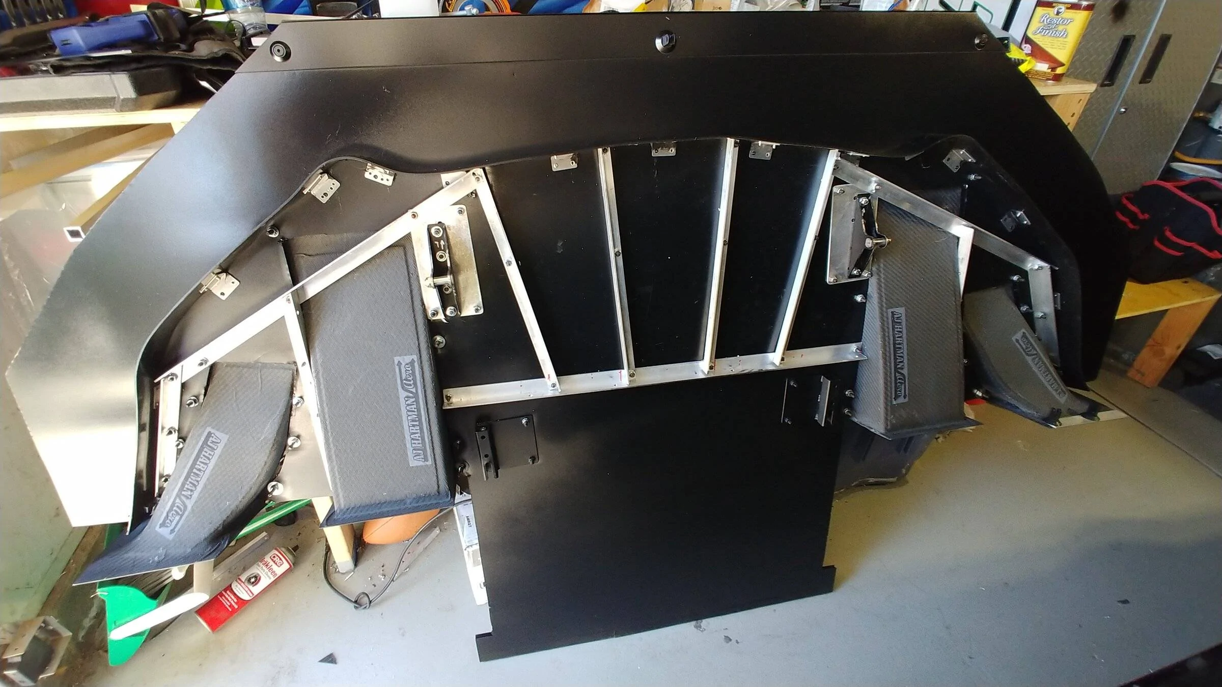

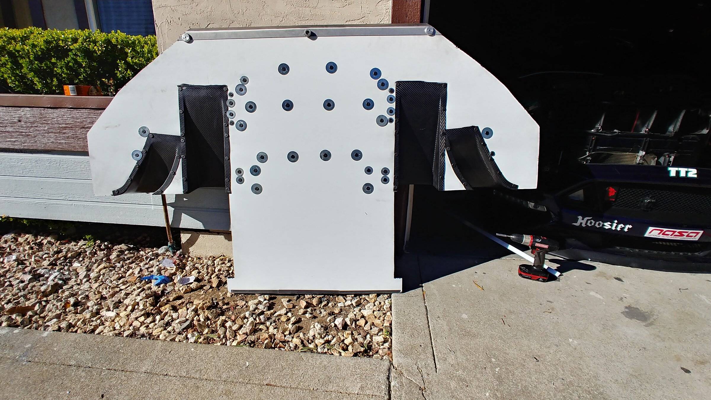

This is my latest. Still finishing but optimized for downforce with big front tunnels and side plates.
Before that i had the version only blade (car pic) but also with smaller tunnells.
A good chassis mounted blade (5-6 " lip) sitted at 3" from the ground can generate 200-250 lbs at 100mph.
With tunnells and side plates 400-500.
I make mine removable in 5mins with all quick connectors
A note. Tunnells and side plate = more DF but more drag.
