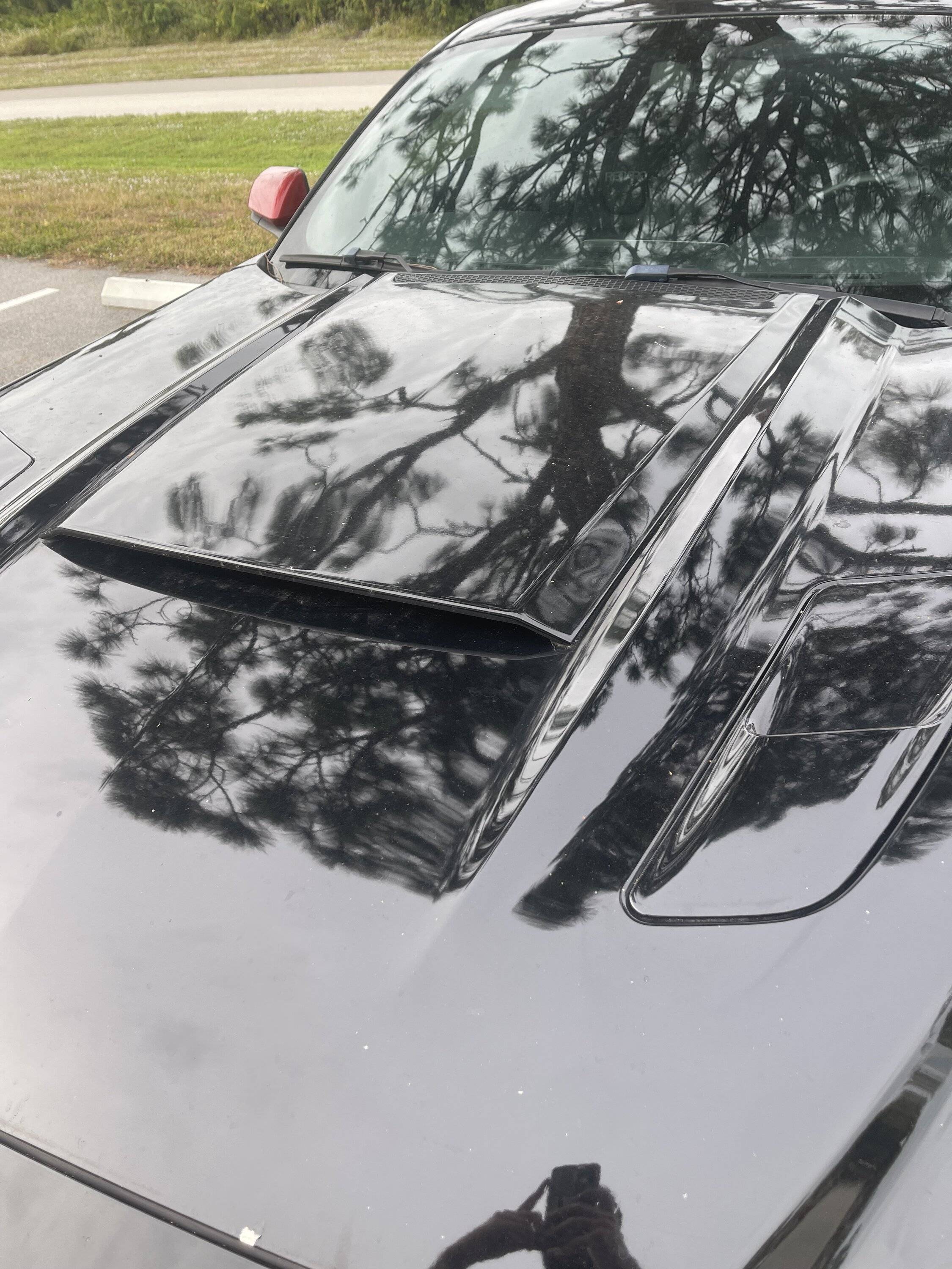

I guess this is more of a de-modding question but the op of my 15 gt installed a spoiler and hood scoop with double sided tape. How can I remove the tape? I know a heat gun will work but I don’t have one. Any other methods?

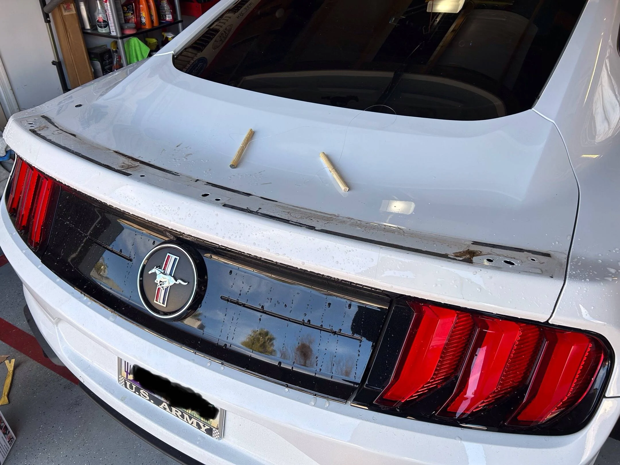

recently had a removal and I used 25 lb fishing line.
Once the spoiler was removed I used these to remove the 3m tape : https://www.amazon.com/dp/B00FJF0O2K?ref=ppx_yo2ov_dt_b_product_details&th=1
and these
https://www.amazon.com/dp/B076BBW1WM?ref=ppx_yo2ov_dt_b_product_details&th=1
finished the cleanup with Goo Gone and isopropyl... a gentle buff with a cleaner wax and then a polish.

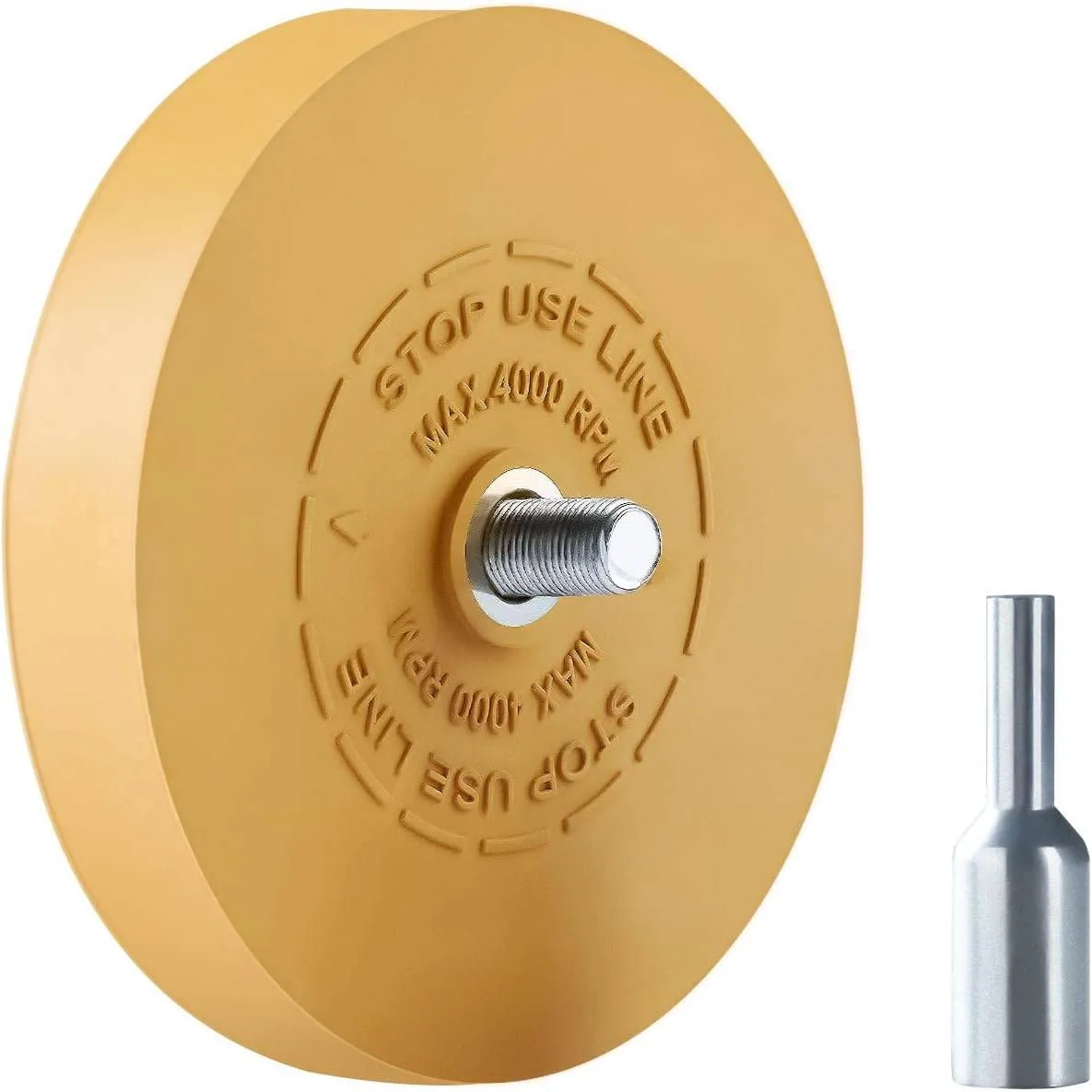

I used one of these to remove the tape after I took off my spoiler. It is the fastest and easiest just be careful when using it as to fast of speed with the drill can burn the paint of your car.

I’ve used one of those drill attachments before with great results.
So most of the tape is off the trunk, there’s only like a 1’’ section on each pedestal. I read that fishing line can scratch the paint that’s why I didn’t mention it but if you guys have used it without issue I’ll give it a go. I have some line lying around I could use.
