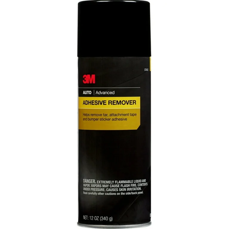

And to clean up any residue -
3M-Adhesive-Remover-12-oz-6-per-case_c7413b90-6853-402e-b245-944e71f1d1ba.a6b69fe48c6391416bc...webp
