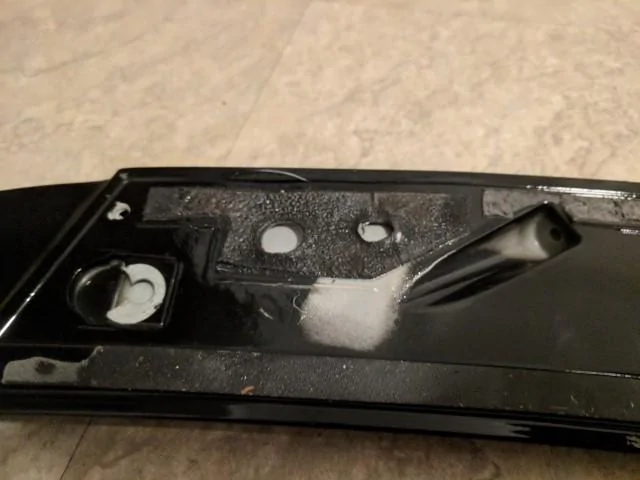

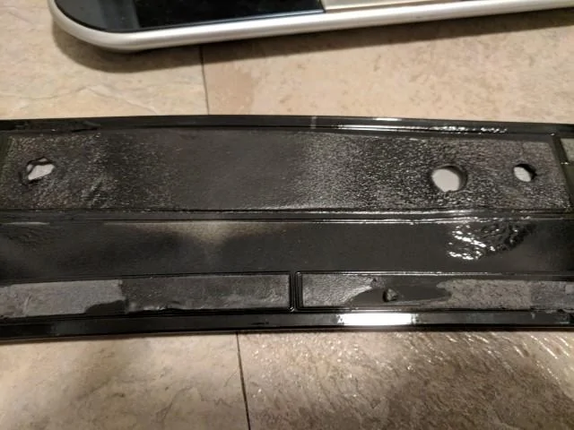

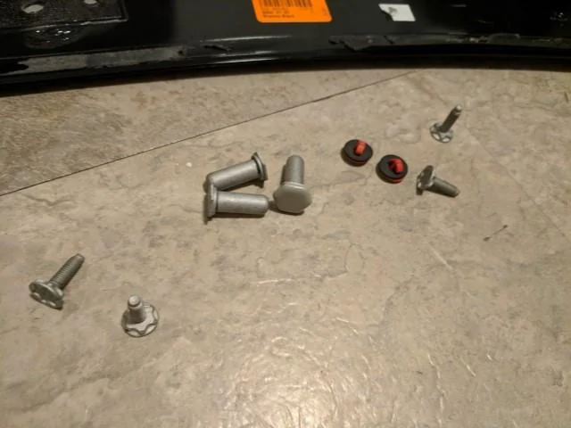

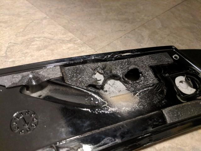

Followed a tip from [MENTION=25851]chops44[/MENTION] and heated up (using cheap Harbor Freight heat gun) the area surrounding each of the pieces then (wearing gloves) pulled them. The right most side of the spoiler was annoying as hell and wouldn't come out nicely and I wasn't paying enough attention, applied too much heat, and the paint started peeling as I was pulling the last piece out.
Here are some pics for anyone else that goes for this type of method. The last one shows the pieces that are pulled out the spoiler.

Awesome, glad you got it done. The good news is no one will ever see the paint on the bottom side lol.
