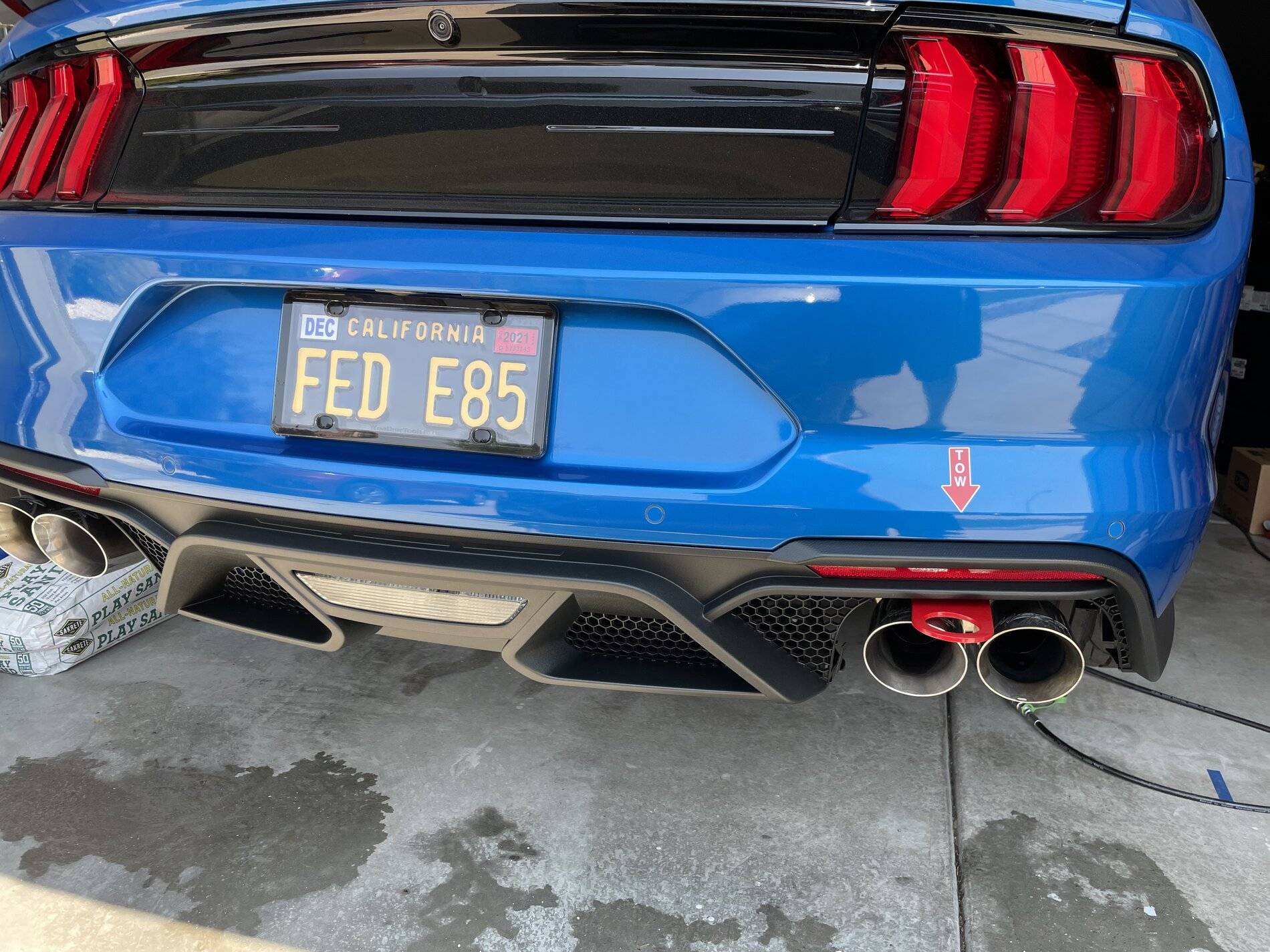

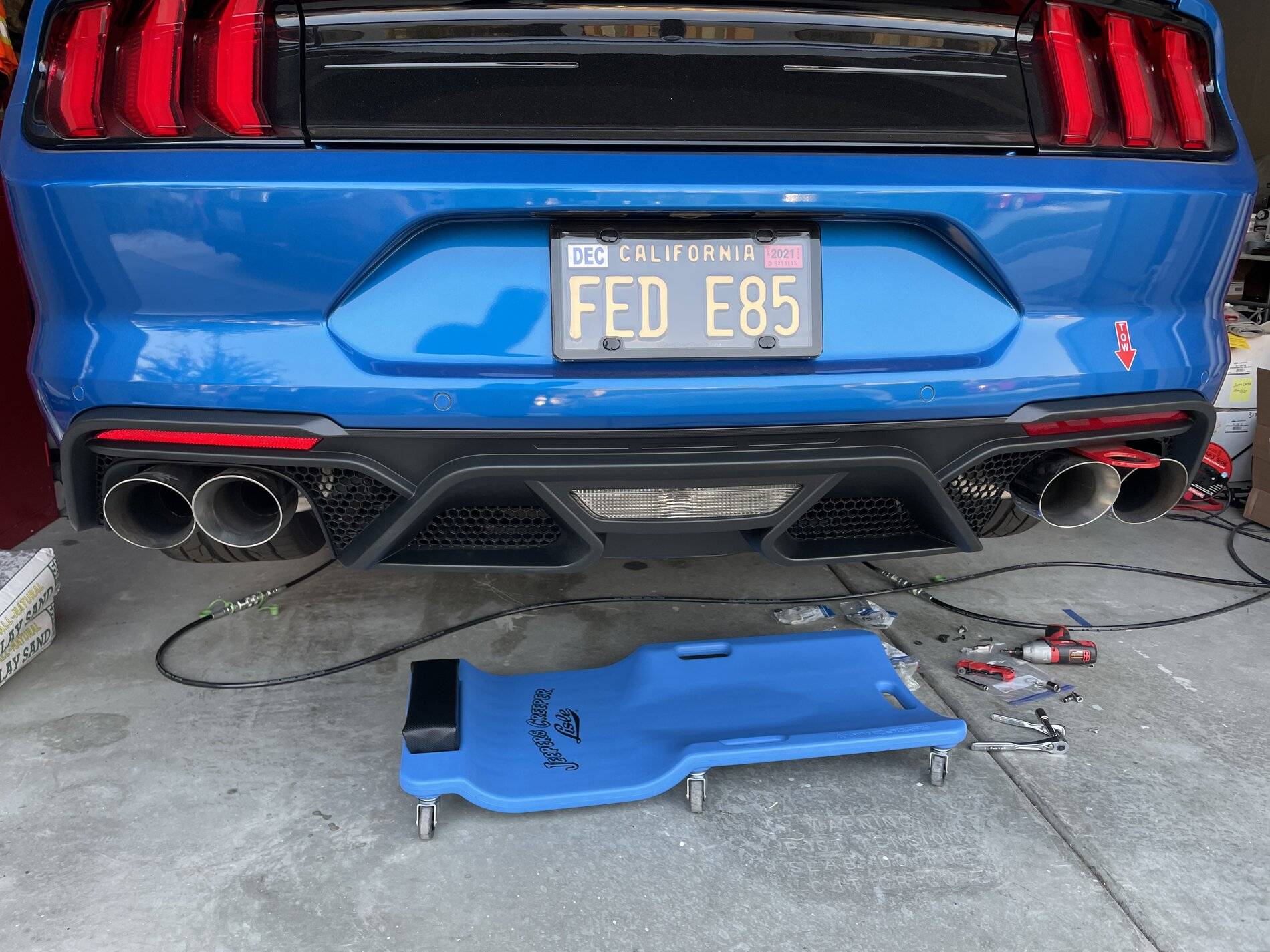

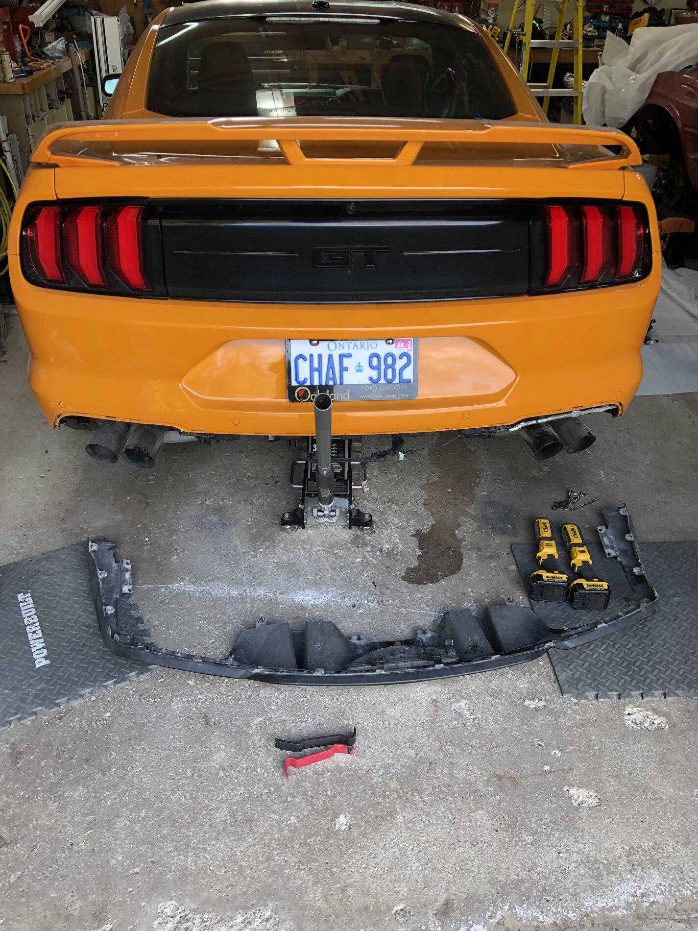

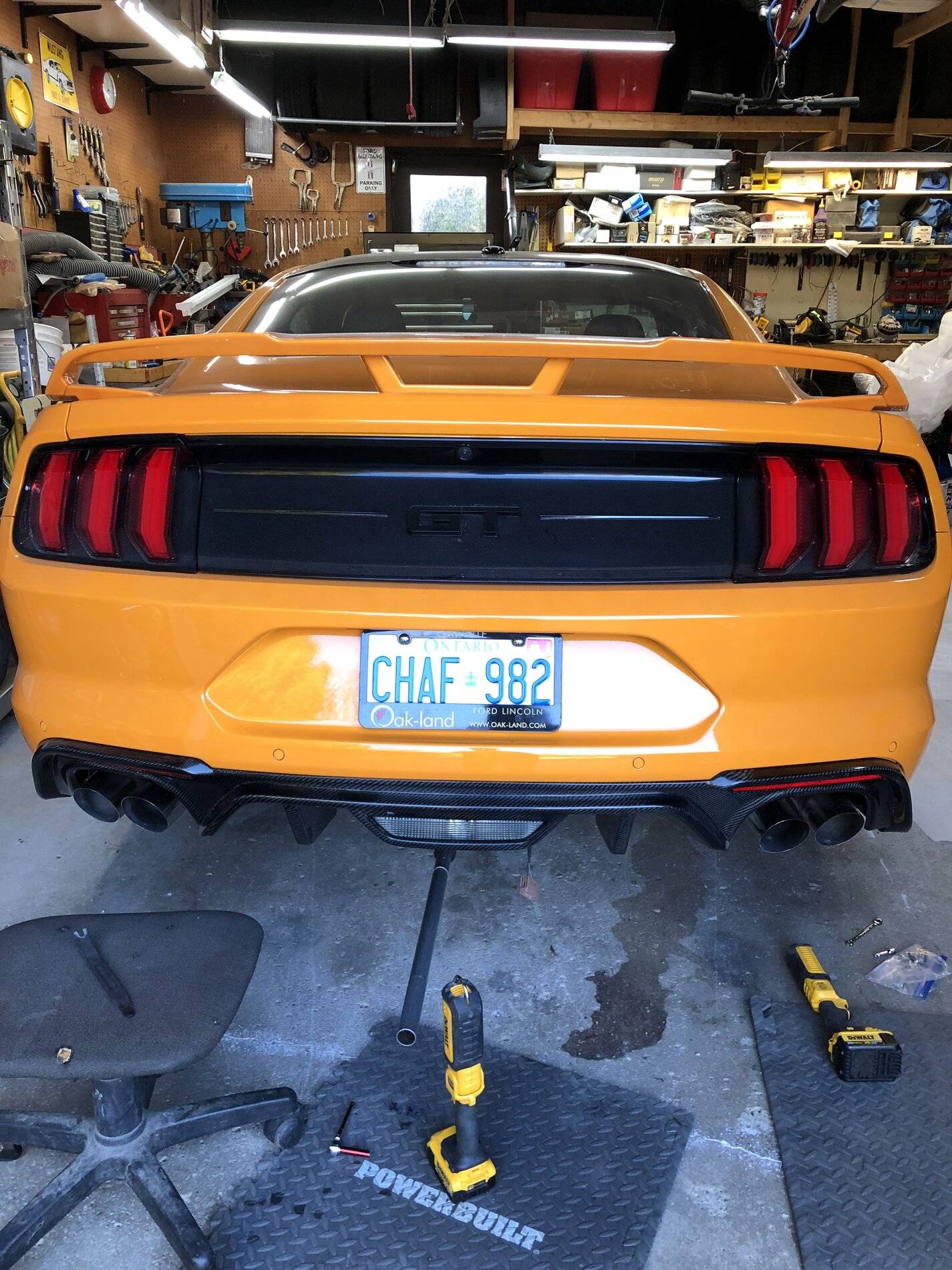

I replaced my GT diffuser with a GT500/Mach 1 unit while the rear bumper was still attached to the car. It was very easy.

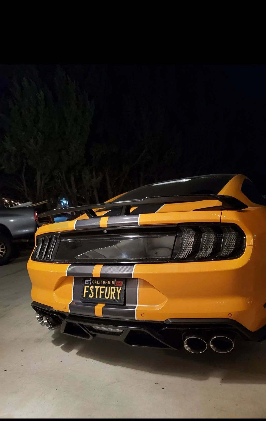

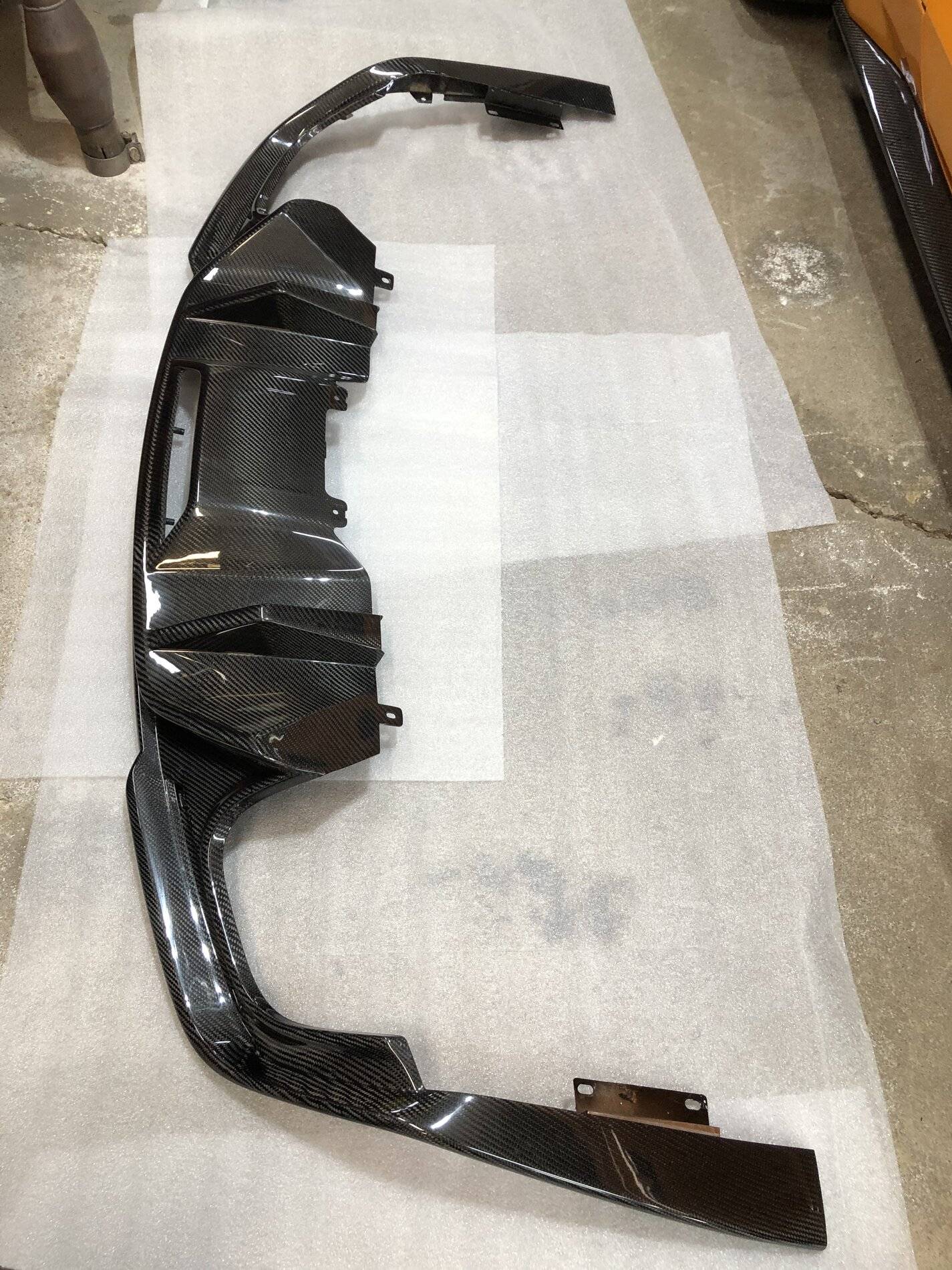

I swaped my 18 OEM for a Trufiber diffuser without taking the bumper cover off. I am old and riddled with arthritis but it wasn't to bad to do.

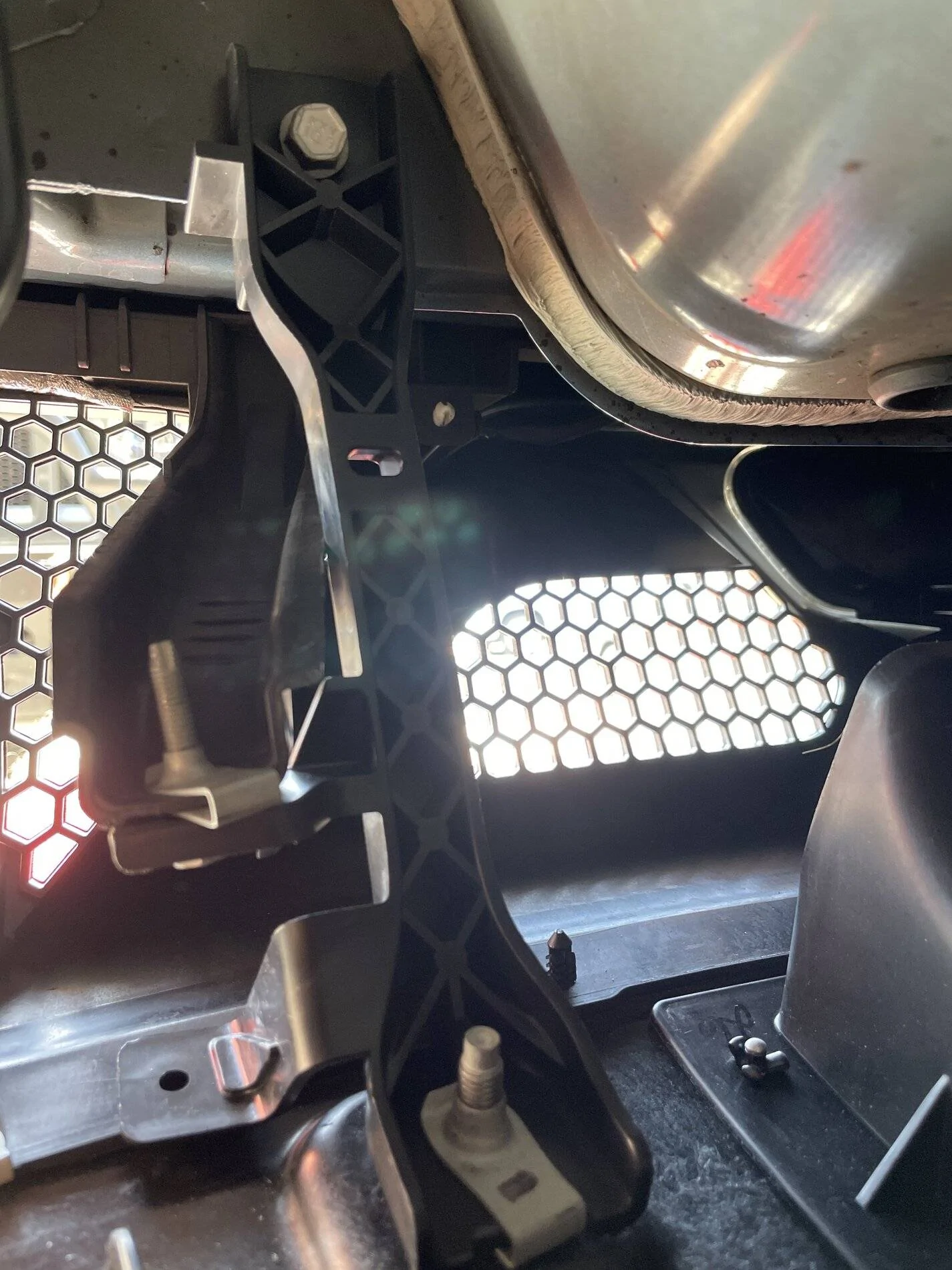

Yes, it’s an OEM kit from Levittown. I can take some. Anything specific that you’re looking for?

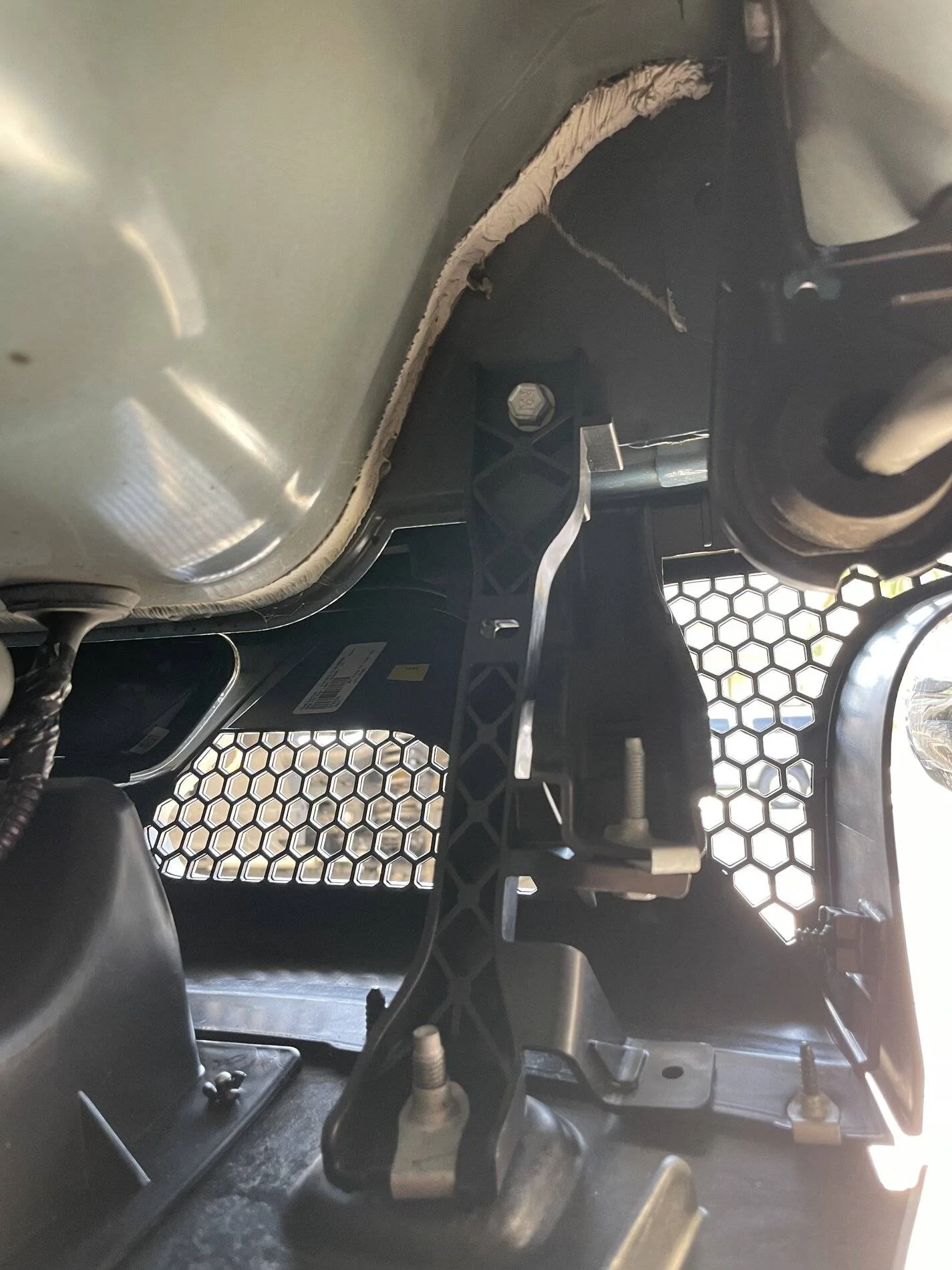

where it mounts underneath the car, i just bought the diffuser life is expensive in Canada for the entire kit

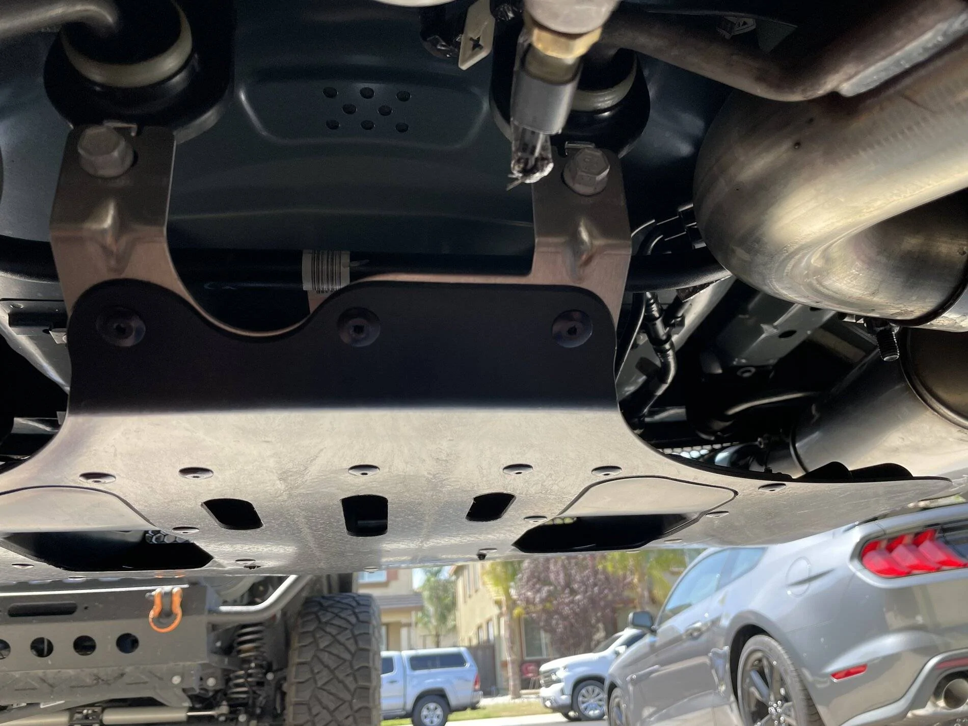

I replaced my 2020 GT diffuser with an OEM GT500 diffuser and despite initially wondering why the hell I was taking off the rear bumper, I did. I chose not to use the underbody pan, but mounted the support arms just like Kermitz did above.
