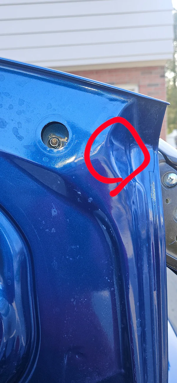

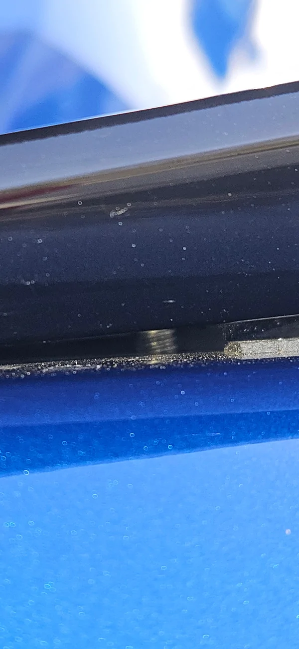

Ok, bringing up my old post because I cannot for the life of me figure out to to reinstall and retighten the outer bolts to the spoiler. I have no idea what i am missing here, maybe im crazy. First picture is showing the stud coming from the spoiler into the trunk lid, and the second picture ive circled approx where that stud enters the lid.

What spoiler do you have?
I believe its a pp1 spoiler.
EDIT :: I've watched some videos on installs and removals and I see no mention of installing those nuts. they just seem to skip over it.
There’s just the 4 nuts, 2 in the center and one each on the ends. The other guide posts don’t have nuts.

Ok, so i guess that's where my confusion comes from. what the heck is up with those outer threaded posts then?

I’ll try to look at my original spoiler later today (I took it off for the GT500/Mach 1 Swing) and see what it looks like. I honestly don’t remember, but there’s only 4 bolts that use nuts. The rest of the spoiler is held with 3M tape
Appreciate it. Yeah the 4 bolts that you referenced are all there and tight. The double sided tape seems to have released on the ends. But the threaded posts are dricing me nuts...literally. Had a loose nut in the deck lid which again drove me nuts until it magically came out one day.
