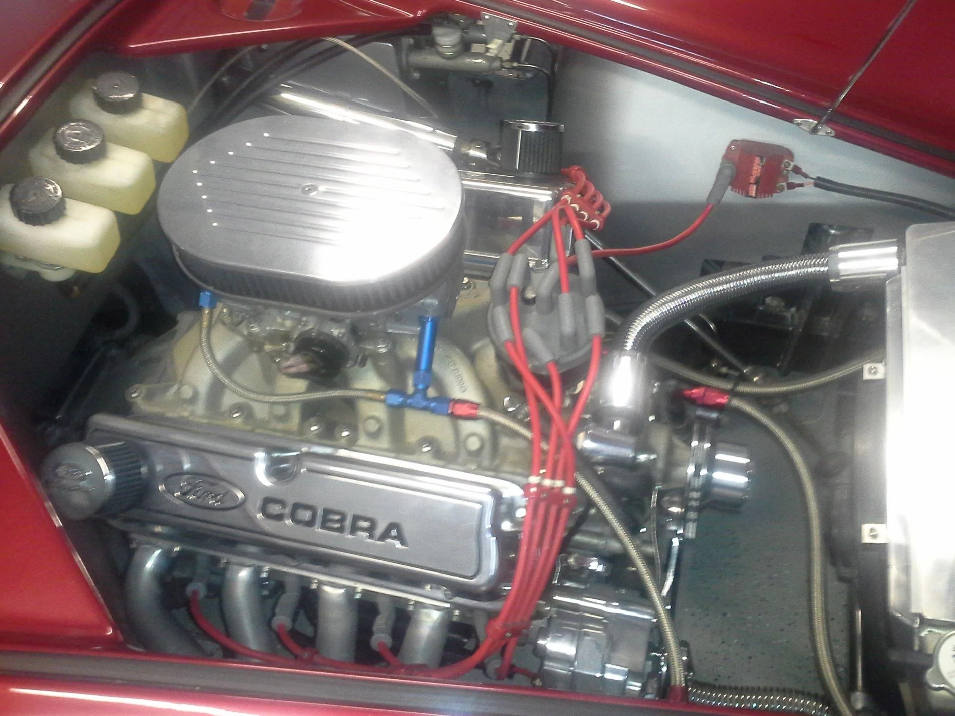

If you ever see a Cobra on the street, 99.9% of the time its a replica. Engine is 393sbf, NA, 480hp. Car weights 2,500lbs.

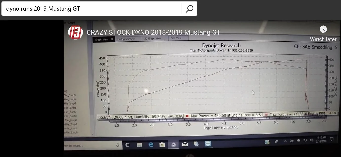

Thanks for all the smart ass advise. I guess the issue is either I don't know how the modes of this car work, or the car is a little soft on takeoff. Seems to me with 460hp, this car should leave harder. But then what do i know.
I found what claims to be a stock dyno test.
HP up around 7000 rpm is irrelevant here, when you're first laying into the throttle at something like 2000 rpm. Notice here that the torque curve is pretty soft below about 2300 rpm. I have no idea how much help you're supposed to be getting from the 10R80's torque converter stall ratio, whether you're getting all of it, or if there's any brief bit of torque management going on. Anyway, at 2000 rpm it's only putting out about 230 ft*lbs (Torque scale is on the right and doesn't match the HP scale). That's only a little more than half of the advertised peak torque number . . .

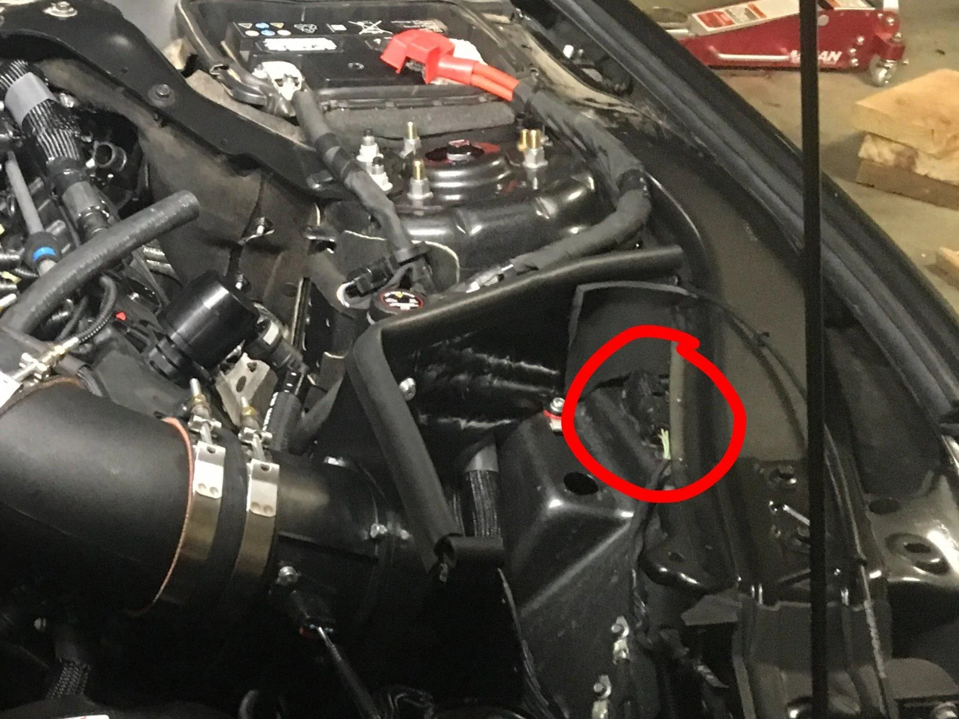

This is the plug in question.
The plug has two wires coming from the loom on one end and the other end also has two wires that are simply bridged together. Disconnecting the plug removes that bridge.
It’s unplugged when the car is on the dyno so that the rear wheels can rotate whilst the fronts are static, without the TC freaking out.
You’re basically preventing the car from seeing the difference in wheelspeeds, ergo, you can drift and skid to your hearts content without the computer intervening.
Pros: the car won’t try and save you
Cons: the car won’t try and save you.
Thanks for the info, I've disconnected it and will see if the car acts any different with it un-plugged versus just shutting of the AdvanceTrac with the dash button.
I'd be very interested to see if it disables torque reduction, giving slightly more power.

The difference with the nanny plug undone should be dramatic. It takes very little effort for me to feel my car's tail stepping out if I pull around a corner a little too hard. Had it unplugged for the dyno today and leaving the facility it was getting a little squirrely.
