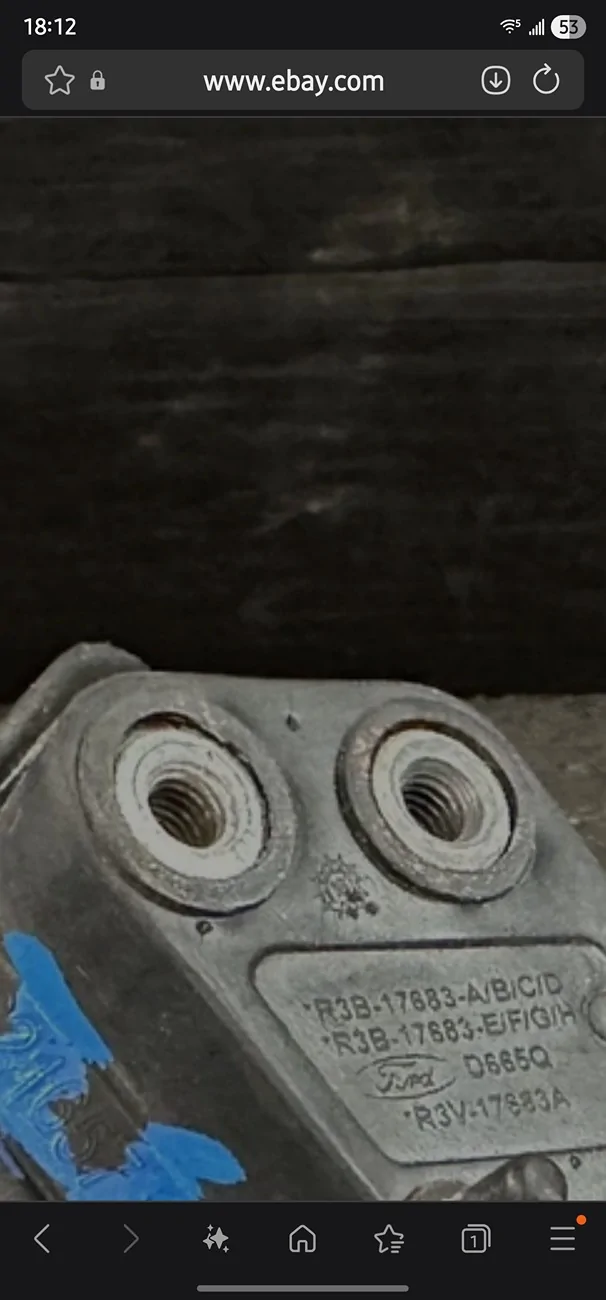

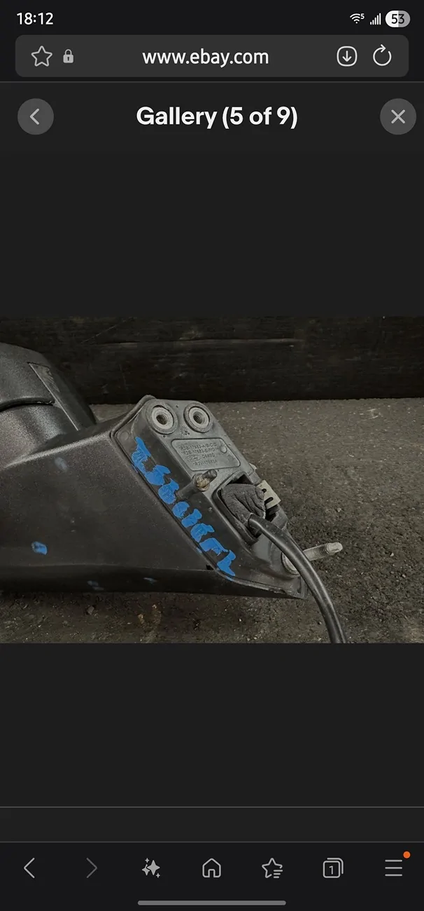

I found these photos online of what it looks like, very odd for melt in nuts and I'm not sure they can be remelted or resecured? Some images online also show them surrounded by rubber and some are all silver
Those look to be actual rivnuts. I suspect that the rivnuts are attached to a metal backing plate and the plastic is molded around them. When you get the mirrors off I would still try the rivnut install tool to see if you can tighten them up.
