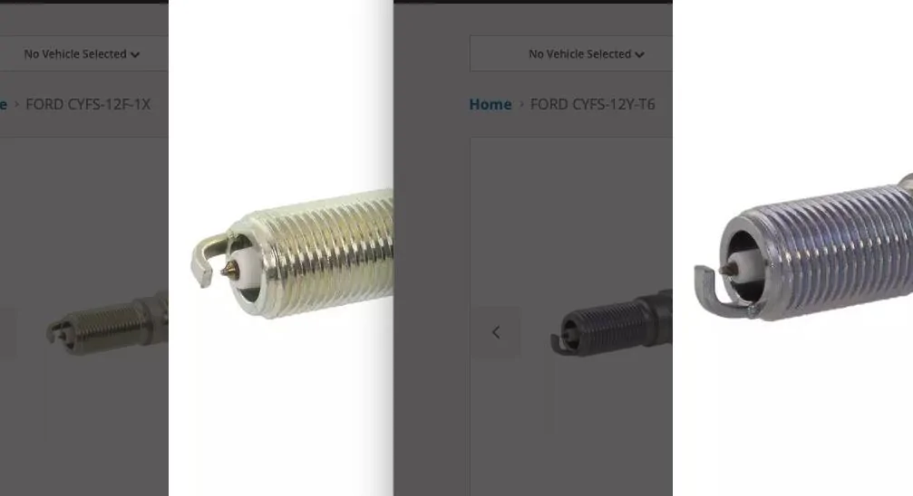

On the sparkplug subject - what's the difference between SP-548 and SP-589 ?
2018 Manual shows SP-548 (and that's what I installed), OP mustang shows 548 for 2011-2017 and 589 for 2018+.
Insulator looks bigger on one
parts.ford.com says
  • Ford Mustang 2011 - 2024
For the 589
Probably one replaced the other in the parts catalog
