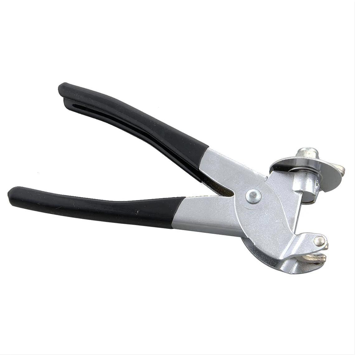

I’ve always owned highly modified cars. So plugs get changed more. Buy the right tool for the job. It’s not like tools go bad. It’s basically a one time purchase that you’ll use for the next 30 years. I bought this from summit racing 20 years ago for like $20. Still use it regularly.

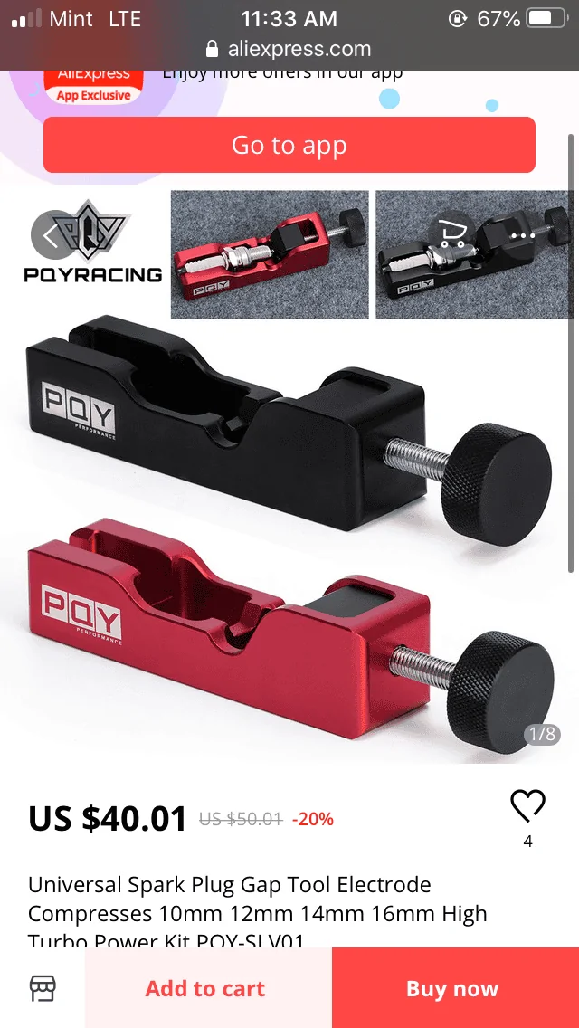

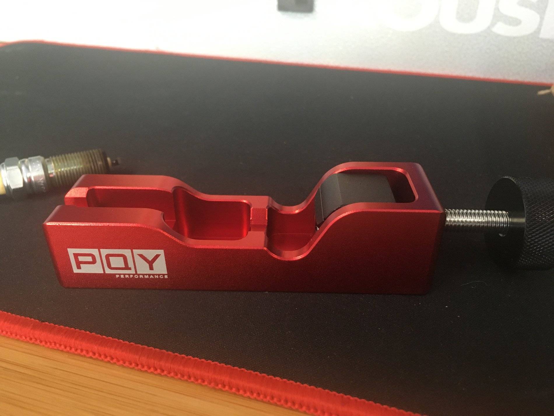

Since everyone agrees overpriced for what it was
Found the same exact item on AliExpress for 40 bucks. Just different brand name on it. The new one is called pqy racing I think. Same color and everything. Slightly diffeeent knob.
For 40, I will gamble it. It’s the universal one for all different size plugs. Hope works decent enough.
I just saw this post, I ordered the China one yesterday.
If this one sucks I will but the one you posted.

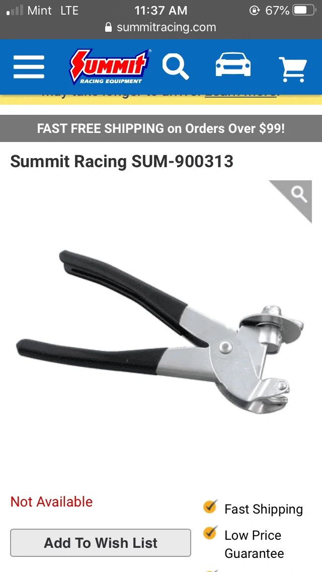

Edit I actually saw this plug gapper on summit but the websites all showed it unavailable for purchase

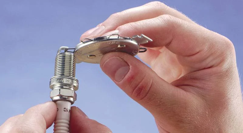

I use a wire gauge now but used to use feeler gauges for gap setting. I learned on older cars that had points and a condenser. Even learned back then that you must have the ignition off before checking the points gap...

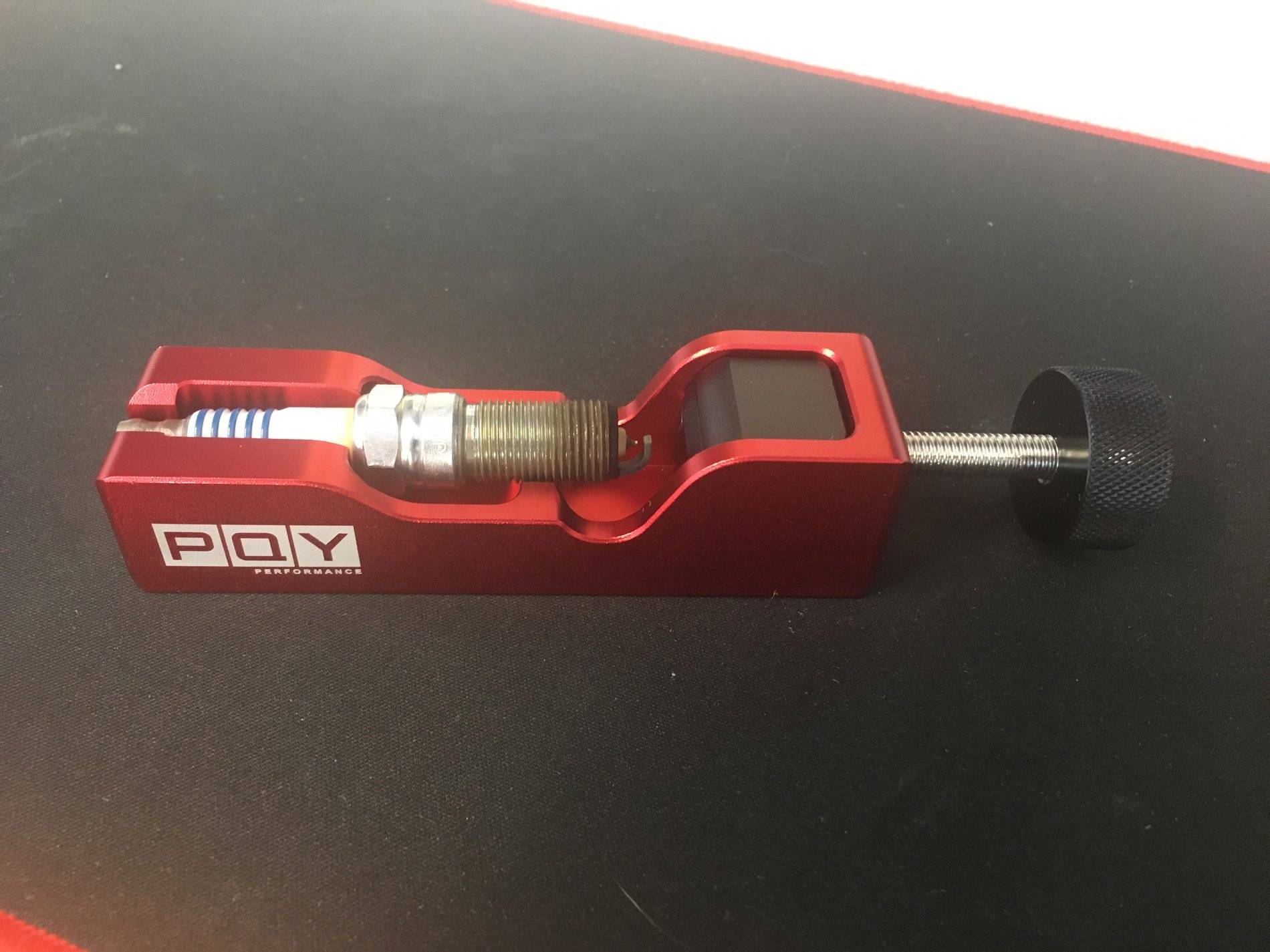

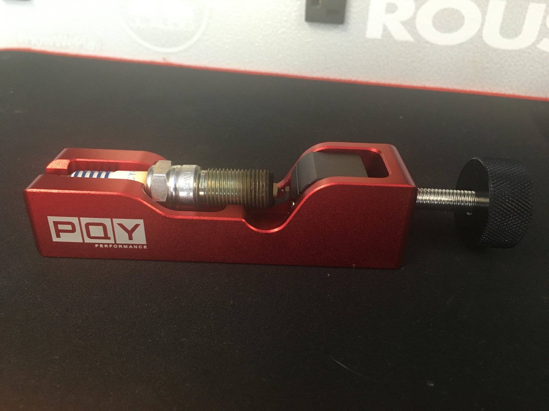

forgot to update this, I received it awhile back, and since I had it. I went crazy.
changed a sonic, scion, mustang, harley spark plugs. I use the little wire gapped tool, to extend a gap out, but if a gap needed lowered, I used this little tool. didn't fret a bit. at 40 bucks, whatever. it already paid itself off. gapped all my rutheniums effortlessly. just small little turns, checking each time and making a small turn til im at the desired gap.
all my vehicles are running better than ever! I even tossed amsoil oil and amsoil filters and all new engine filters or cleaned them all. was fun.

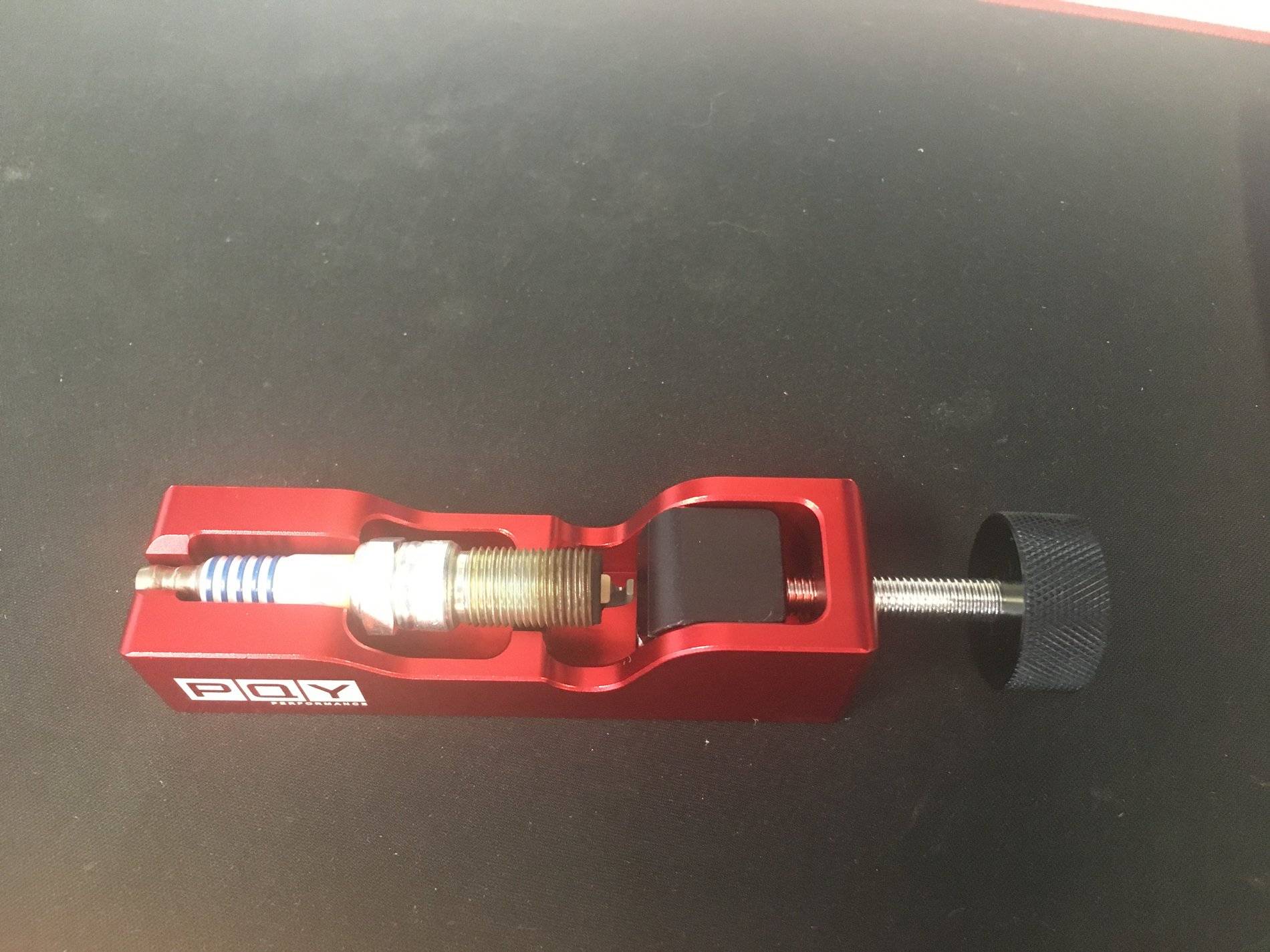

Just tossed old plug in it and playing around for photos for ya
Mach VII
Mar 22, 2017
1,165
2,672
Berkshire Hills, MA
John
2019 Mustang GT 401A, 1989 Lincoln Mk VII LSC
Hmmm that tool only closes gap or am I missing something?
