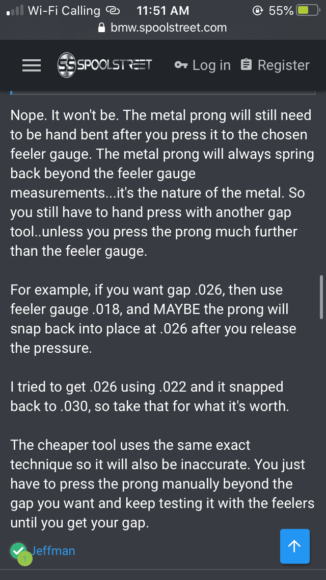

read a review for example he bought .032 plugs, he said to gap them at .025 and it will become .028 after bounce back. are you supposed to do them that way or just gap them to .028 and leave it? the video shows you stick a little metal feeler gauge, and then push the gapped down to clamp to the desired gap.

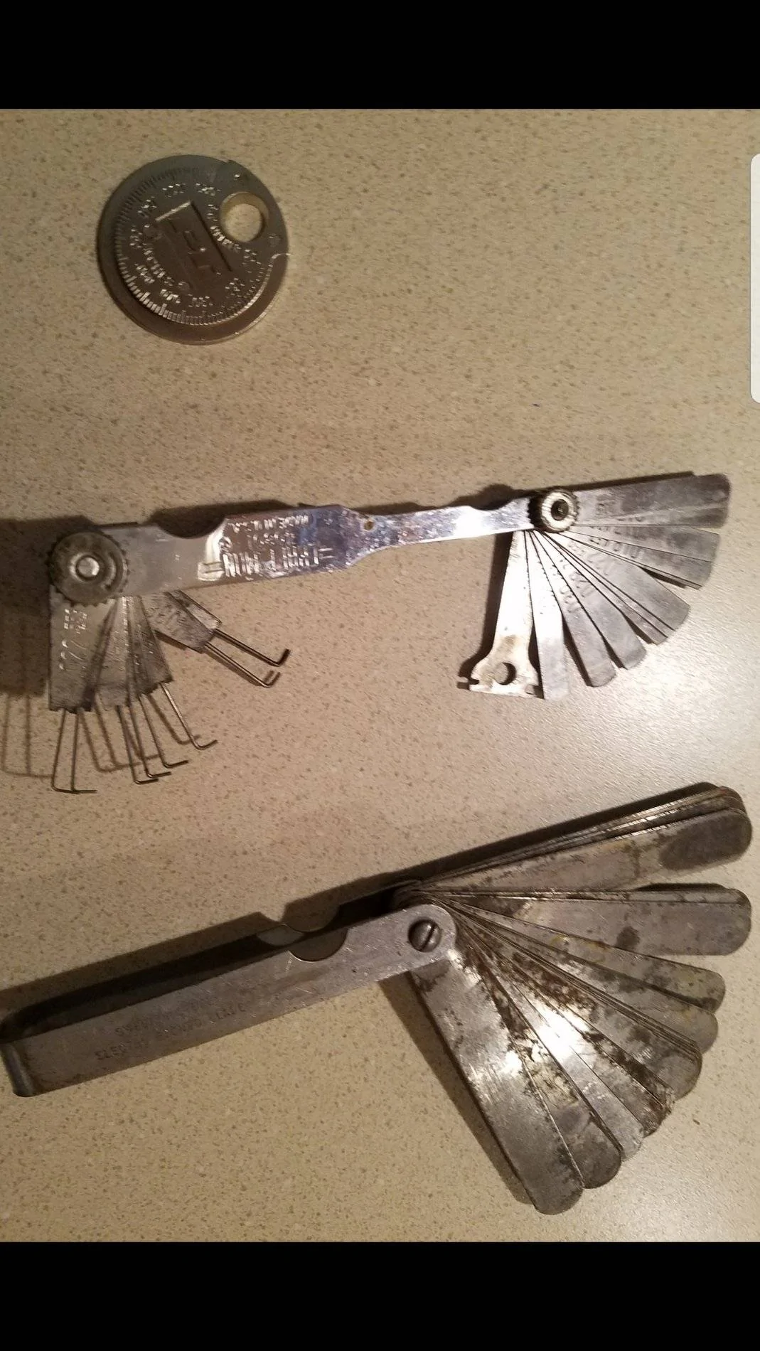

Theses are the tools I've collected over the years.
The middle on is my favorite.
The circular one is really inexpensive, like a dollar or two, and sometimes free at auto parts stores. It works just fine too.
The bottom is simply a set of feeler gauges. You have to bend with another tool.
Two notes,
1, most spark plugs I've bought lately have come pre gapped. I've checked them and not had to adjust at all.
2, newer spark plugs sometimes (often?) have a coated electrode and you need to be very careful not to scratch that coating while gapping them.
Two notes,
Two notes,

I’ve had all those gapping tools for many years as well. I always come back to the circular ramped disc gapper, just very easy to use and never an issue.

Do not even follow the “Spoolstreet” response you posted above... someone there is on the ganja or crack... I’ve never heard of anyone closing the spark gap, then gapping a plug at .018 and the electrode magically bounces back to .026... makes no damn sense at all. That person does not know how to either read or properly use a spark plug gapping tool. LMAO!!

He’s saying if you put a gauge in the gap of the right thickness and then smack it the spark plug to close the gap, the spark plug it will bounce back a little. Makes sense to me.
normally I think what we do is close the gap a bit too much and then open it, thats probably the normal procedure?
