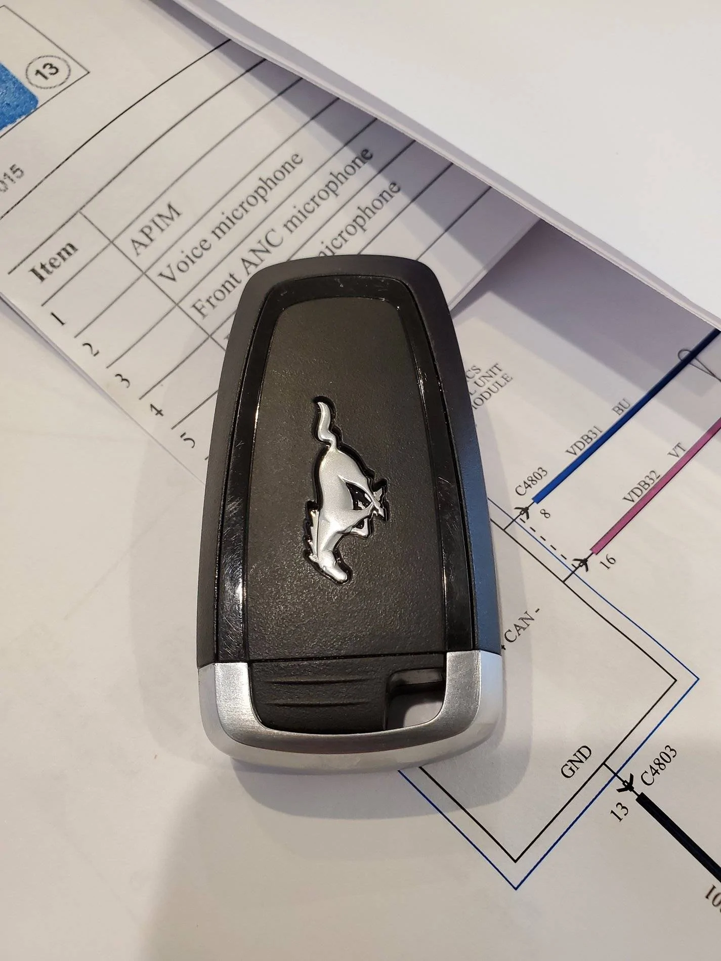

I just received mine. Very good condition. Not 100% new condition, but for a used key, it's pretty good!
Its a shame I don't have a car to program it to.
If it will program, I will be perfectly happy.

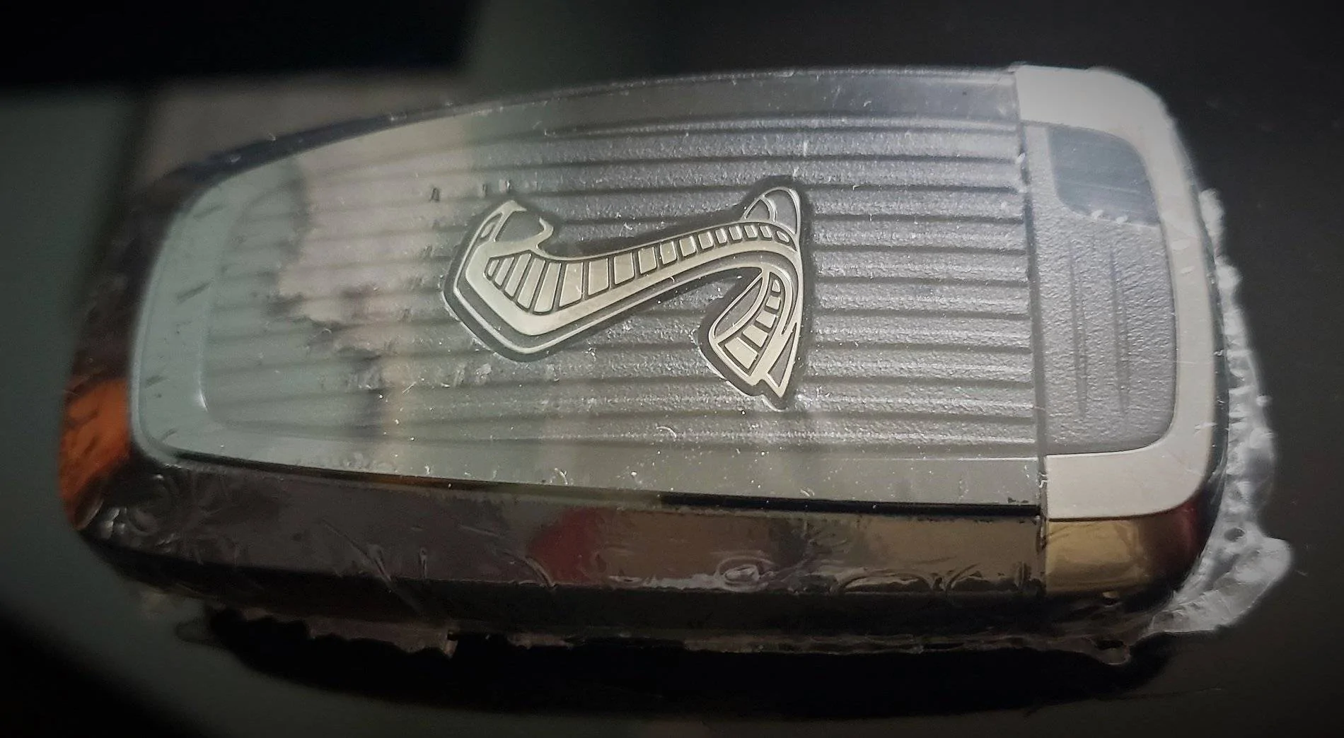

I know most of you are looking for an extra fob to put in service while storing the originals, makes good sense.
But for those who are looking to protect what you are currently using, shrink wrap is an option that works for me.

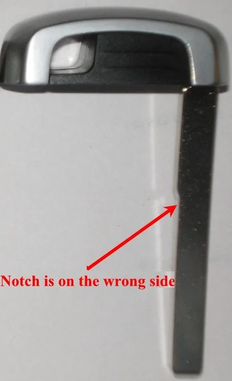

The emergency key was the wrong one, the notch was on the wrong side of the key. I am waiting to hear back from the seller.
Here is what it is suppose to look like.

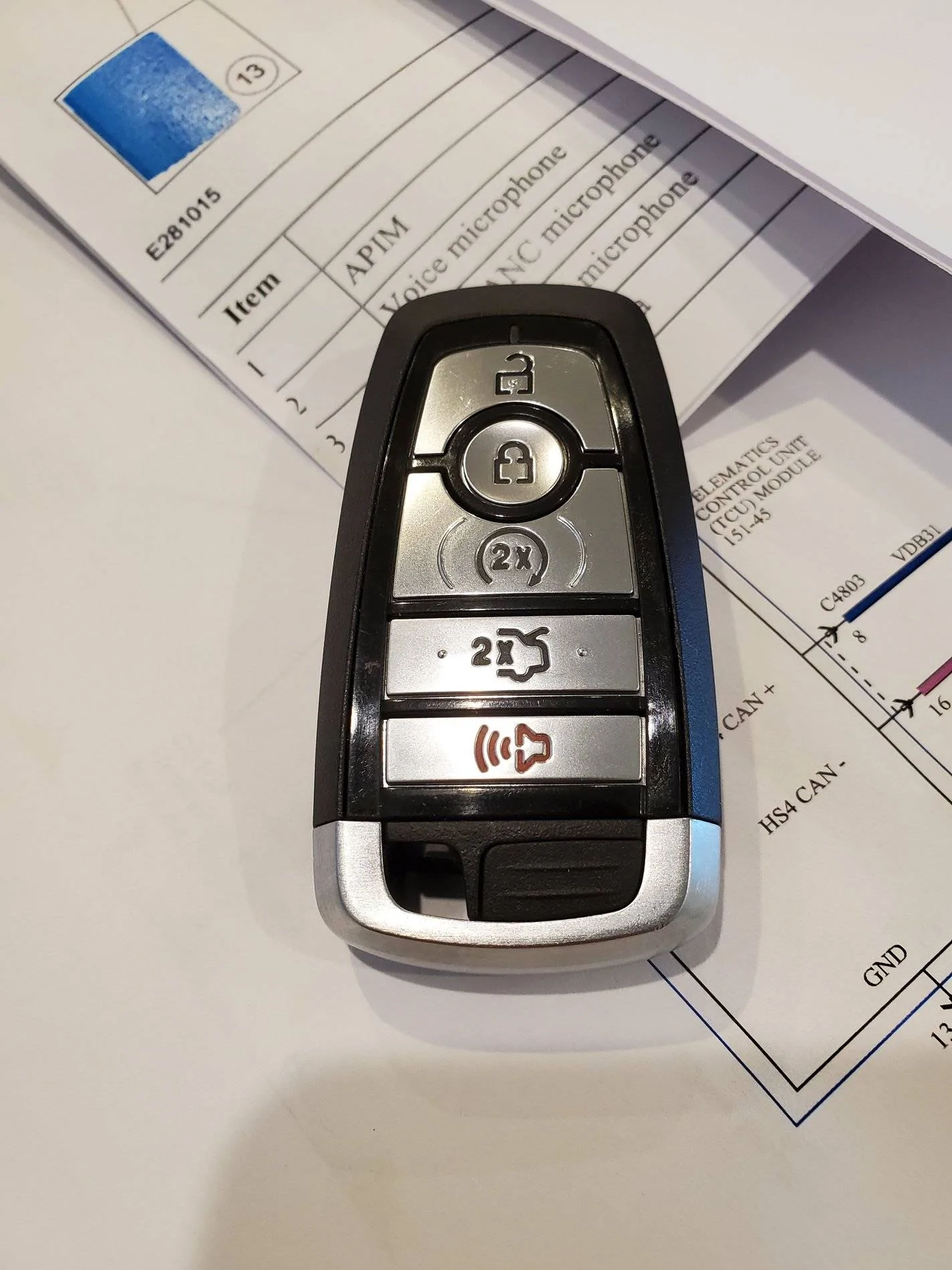

This is what the new one looks like.
