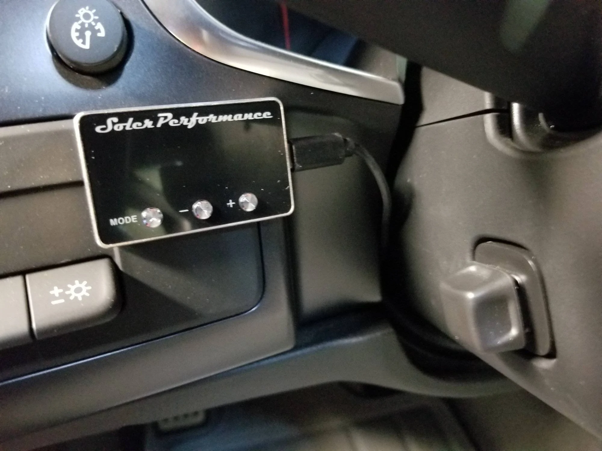

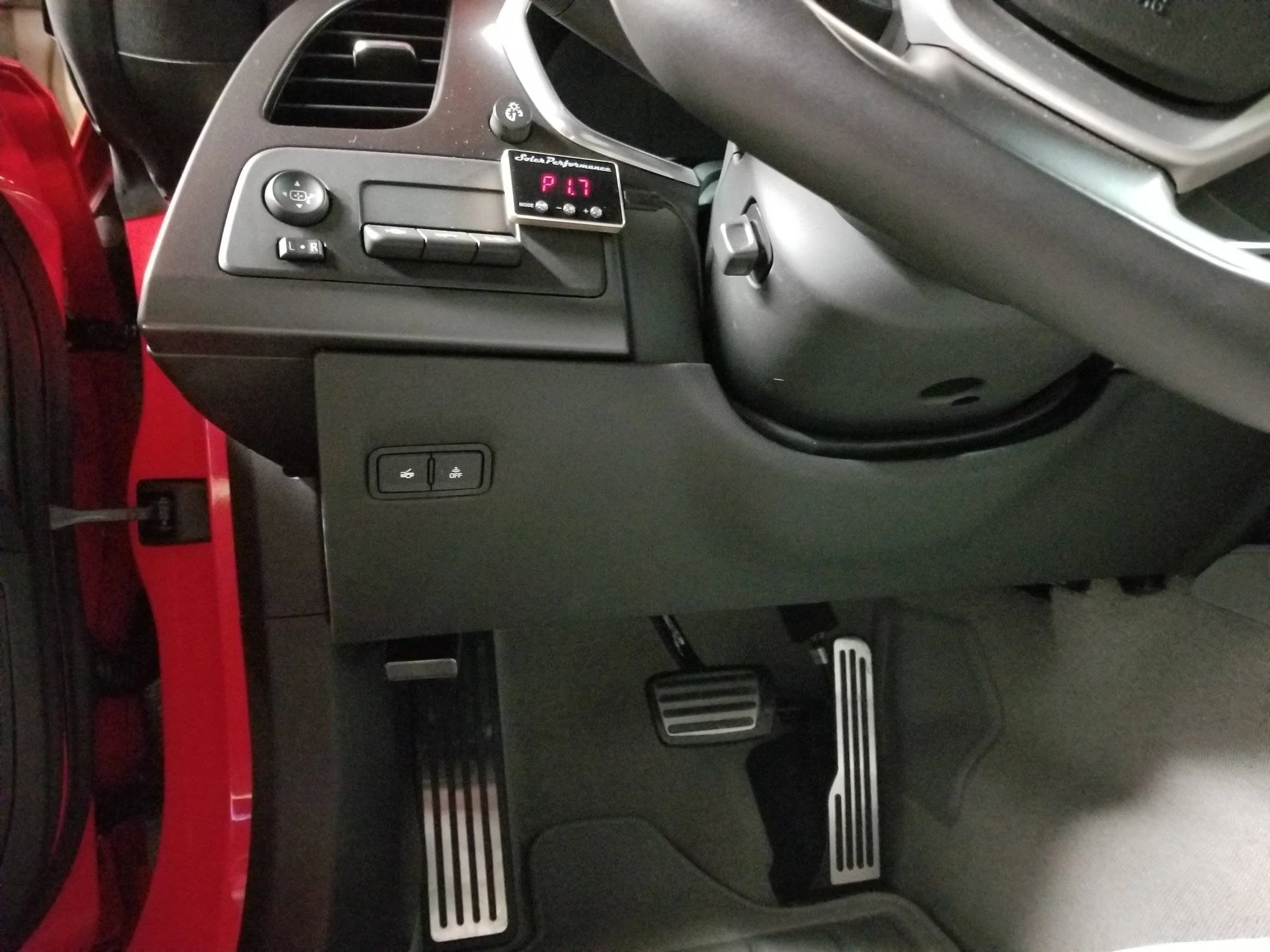

Again well documented and pretty simple. At first I mounted the display too low, and couldn't see it while driving. I rerouted the cable and attached the display just to the right of the HUD buttons.
Mounted too low. Couldn't see display while driving.

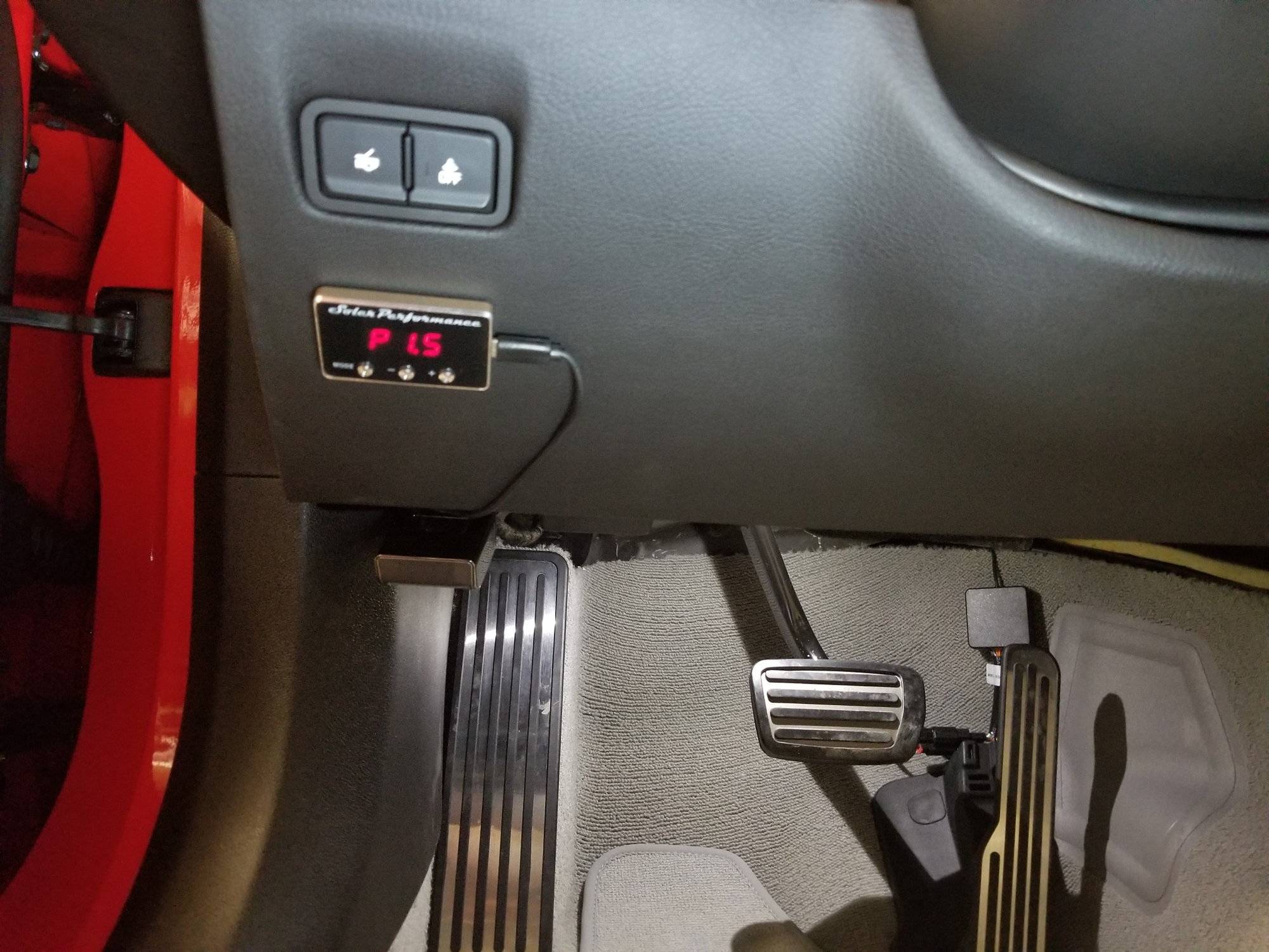

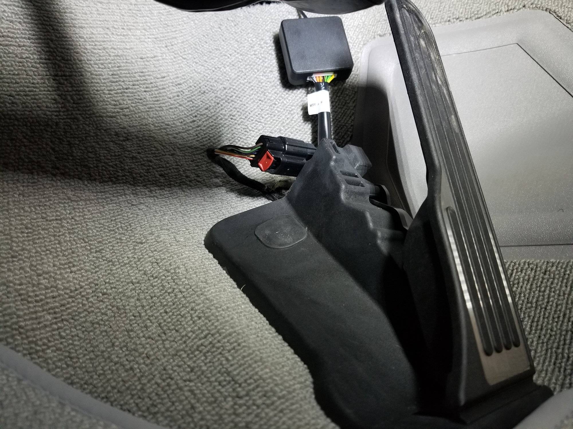

Remounted display. I fished the cable thru a small opening left of the steering column.
Completed installation.
The TC really compliments the performance of the TB. The off idle response now is incredible, much, much smoother. Acceleration now seems quicker, lots more fun.
