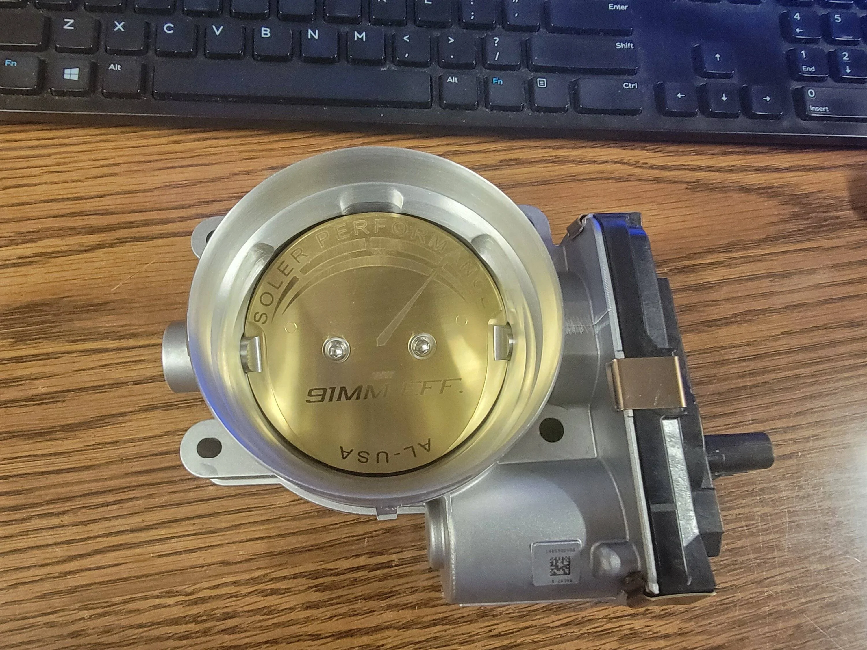

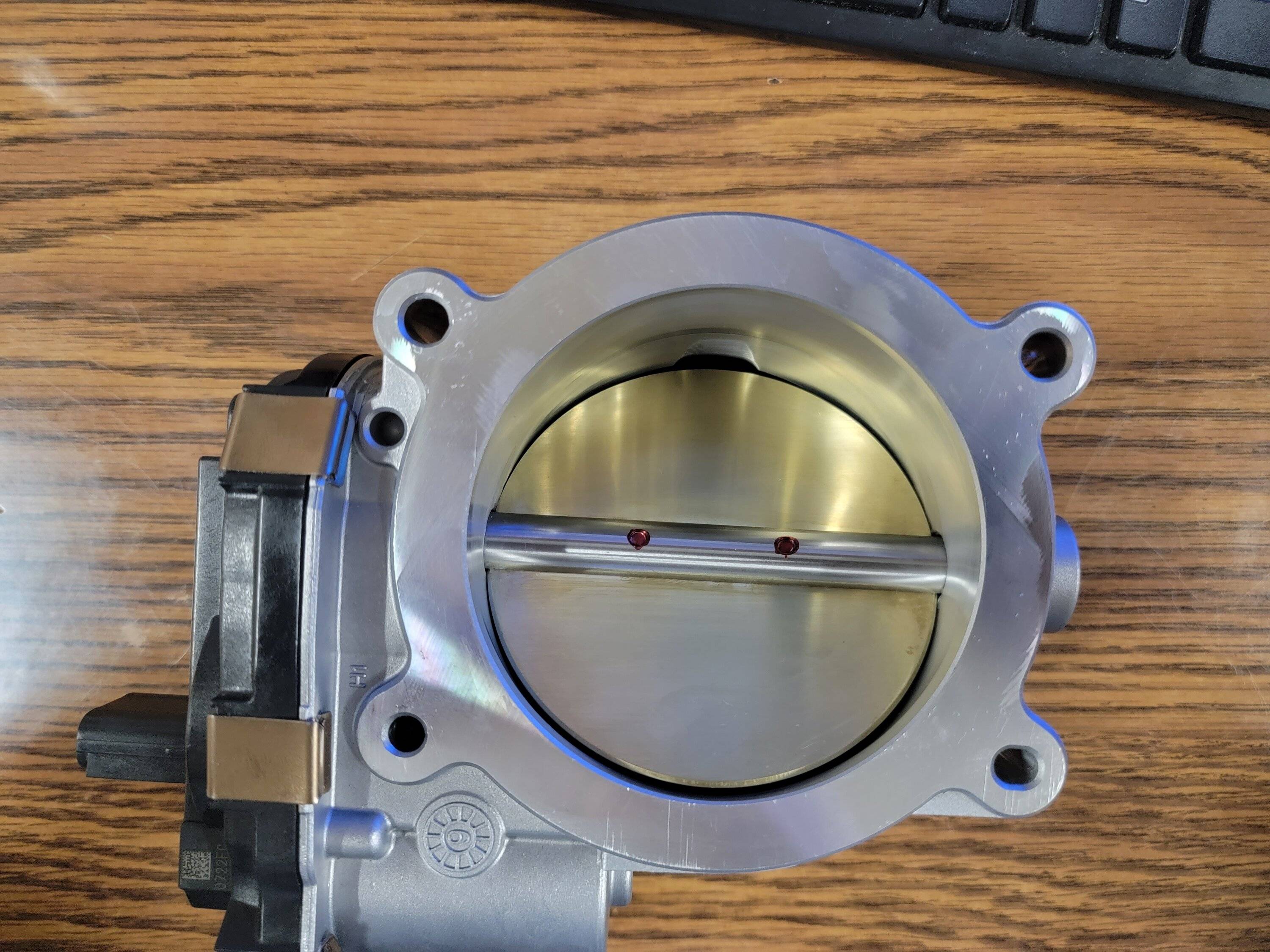

I shipped my throttle body out on the 22nd. It arrived at Soler on the 27th, and I just got it back today. The workmanship is extremely high quality and I cant wait to install it with my GT350 manifold!
Let’s see some pics of it. I’m curious to see if they finally started adding dimples to the blade bar.
No dimples on the blade. I belive they said earlier in the thread that it can't be done on OEM TB's. Also my TB only has 1 notch as opposed to 3. Not sure why. There is abundance of red loctite on the blade screws which I am very pleased about. Dont need one of them backing out.

I emailed Soler about the 1 notch vs 3 notches and Mike said it was a design change so you don't lose as much engine braking.
I just looked at so e old pics and mine has three notches. The logo on mine is also black in color. Other than that, they look the same.
