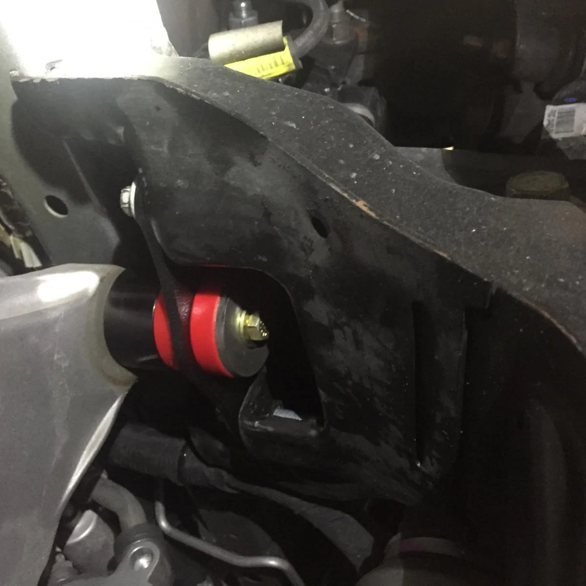

The SEMA crunch is here and I finally got some time between tuning and data logging, to install the BMR motor mounts, that allowed me to lower the Coyote.5 inches. The blower install only added 32 lbs but it is all up top, so lowering the motor will lower the CG and hopefully offset some of the weight. Big thanks to [MENTION=9985]BMR Tech[/MENTION] for the great product. Install on a 4 post lift was fairly easy and the added NVH is negligible given the rest of Project 6Gs mods!

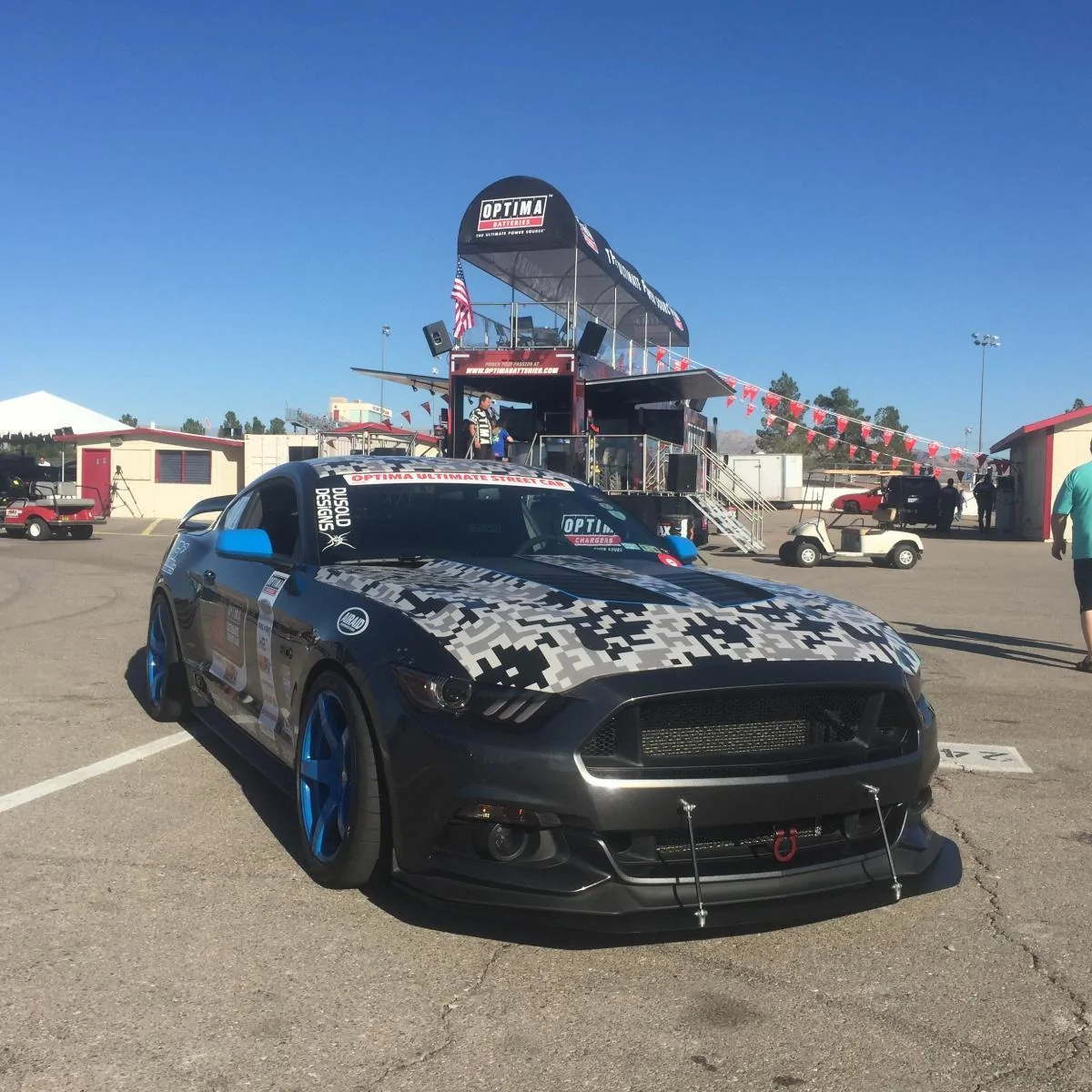

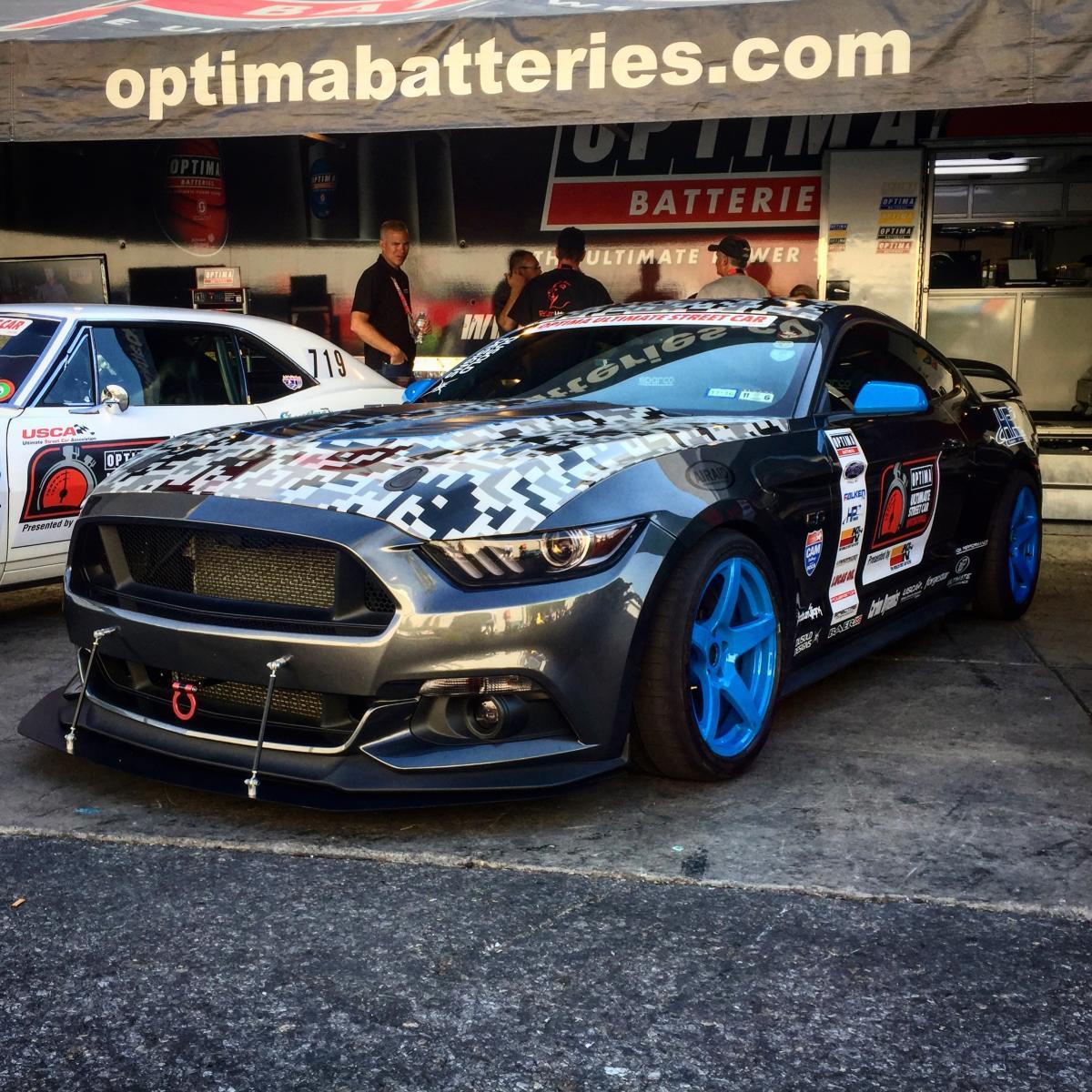

SEMA 2016
The car is posted up in Optima Alley for the week and the. It's off to LVMS for twos days at racing! It's going to be a fun week!

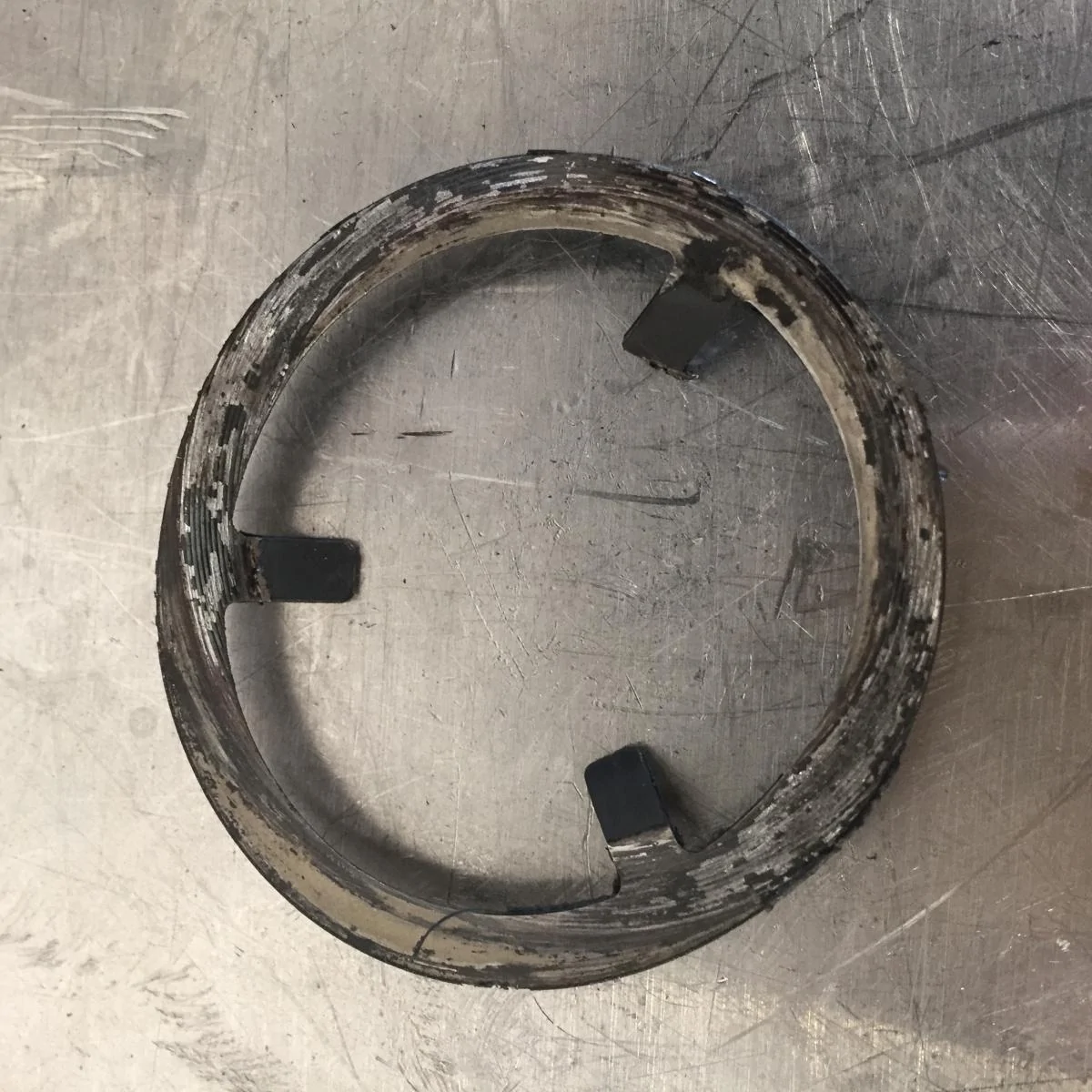

It turns out the Torsen was fine! We were chasing two problems that just happened to occurre at the same time. The ABS problem was caused by a "egged out" axle spacer, that allowed the axlento move just enough to freak out the ABS sensor. The noise in the rear end was actually coming from the Driveshaft adapter. A new axle and a little maintenance and we are back in business winning races!

Glad to hear you're back at it. Any idea what would cause that?
Sock
Gold Sponsor
Jul 16, 2014
536
233
Frisco, TX
www.facebook.com
Aaron
2015 GT 6spd PP Magnetic
I can only assume it was repeated lateral loads we were putting on it. I would keep an eye on axle nuts to make sure they stay tight. Other then that, I don't really have any ideas, this car has seen a lot of track and Autox miles!

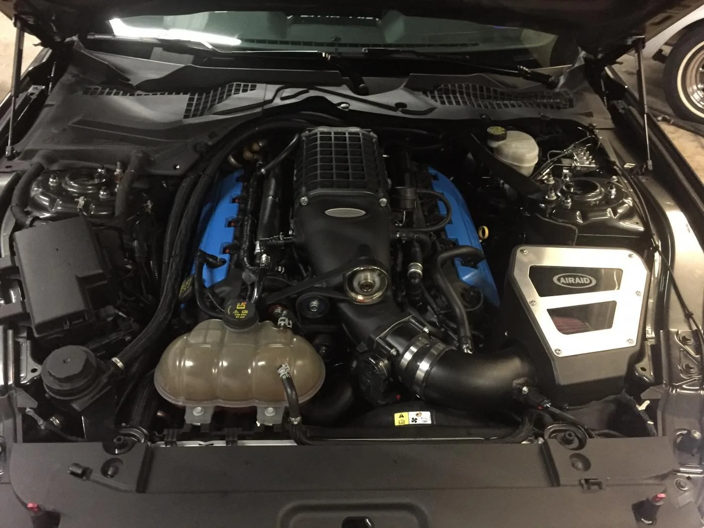

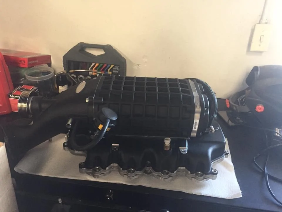

Magnuson Supercharger
In addition to the repairs we made, the Magnuson Supercharger is back on the car and ready for some more track tuning!

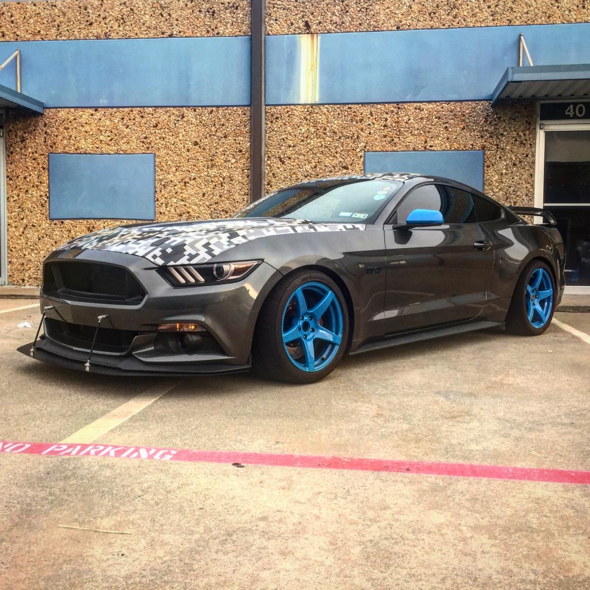

Sticker-less
Project 6G is stickerless and ready for big changes for next season. Who wants to be a part of the 2017 season...we will see! #dusolddesigns #project6g #ridetech #hptuners #BMR #forgestar #bfgrivals #baer #sparco #*********** #vorshlag #magnusonsuperchargers #Gloc_brakes
