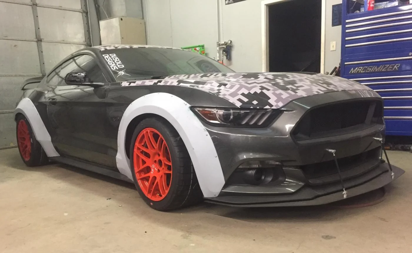

they're definitely "stretched", but not hella flush caliber :lol:
yes, fit over PP brakes. haven't taken the car for a test drive to confirm full loaded fitment (very tight tolerances both inboard and outboard under the stock-ish fenders, both front and rear), because it's been uncharacteristically cold around here the past few weeks, and doesn't look to be letting up anytime soon. stay tuned.
glad to see you finally with appropriately sized wheels/tires though (especially with all that extra power you have now!), you'll be able to tell the difference right away :thumbsup:
When your other shop car is a 1100 RWHP tube chassis 67 Camaro on 335s...I kinda didn't have a choice! :)

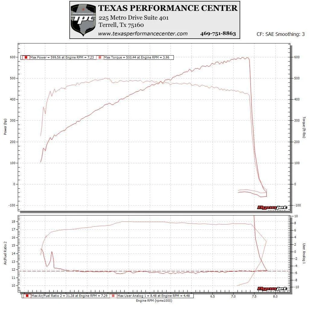

Dialed in!
I forgot to post my dyno graph after I got the Supercharger back on and dialed in. It is ready for some track testing

I forgot to post my synopsis graph after I got the Supercharger back on and dialed in. It is ready for some track testing now!
One question, is it normal to run the car that lean on supercharged? I've never had SC before but had turbo cars and they usually run a little bit more rich. is it because of the low level of boost? Sorry for the dumb question..
It is not lean at all. It is on the money. 11.5-12 to 1 is right where you want to be.

Powers still going up, so why did you shut down at 7200 rpm?

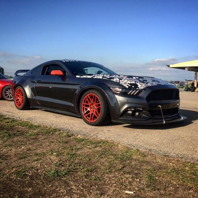

18x12s with BFG Rivals 335/30-18 Squared!
Well since we added power for next season...we need to add grip! Not a huge fan of flares on these cars but it was the only way to get the 18x12 Forgestar F14s wrapped in 335 BFG Rivals, on the car. I still have some modifying and prep to do on the flares before they are ready for the factory color, but the wheels and tires are on and ready to test!

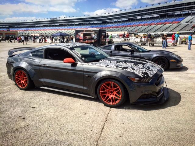

SCCA Track Night in America
Out playing with my friends at MSR Cresson for TNiA. I have been tweaking the tune to get the pedal more linear with the Magnuson Supercharger, and it is a monster on track now.
