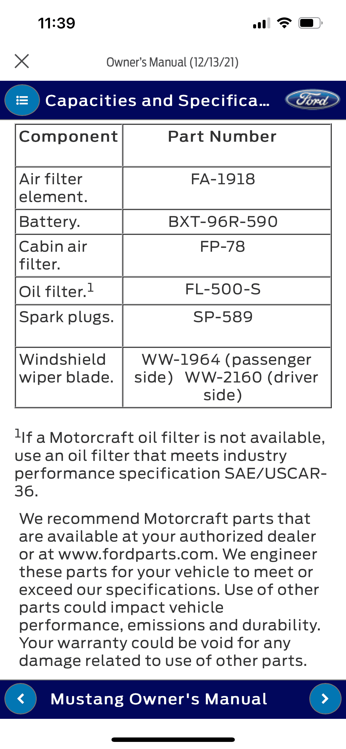

OEM;
But you have to order them with the specific Ford part number. If you just walk into a dealership, they'll give you Ford branded generic-fit blades, and that's not what you want.
I order them off Amazon.com, and keep a spare set back.
